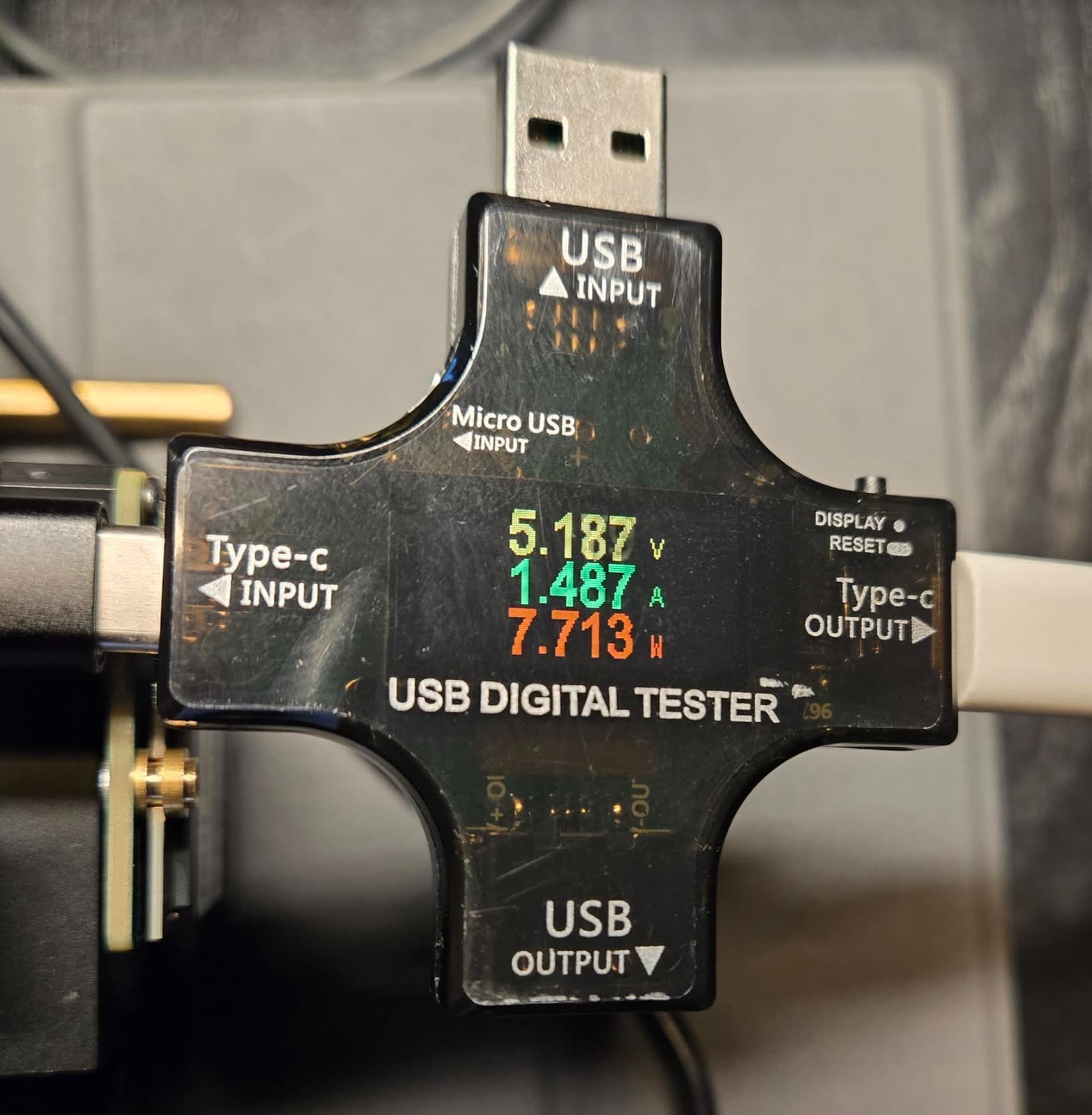

I’m thinking about doing a PSU like the OP (actually my engineer brother will do it for me) but with my Pi5 fully loaded and running Volumio it’s pulling this:
That seems quite low. 1.487 amps for the dac and a pie 5. Do you have a screen connected as well?
I don’t know if I would trust those numbers to be accurate.

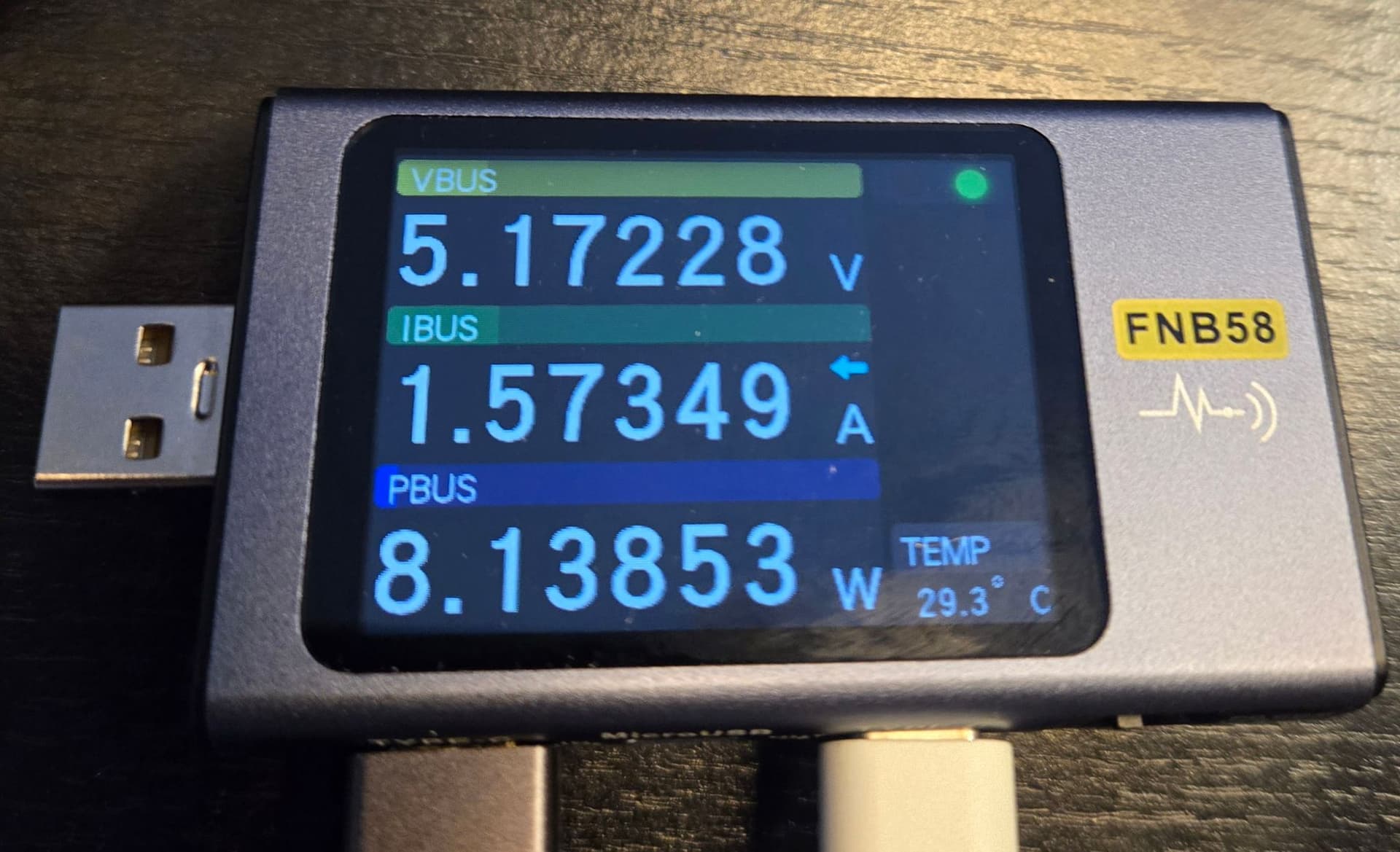

So I ordered a “better” tool just to see what the readings would be:
Some differences - using this one the Watts did jump to around 11 at boot but once settled and running they’re all pretty much the same, which begs the question:
Am I doing something completely wrong or is the “official” Pi 5 PSU total overkill for a situation like this?
