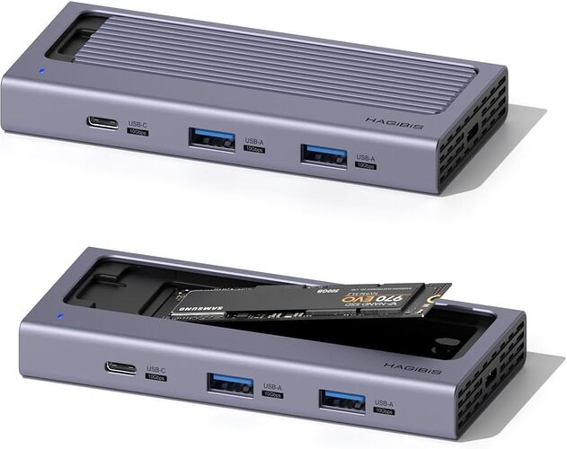

Think this might do the trick?
You may need a USB-A to USB-C converter cable to connect your RPi to this hub. This might limit throughput of the M.2 drive but will enble you to connect via USB-A or USB-C to your DAC (whichever it needs).
And be sure, if you need to order this cable USBA → USBC, you pick a data cable not a charging cable…
