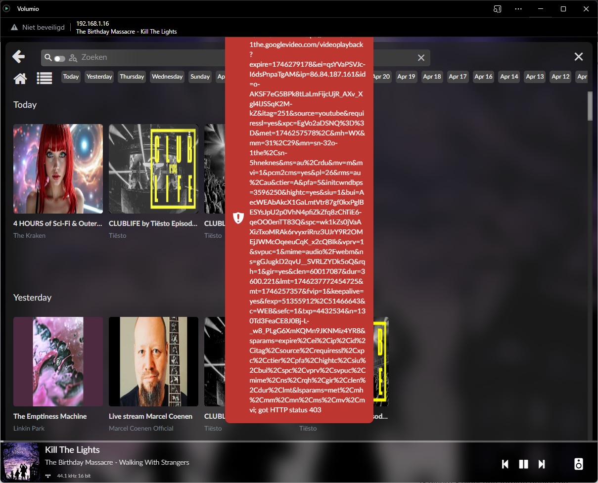

Unfortunately, regardless of the update to the Bookworm version,
I experience the same error as before:
With this Error when I try playback:
Which version of Volumio did you install? Check in Menu → System.

The latest working version is for Bookworm-based Volumio only. You are still on Buster-based.
uhm im on 3,812
That’s Buster-based. Here’s Bookworm
