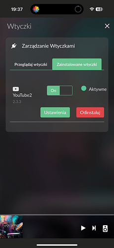

YouTube 2 plugin 2.3.3 with cookie but plugin setting is empty !

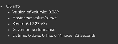

Hi, I guess you can’t have everything :wink: I have the same problem with the YouTube plugin. I’m using a Raspberry Pi 4 with version 3.812 and also getting the “failed to decode” error. I’ve now installed version 0.069, which I didn’t know before :wink: There, YouTube playback works and version 2.3.3 is installed. In version 3.812, the plugin overview still shows 2.33, but actually 1.42 gets installed :slight_smile: That might be the reason playback doesn’t work. In 0.069, however, the internet radio is very limited. Sure, I can add stations manually, but genres and countries are not available. But that’s a topic for another time :slight_smile: I think the last version still worked, but I’m not entirely sure anymore.
and you are running YouTube 2 (version 2.3.3)
Raspberry version 0.069 ?

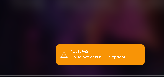

what am I doing wrong when entering cookie setting is empty
“Could not obtain i18n options”

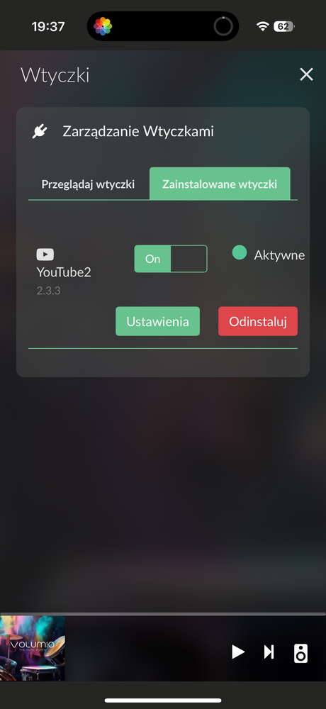

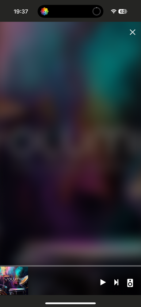

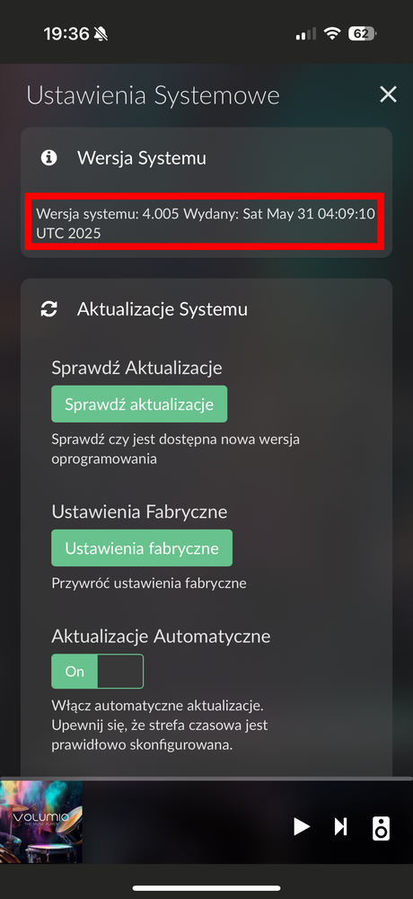

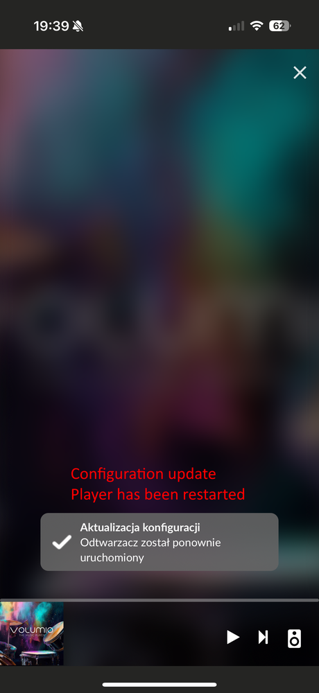

Guys, I have blank settings page of Youtube2 plugin! I’ve tried Volumio 3.x, 0.69, 4.005 and always the same story! What is wrong?! I’ve also tried dev mode, restarting after plugin installation, different SD card and nothing works… Every other plugin I’ve installed works just fine.
Where I can find some useful log file?

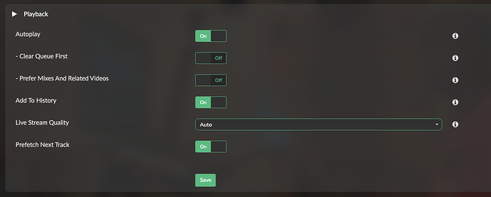

I’m not sure if it’s my settings, but it does not seem like the autoplay works automatically. I only get the “fetching more items…” if I click on the next track icon while playing the last song in playlist.

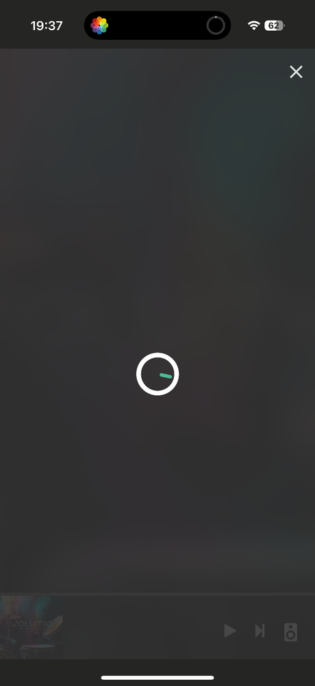

Does the youtube2 plugin no longer work?
I can see the playlist but the play button does not appear.
Same here, Volumio 3.832
I can search but no playback on clic.
You may need to update to 4.xxx version to get the latest plugin. I tested it worked on 4.020
Confermo. Ho installato la beta 4.021 con il plugin Youtube2 e funziona correttamente. Grazie
I confirm. I installed beta 4.021 with the Youtube2 plugin and it works correctly.
