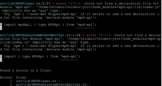

i had to run npm audit fix --force for youtube cast.
youtube2 worked finally after did a clean install.
youtube cast still blank page
thats the errors that i saw on the installation…

For YouTube Cast Receiver, the RangeError is a Volumio issue that can be worked around as follows:
// Start from scratch since you did "npm audit --force"
$ cd ~/
$ rm -rf volumio-ytcr
$ git clone https://github.com/patrickkfkan/volumio-ytcr.git
$ cd volumio-ytcr
$ npm i
$ npm run build
// Important to avoid RangeError
$ rm -rf node_modules
$ volumio plugin update
