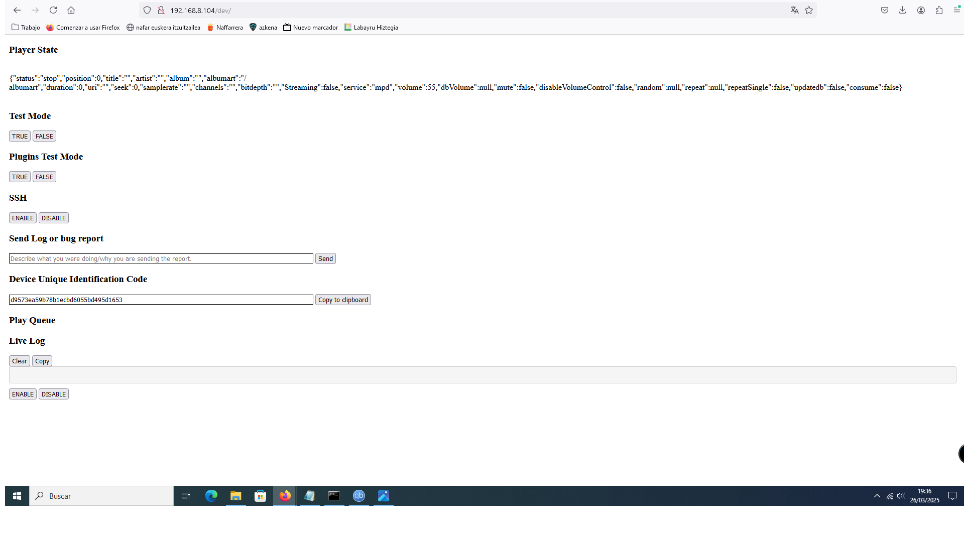

Hello. Iām a beginner so

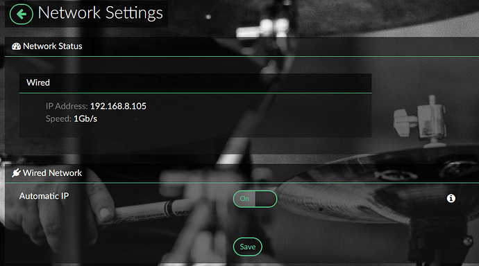

Can I do that via wifi, or only with ethernet wire?
How can I get IP address of my Raspberry?

goto:
<ip-address-of-ypur-device>/dev
Enable plugin test mode:
I did it. But nothing happens.
That“s my IP address
Do I have to set ssh options in my raspberry pi 3 b+?
Click this link. What do you get?
I changed to the last volumio version.
IP address now is 192.168.8.104
And finally is working.
And think now IĀ“ve to enable easily āPlugins Test Mode"

In the Live Log screen, I can see changes running.
Something I can change?
