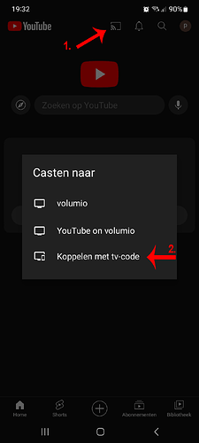

@gvida it just works connect it true tv couple code. it’s running on my samsung s20 /
volumio 3.512
Youtube Cast Reciever 1.04
After opening YT app
first connect the phone with YTCR, pick connect with Tv code
after that select what you wanna play
enjoy.
binding with wlan and use manual pairing and use Tv couple code
don’t forget to save binding
( it could be that you need to be logged into your google account mine is on the phone. )

Why do I associate a tv code, as I do not use TV but only my mobile on which I have a concert I would like to play on Volumio ?
something not clear with me on the use of this code. May be this is stupid

tv code is just a couple code to a device something like a handshake.
