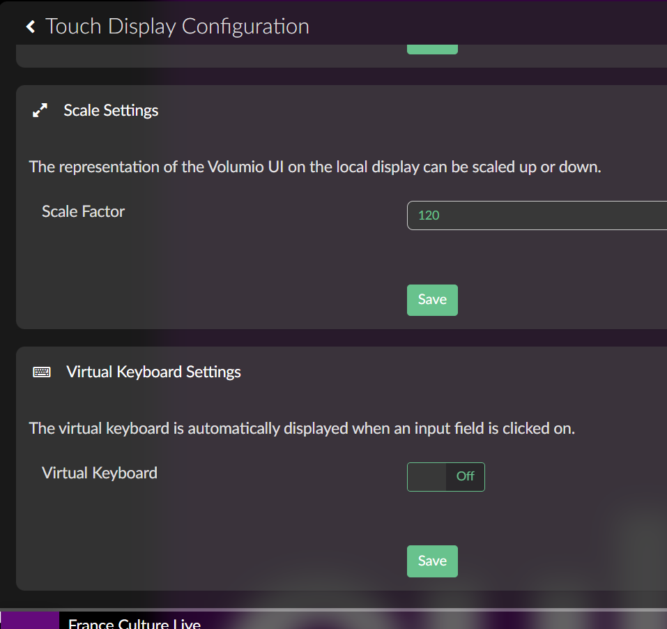

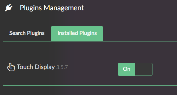

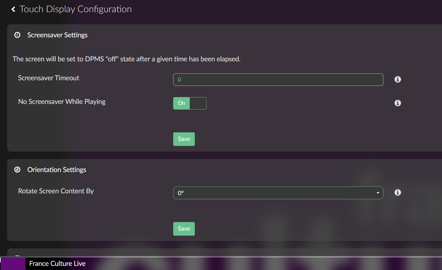

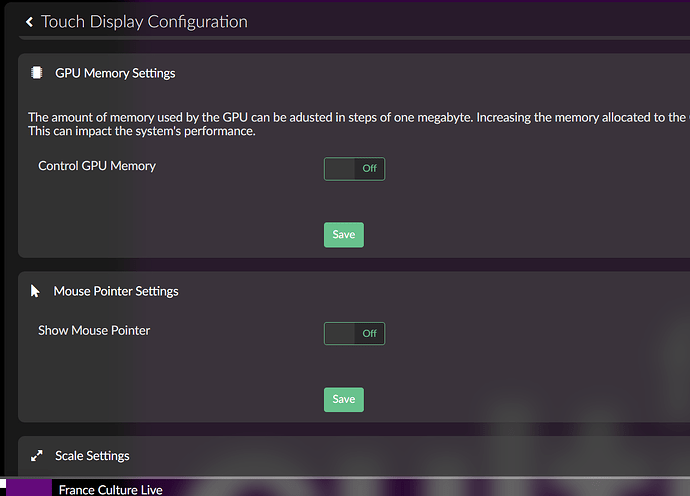

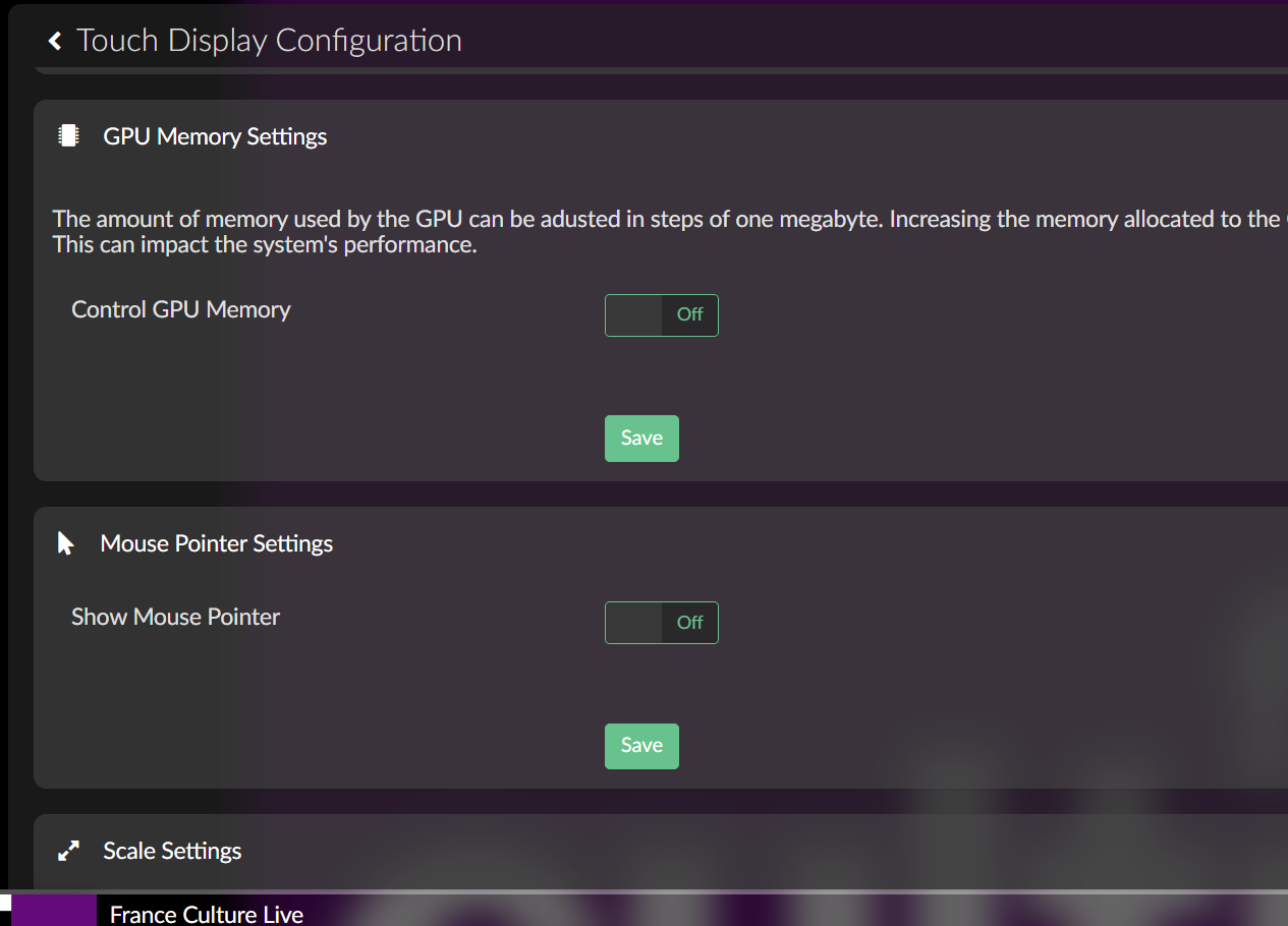

A note for clarity. The issue I reported here on this thread is from testing on my Pi4 using both HDMI out. Whereas, what I posted on the beta thread were observations from my Pi5, using DSI for touchscreen and audio out via GPIO to HAT’s.
Hey @RedEyeNinja,
The beta 3.5.8 is out for testing.
On the Pi4, I have uninstalled 3.5.7 rebooted and installed 3.5.8. No change to the settings screens, as I do not see the options you’ve shown in the pic. Is there something else I need to do for it fully “activate”? Do I need the KMS line in userconfig?
EDIT:
On a Pi5 with existing working DSI touchscreen. Uninstalled 3.5.6, manual install 3.5.8, screen went black and doesn’t recover, thru enabling/disabling/reboot. Uninstalled and went back to 3.5.6, and screen came back.

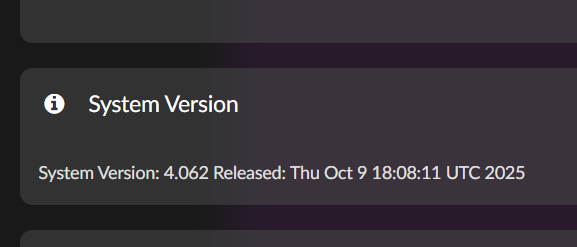

Hey @nerd @RedEyeNinja
I just updated the plugin to 3.5.8 on rPi5 using rPi touch display 2 running Volumio 4.062.
I also enabled HDMI 0 to keep audio alive. Everything seems to work.
Regards / C

When setting the zoom to 100%, the right edge extends beyond the screen, cutting off half the song’s duration last number. 3.5" LCD screen on GPIO. I couldn’t shift the image to the left using the display settings. Is it possible to add shift to the zoom options, since the image is scaled from the left edge, not the from the center? Or somehow else fix it? Thank you.
