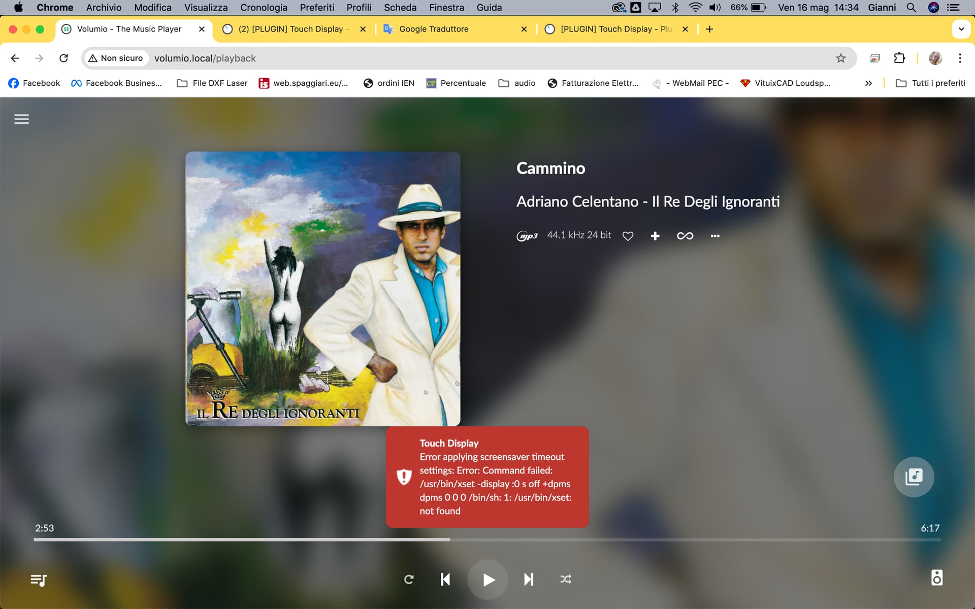

after reboot…
Please post the result of
whereis xset
xset: /usr/bin/xset /usr/share/man/man1/xset.1.gz
Is the error showing up after every reboot?
Does the error occur when you set the screensaver timeout on the plugin’s config.page from e.g. 120 to 0 seconds, too?
I set the screensaver to 0, now I have no error.
