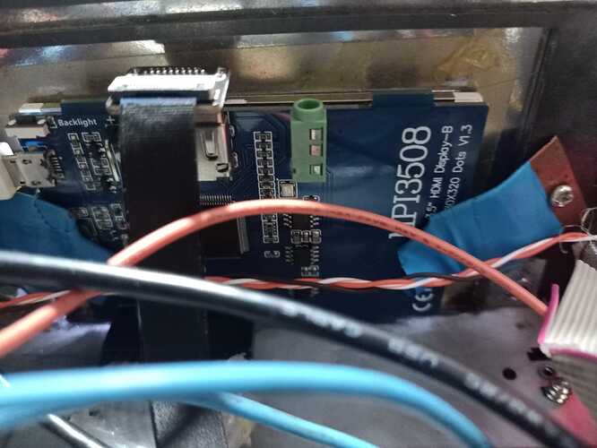

this is my display…
and there’s the backlight adjust
i opened the box
gvolt
May 13, 2025, 5:58pm
1452
Well, this is not the display you confirmed to me before. Instead your display seems to be this one .
