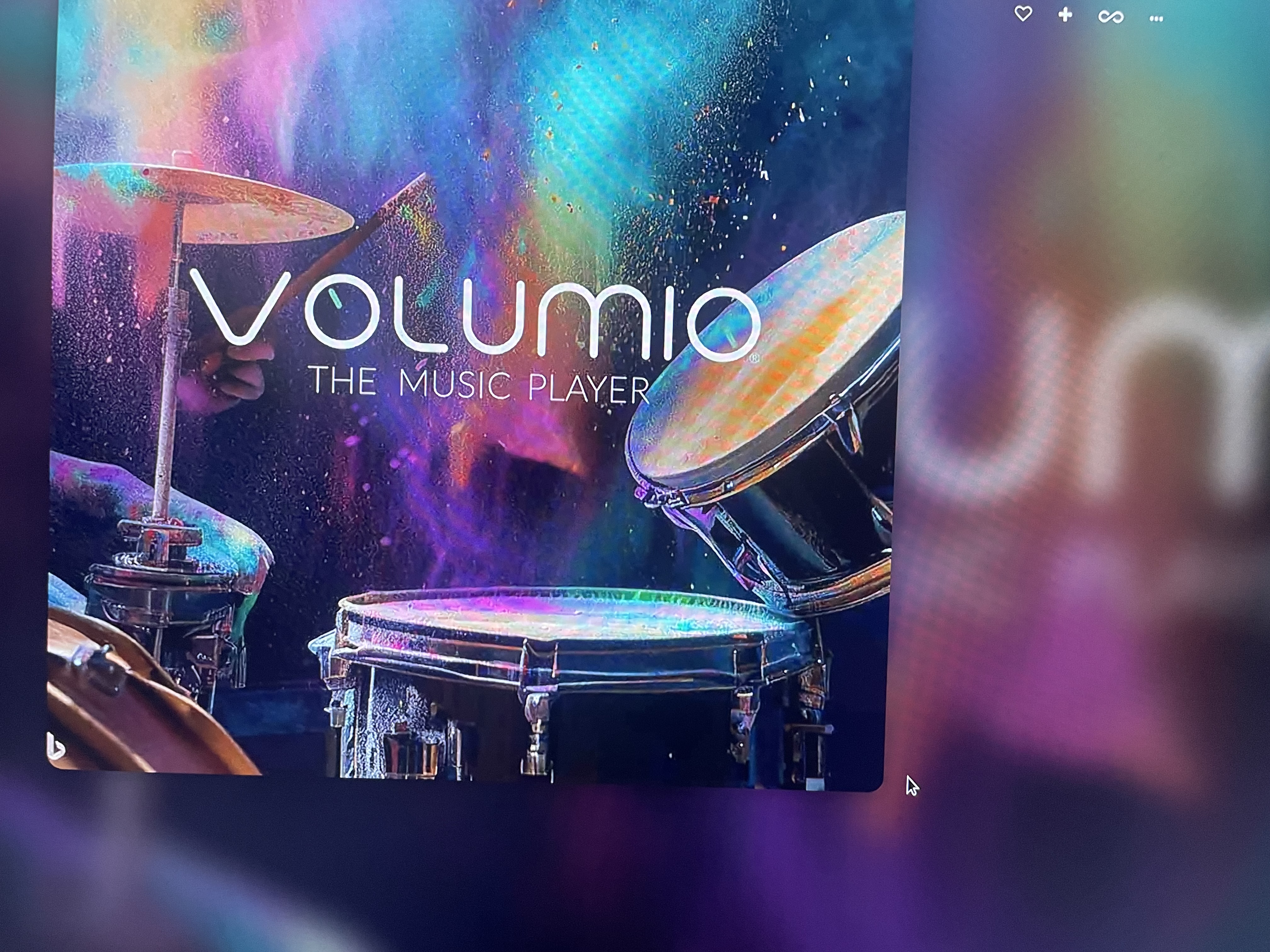

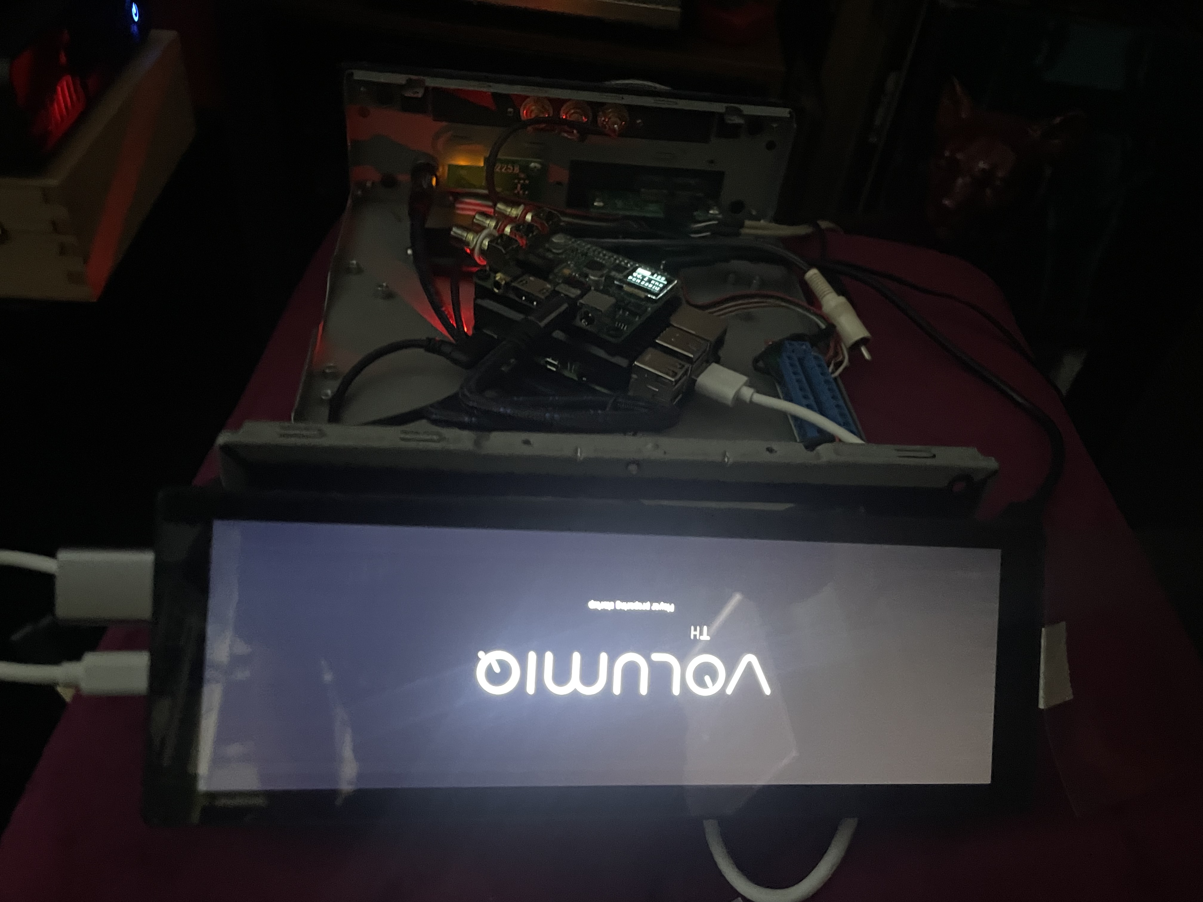

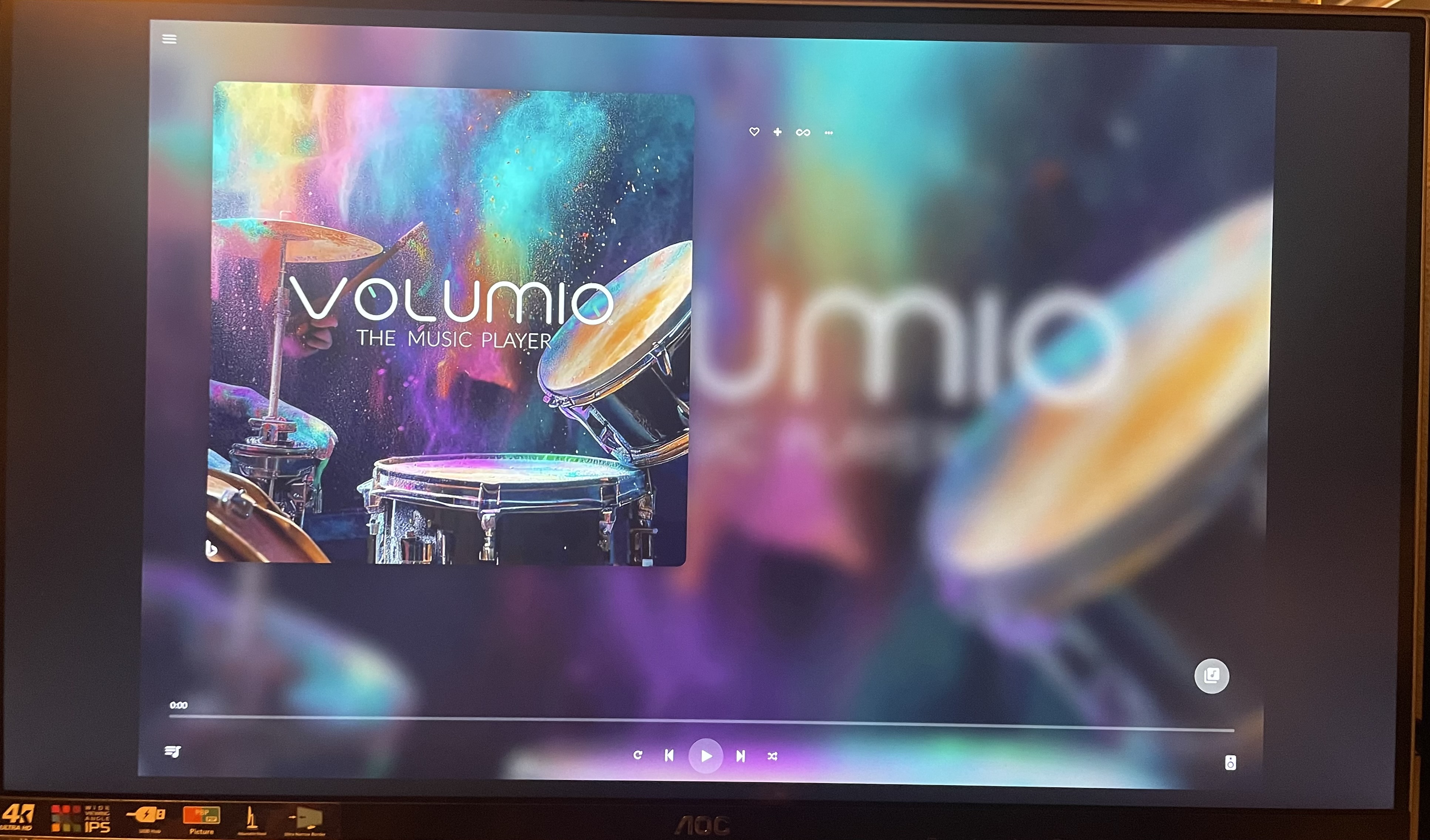

Repeat the procedure. Play on TV. Don’t disable RPI and change HDMI
Gelo,… It’s confusing, now there is no mouse/keyboard available on the Volumio system which is connected directly to the HDMI standard monitor, several restarts have been carried out…
I don’t understand. Did you do as I said? If you have an image on a normal monitor, switch to 1280x400
hi Gelo, sorry about all the problems…
I can’t change the resolution to 1280x400 at the moment;
for reasons unknown to me, no mouse or keyboard is currently recognized by the Volumio OS…
to relax, I took a break with a vinyl on one of my turntables…![]()

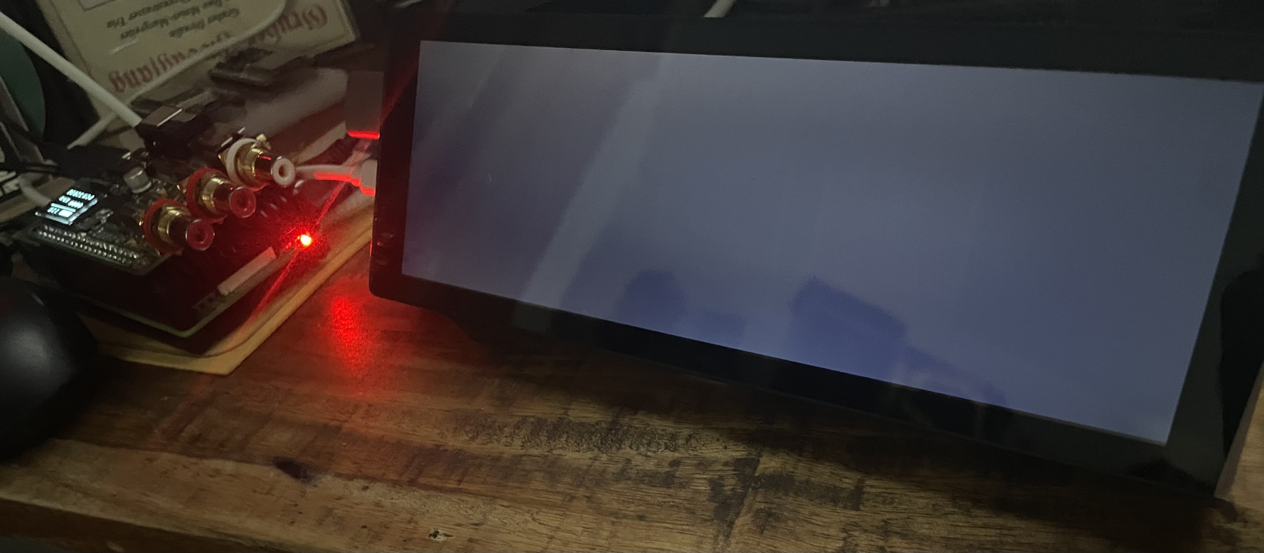

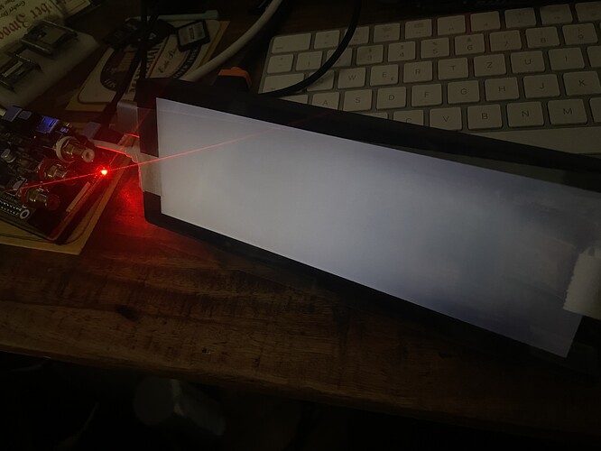

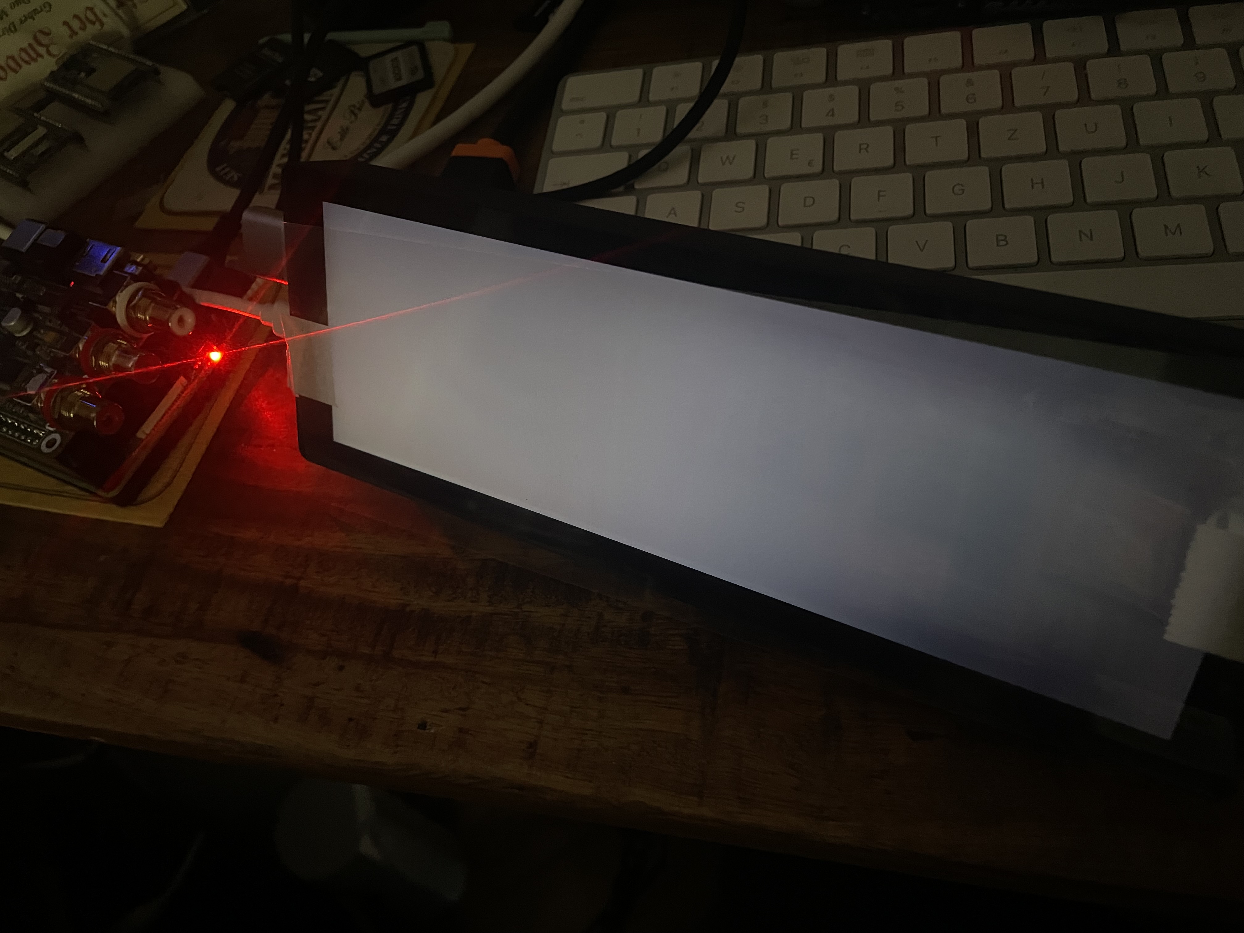

remove the HDMI plug from the 24" monitor and insert it into the 1280x400 monitor.
DO NOT disable RPI
OK, now enter your monitor data in userconfig.txt and reboot
PS. Does the monitor have power?
power comes from Pi USB3; directly power is available, but nothing changes…
Display data‘s for this modell are not specific available, the only parameters i have and know are;
7,8“ 1280x400 ISP HDMI Touch Display (Pi compatible, see screen from Pi OS
So ask e.g. @wheaten for userconfig.txt data (he has a 1280x400 monitor, I gave mine to my son). Or wait for @nerd to advise something
o.k., Thank you for your patience and support, greetings from ReyNee & Radio-M1, the only one…
The important thing is that volumio works. Only monitor configuration…
yes, i understand, but i don‘t understand this
®:sunglasses:damned Display…

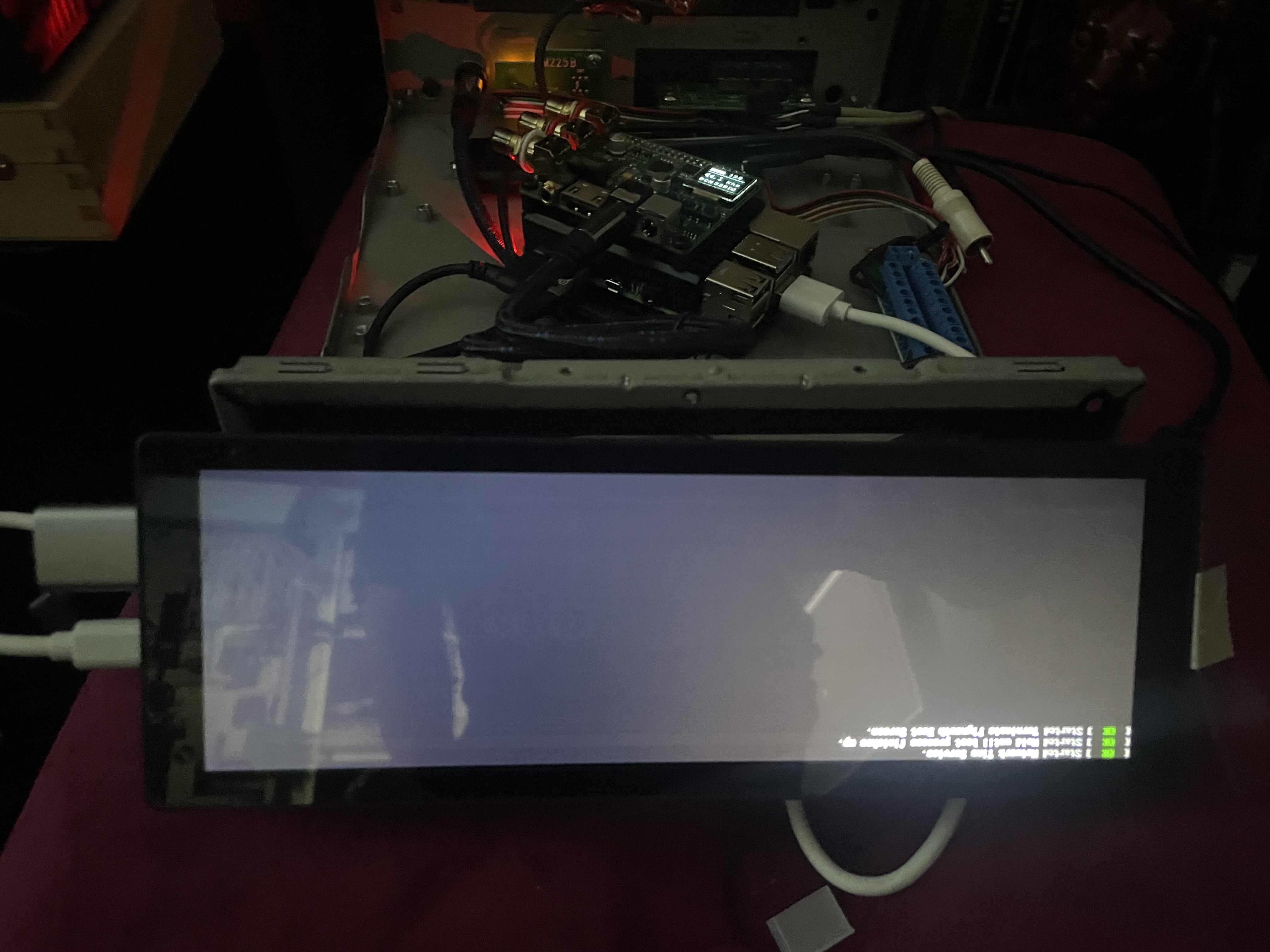

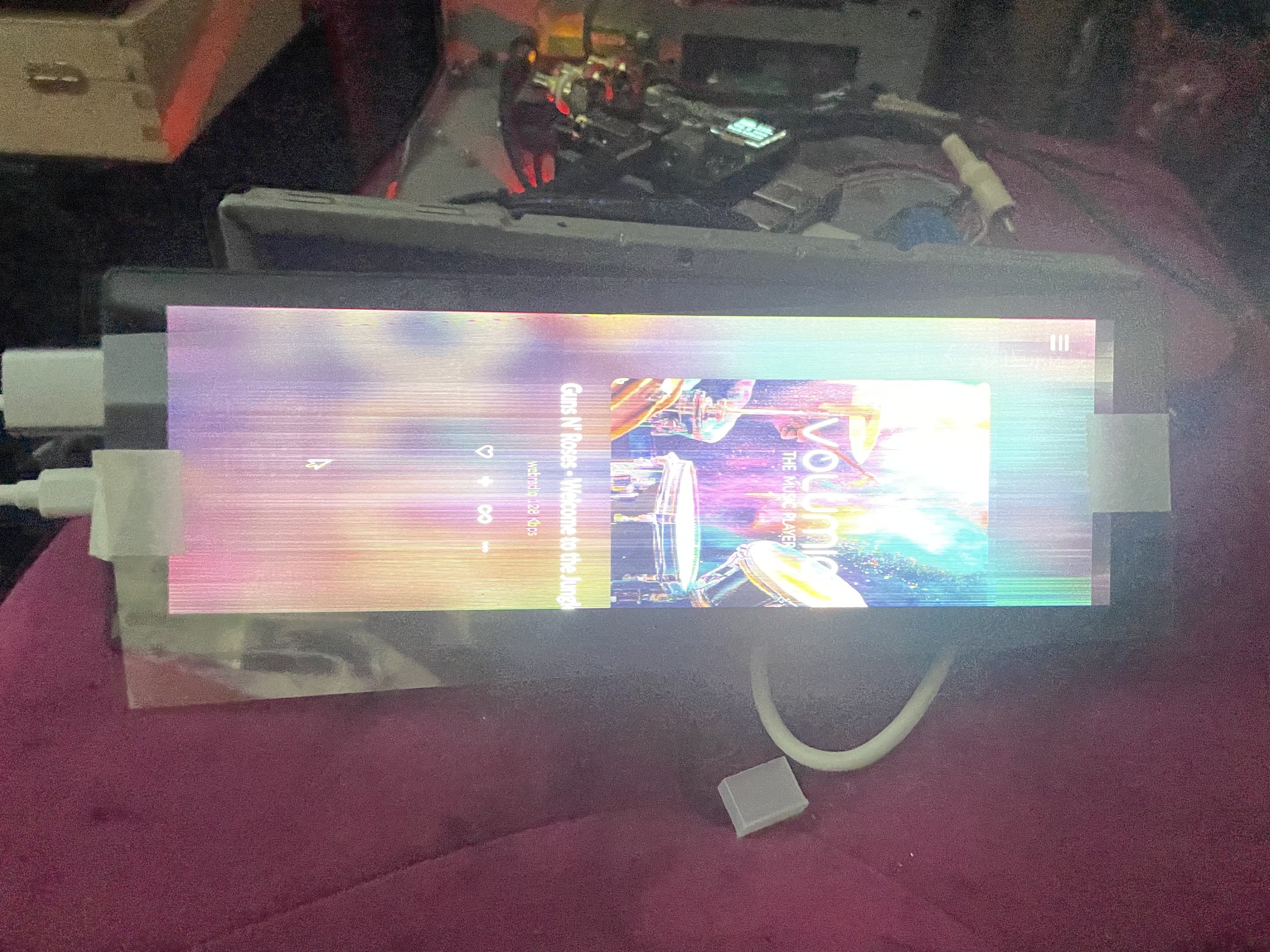

Try again to enter this in userconfig.txt:
hdmi_group=2
hmdi_mode=87
hdmi_timings=400 0 160 24 160 1280 0 12 2 10 0 0 0 60 0 58000000 7
hdmi_drive=1
hdmi_blanking=1
and reboot
The only hope is GURU @nerd &@gvolt
Try another userconfig:
hdmi_timings=400 0 30 30 30 1280 0 6 6 6 0 0 0 60 0 55296000 8
hdmi_group=2
hdmi_mode=87
hdmi_drive=2
display_rotate=1
hdmi_force_mode=1
framebuffer_width=1280
framebuffer_height=400
max_framebuffer_width=1280
max_framebuffer_height=1280
and reboot

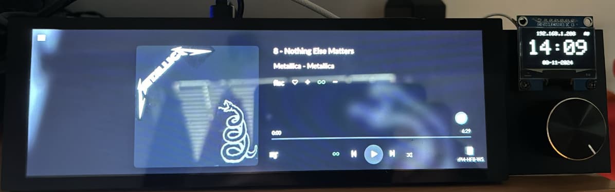

Running on a rPi4, V3.757 and V3.778
userconfig.txt:
max_usb_current=1
#disable_fw_kms_setup=1
hdmi_group=2
hdmi_mode=87
dtoverlay=gpio-ir,gpio_pin=23
dtparam=i2c_arm_baudrate=1000000
dtparam=spi=on
display_lcd_rotate=3
display_hdmi_rotate=3

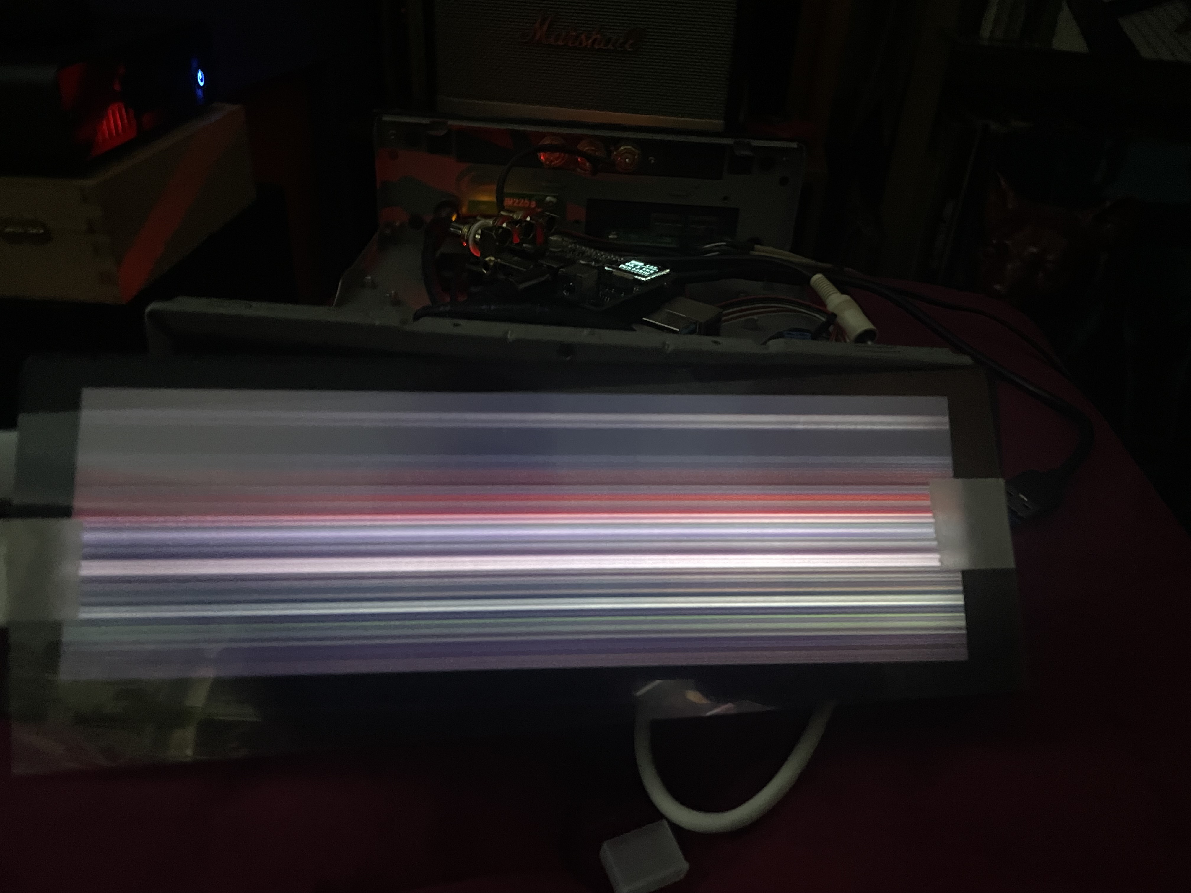

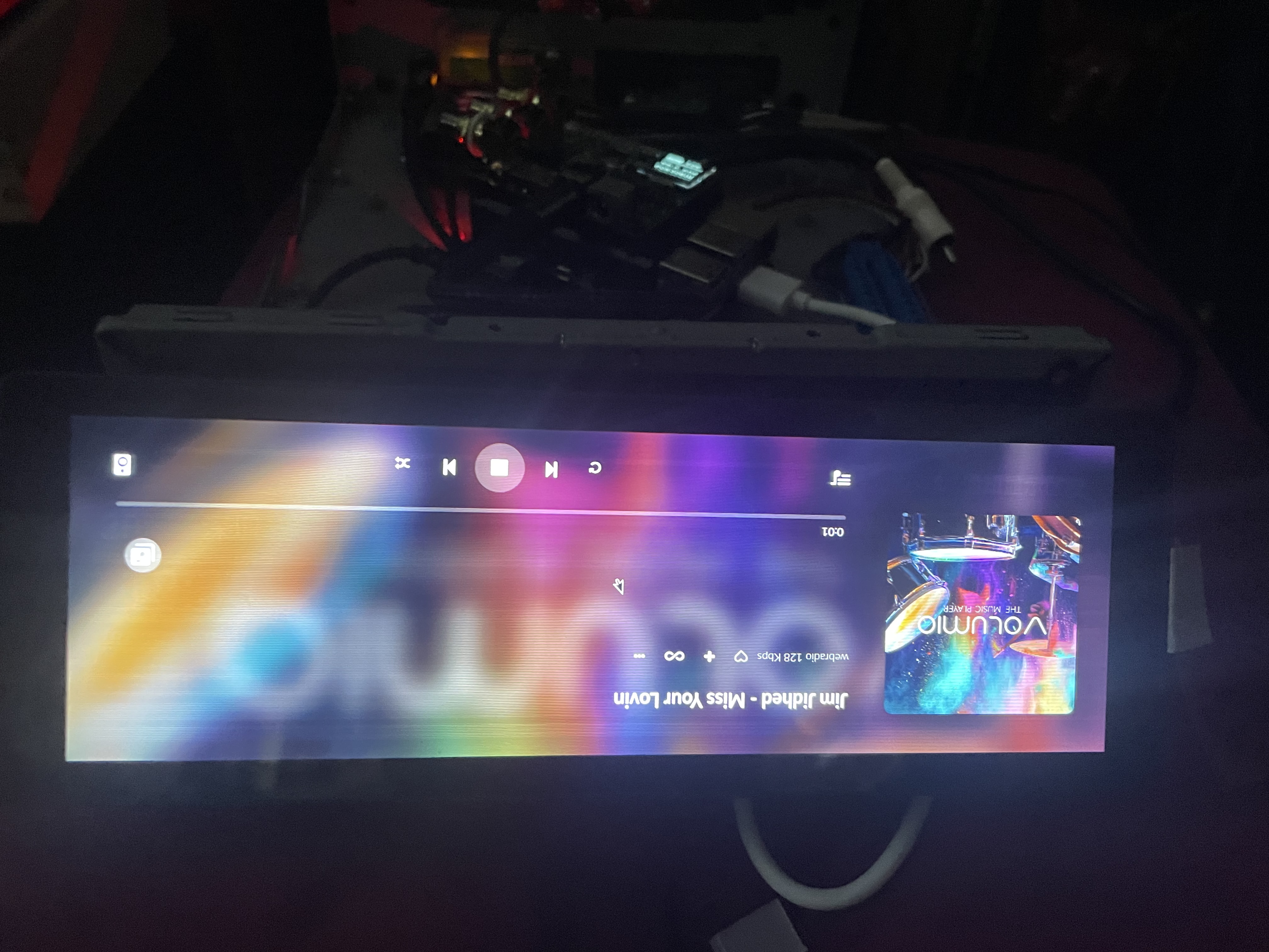

hi wheaton; thans for your config data, here are the result, monitor grafics working, but Display is blinking and works not correctly…
Try, maybe one of them will work
