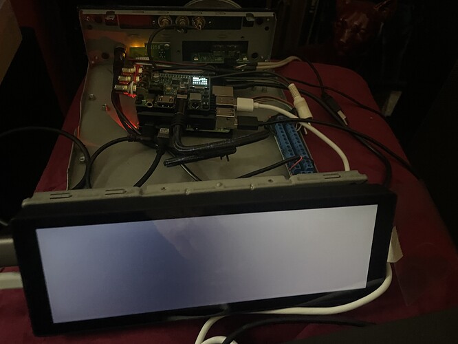

After negotiating with your screen supplier (Pisichen Amazon DE seller), which agreed on sale outside Germany, I should receive hardware anywhere between 15-20 November. Until I have direct access to the hardware I am placing further help for this screen on hold. Perhaps other community members can step in in a meanwhile.
you are (a) phantastic, NERD… ![]()
thank you for your support so far, best regards and hope everything will be fine…![]()
in the meantime, connect the rpi to e.g. a TV monitor and check if Volumio works.
Maybe it’s not the monitor’s fault, maybe it’s a poorly recorded image?
ok, Gelo5, i make test‘s, info follows…![]()
!!!Info:!!!
volumio image seems to be OK, everything is OK on the monitor (with HDMI) with Volumio OS & Pi4…
!blank screen on Pis.
1280x400 ISP HDMI Touch Display…!
install Touch display and check (TV) ~15min
Volumio Touch plugin…?
yes
o.k., answer follows…
Volumio Touch plugin installed, started, and Volumio grafic works on HDMI Standard CPU Monitor(24“)…
Don’t turn off RPI, switch HDMI to 1280x400 and see the screen
ahhhh:man_facepalming:, msg. saw too late, pi restarted with 1280x400 display, no change here, display blank…![]()
