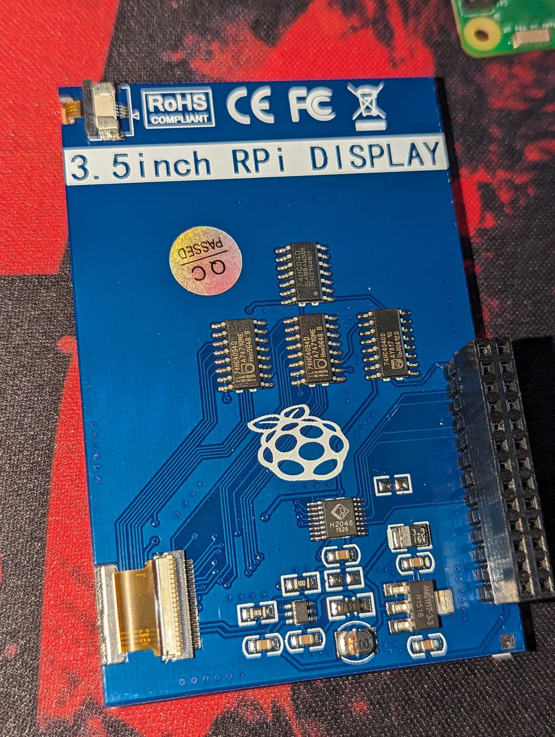

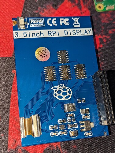

I’m unable to find the model number. Here is the display pic,
Where did you buy the display? Do you possibly have a link?
Did you receive some kind of documentation with the display?
I brought it from AliExpress. Let me see if I can get some documentation.
