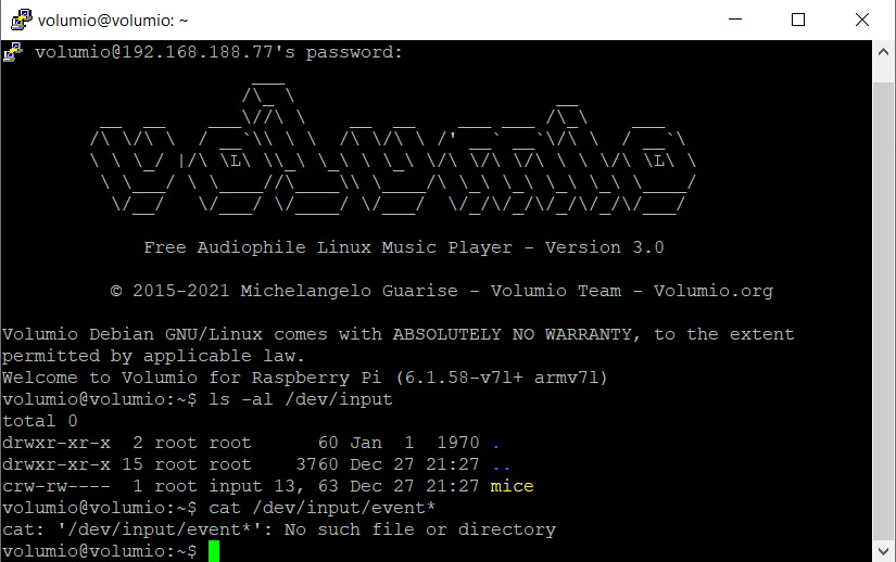

gvolt
December 27, 2023, 8:33pm
742
Please post the result of
ls -al /dev/input
If the “/dev/input” directory is not empty please also check if running
cat /dev/input/event*
and touching the screen shows some reaction (weird characters). You can exit this test by hitting Ctrl+c
If possible as already requested post a picture of the connections you made between display and Pi.
gvolt
December 27, 2023, 8:39pm
744
The touchscreen is not registered as an input device.

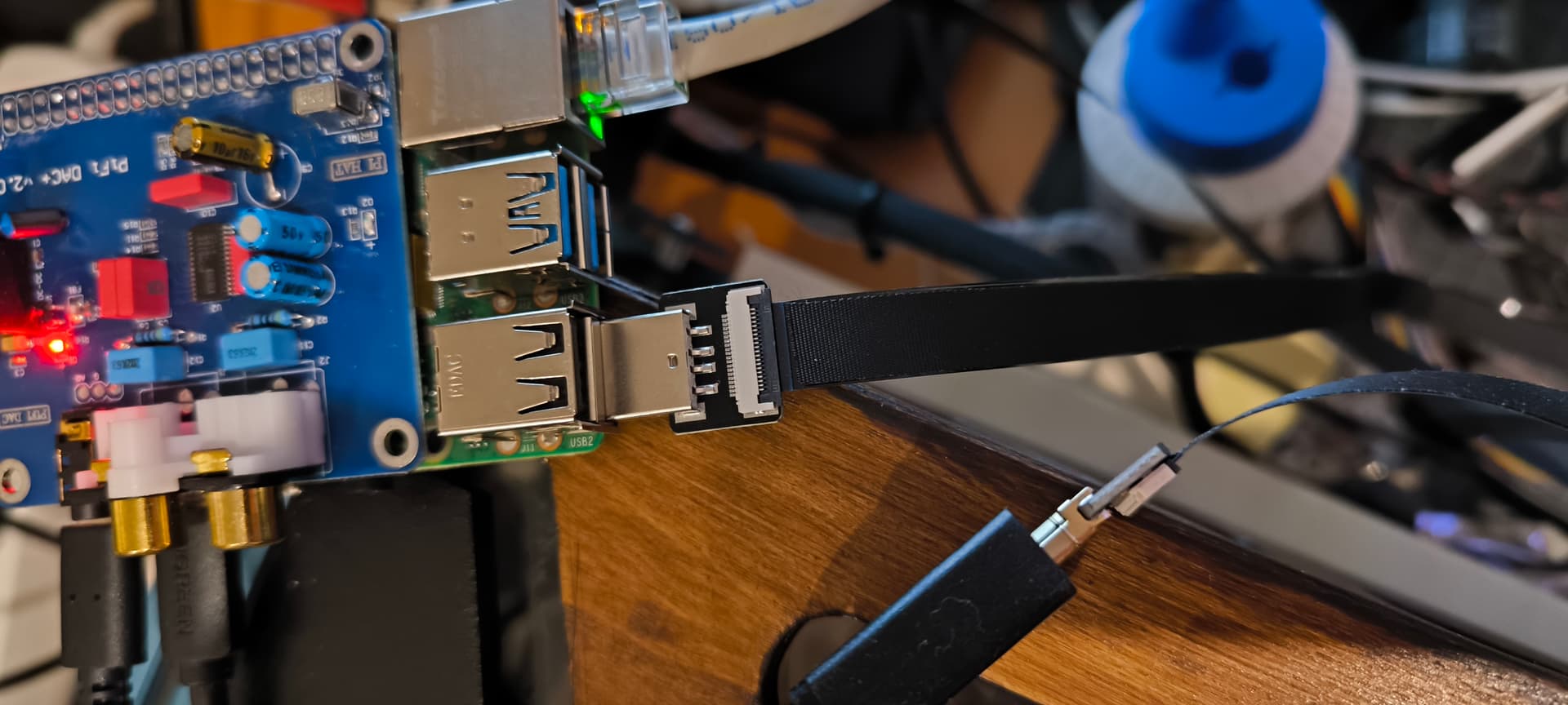

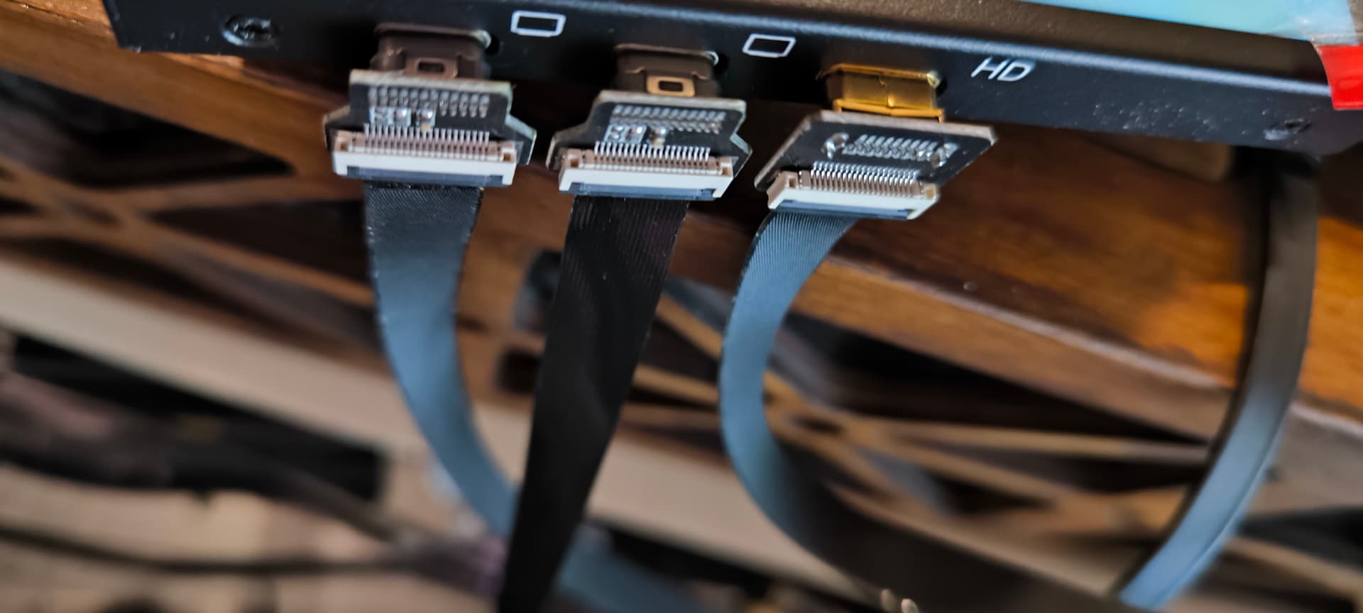

gvolt
December 27, 2023, 8:45pm
746
Should be, I guess, but I can’t find any documentation for the display.
As already requested, please post a picture of the connections you made between display and Pi.
Rue
December 27, 2023, 8:48pm
747
You can see the HDMI and USB-C plug
Display side
