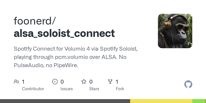

Between those releases: GitHub is the cutting-edge line

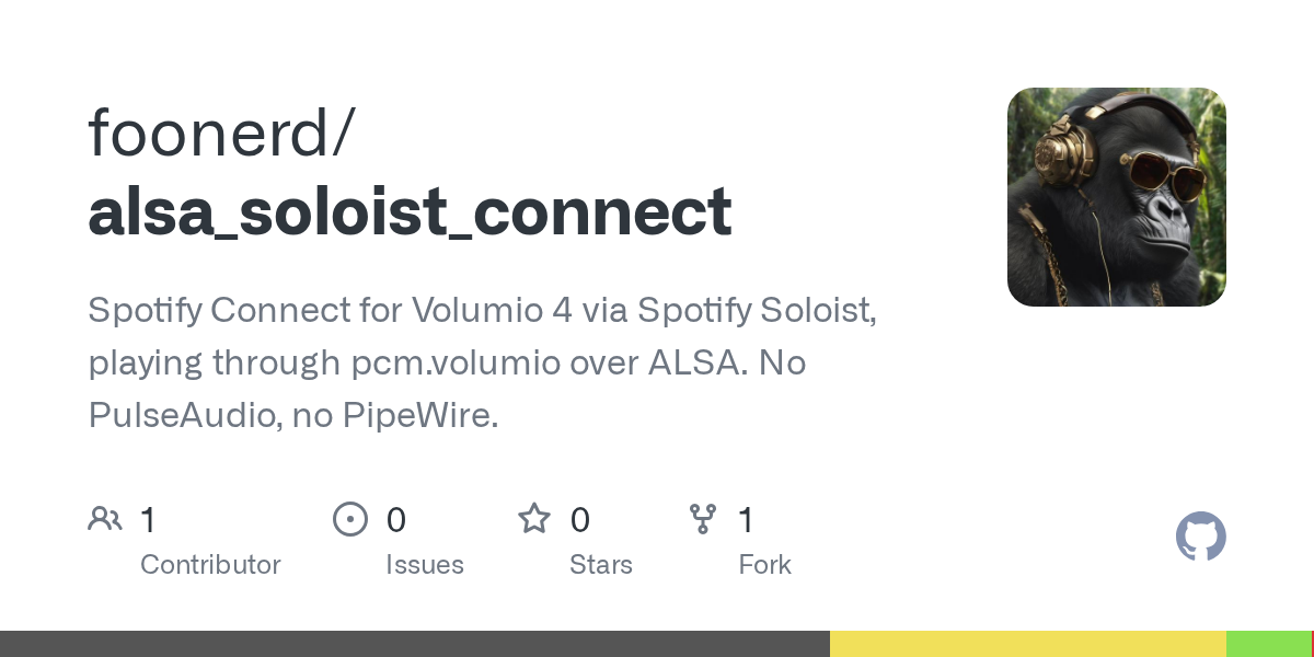

but it doesn’t work. this does:
ssh volumio@ip_address
git clone --depth 1 --filter=blob:none --sparse GitHub - foonerd/alsa_soloist_connect: Spotify Connect for Volumio 4 via Spotify Soloist, playing through pcm.volumio over ALSA. No PulseAudio, no PipeWire. · GitHub
cd alsa_soloist_connect
git sparse-checkout set soloist_connect
cd soloist_connect
volumio plugin install
