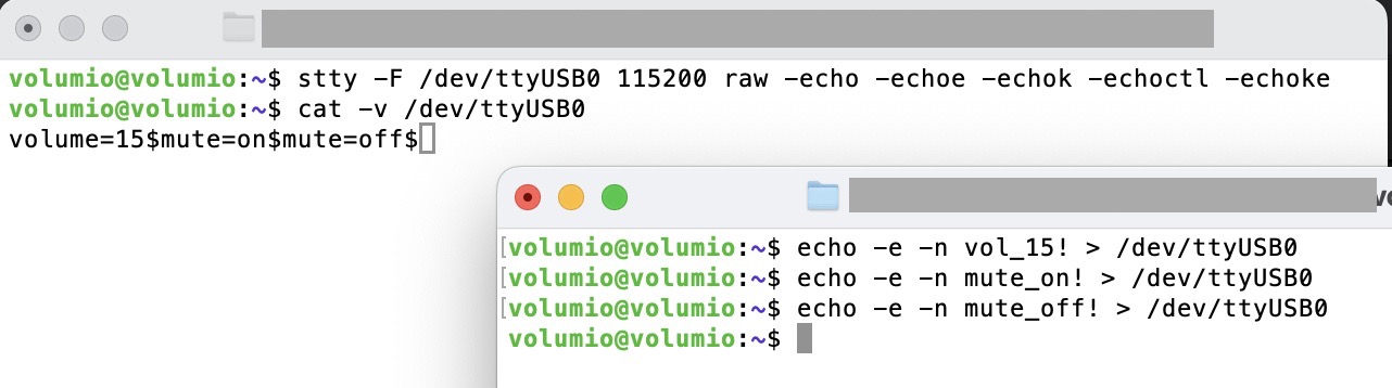

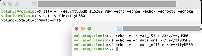

Once you have connected the terminal for echoing the commands from the amp, you can connect a second terminal to your Volumio device and echo commands to the amp by using echo -e -n vol_15! > /dev/ttyUSB0 (replace vol_15! by your command and the path by the path of your serial device (below is an image of how to do it with 2 terminals).

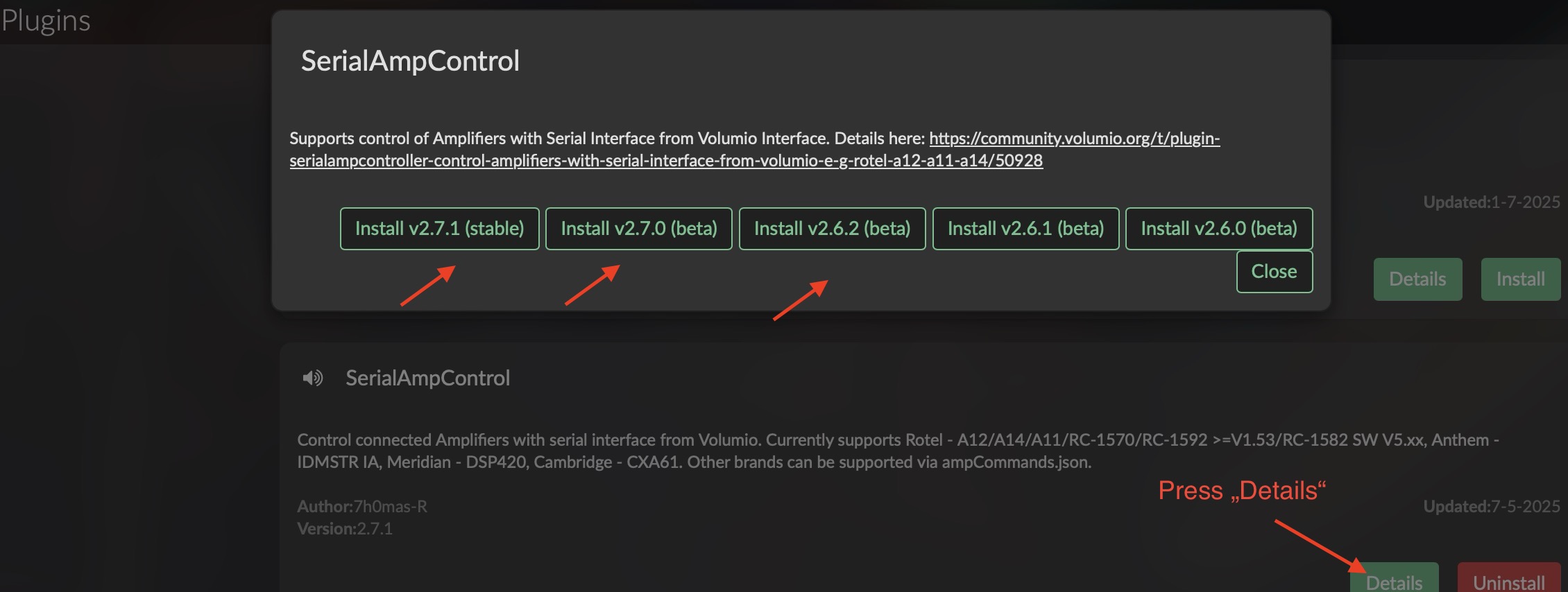

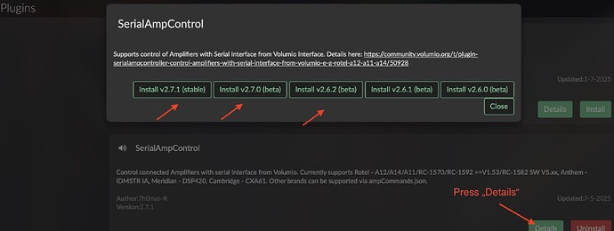

  1. Can you please try to check, if the plugin is still not shown in the beta channel? As balbuze observe on May 1, it was invisible for you due to the missing support flag for arm64 architecture. But I added that on Bookworm and on Buster in version 2.7.1.
  2. Whenever I am adding a new commit to the branch you linked to in your post, there will be a new “version” of some files and not every commit I make is operational. So even with the link to my repository I do not know, when you pulled your copy - you could still have an old version or worse, you could have pulled an intermediate commit that is buggy. You can check the version of the code on your device by checking line 3 in the package.json file and there can be multiple commits on the same version, so I additionally need to know the commit you downloaded. This is all excluded if you take the version from the plugin store - which I control before publishing.
  3. I tried to find a documentation of your amp but did not find any. The easiest would be, if you make a table with two columns: left colum command sent to the amp, right column response from the amp. Additionally try all the commands with the two terminals as described in the screenshot in my last post.
    In Terminal 1 (replace 115200 by the Baud-rate of your amp, ttyUSB0 by the device-name of your serial interface:
stty -F /ddev/ttyUSB0 115200 raw -echo -echoe -echok -echoctl -echoke
cat -v /dev/ttyUSB0
In Terminal 2 post the commands now, one by one and then check what response you see in the first Terminal:
echo -e PWON\r > /dev/ttyUSB0
If the terminal test is not properly working, modifying the plugin is wasted effort.
