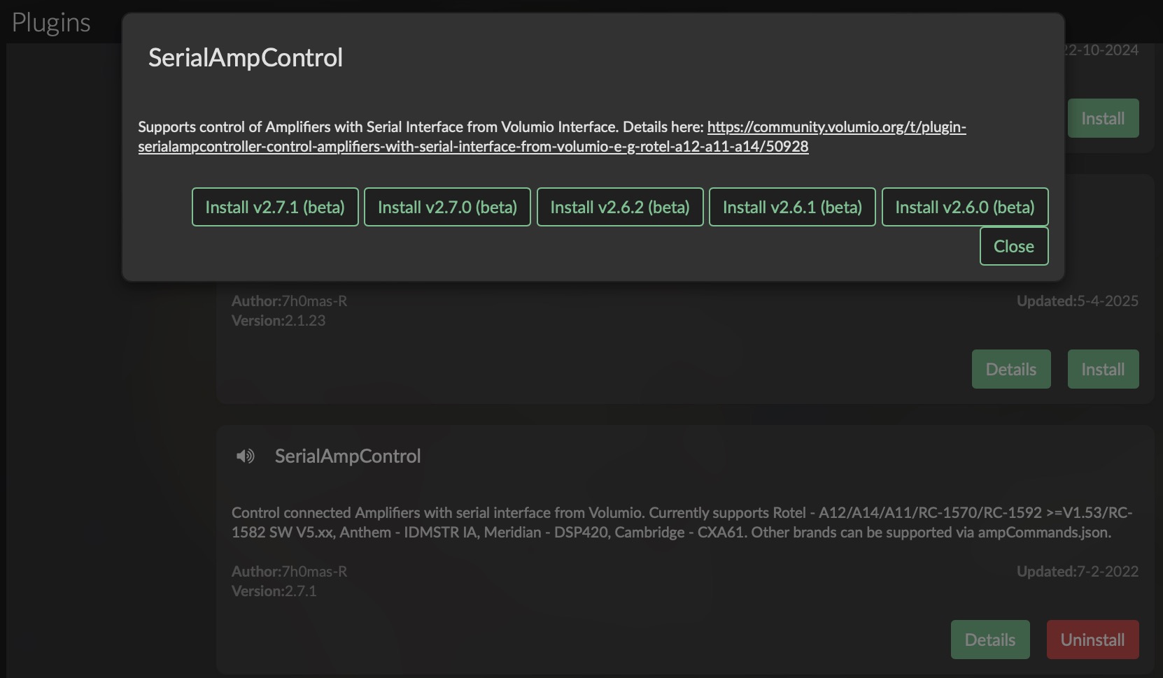

The beta versions of plugins can be found when you press the ā€œDetailsā€ button (see screenshot). For both Buster and Bookworm the latest version is 2.7.1 (see screenshot).
