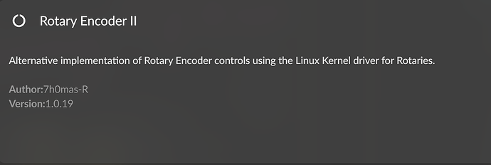

I had the rotary encoder working but after upgrading to the latest version of Volumio it will not save my changes in the Rotary Encoder II plug ins. I tried enabling the Live Loggin and got the following message.
info: Received Get System Version
info: CALLMETHOD: system_hardware rotaryencoder2 updateEncoder [object Object]
info: CoreCommandRouter::executeOnPlugin: rotaryencoder2 , updateEncoder
error: [ROTARYENCODER2] detachListener: could not kill handler process
