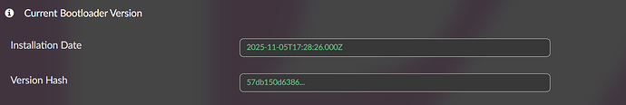

Update to latest firmware went just fine, Both on rPi4 and 5. 4.067

Hey @nerd!
This morning did an update to latest firmvare 2025-12-08T19:29:54.000Z on rPi4 and 5 without any problem at all. Thanks for this extremely useful plugin. It works like a charm with Volumio 4.074
Best Regards / C
