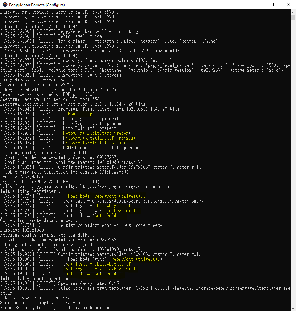

Hi @nerd
Thanks for help my dream come truth, no more edit config font again each time upgrade, I used to use MS TTF font ( msjh.ttf)…
The new PeppyFont looks great !

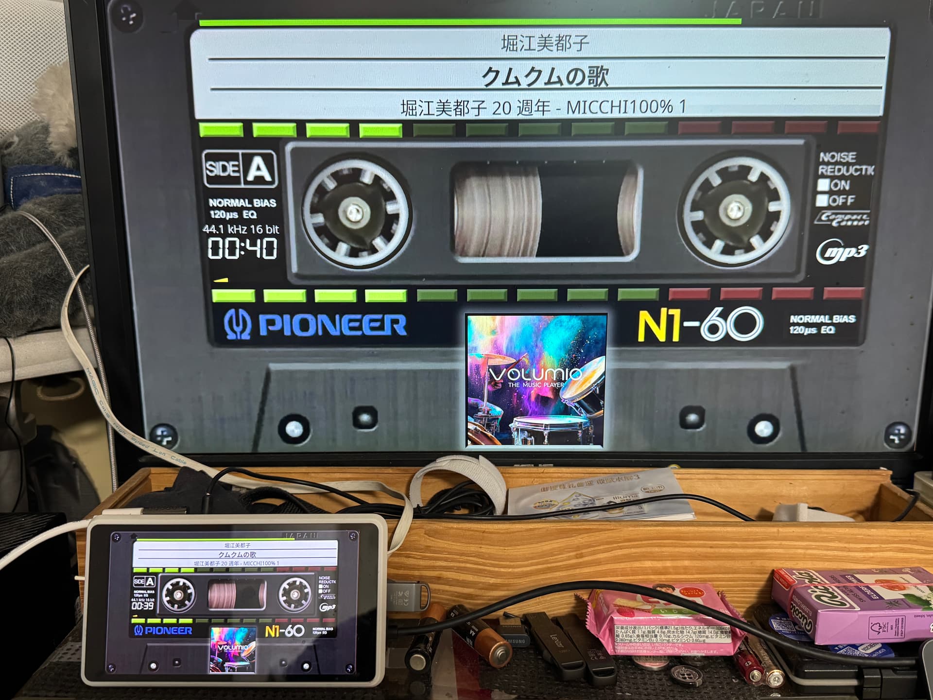

I install the experimental branch of peppy_meter and it works for local ( Pi side ).
also test “Use System Font” and it works as it should be.
Then install Peppy_Remote, but it is not working ( still square ? font )
It seems install the peppy_font, but still use lato font.
I don’t know how to debug, if I could help…
Thank you.

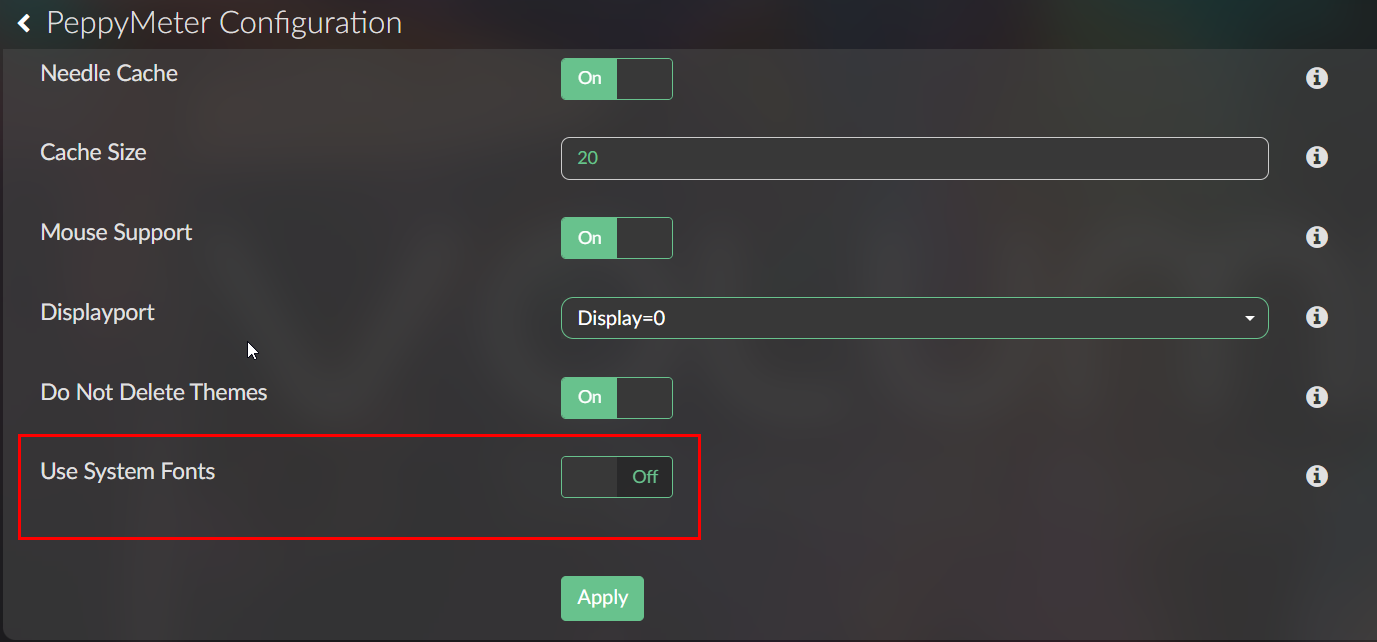

Please re-test with default fonts “Peppy”, not system fonts “Lato”.
System fronts “Lato” do not have CJK characters.

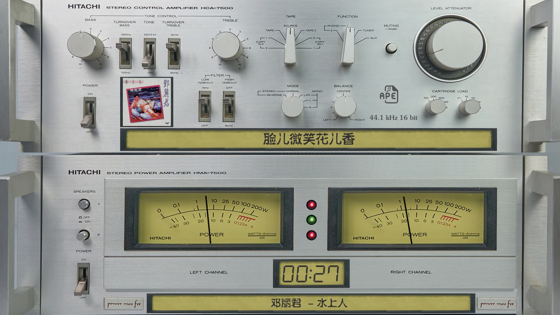

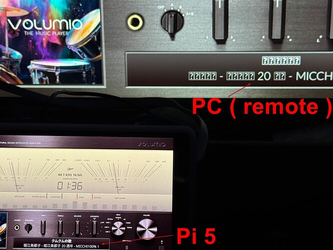

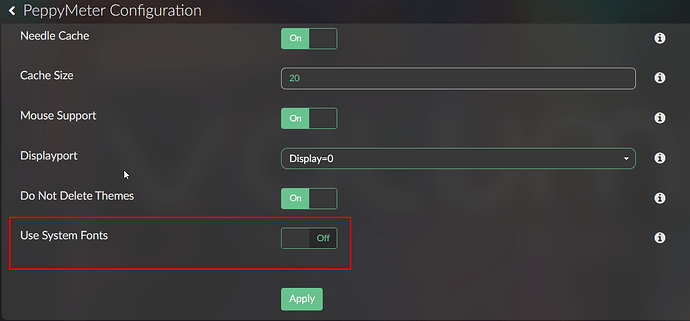

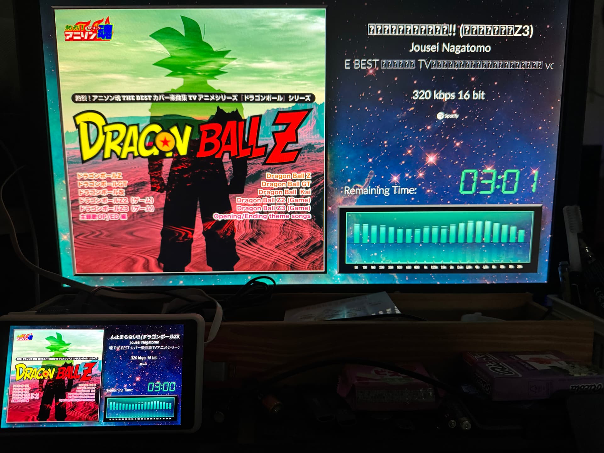

Hi @nerd

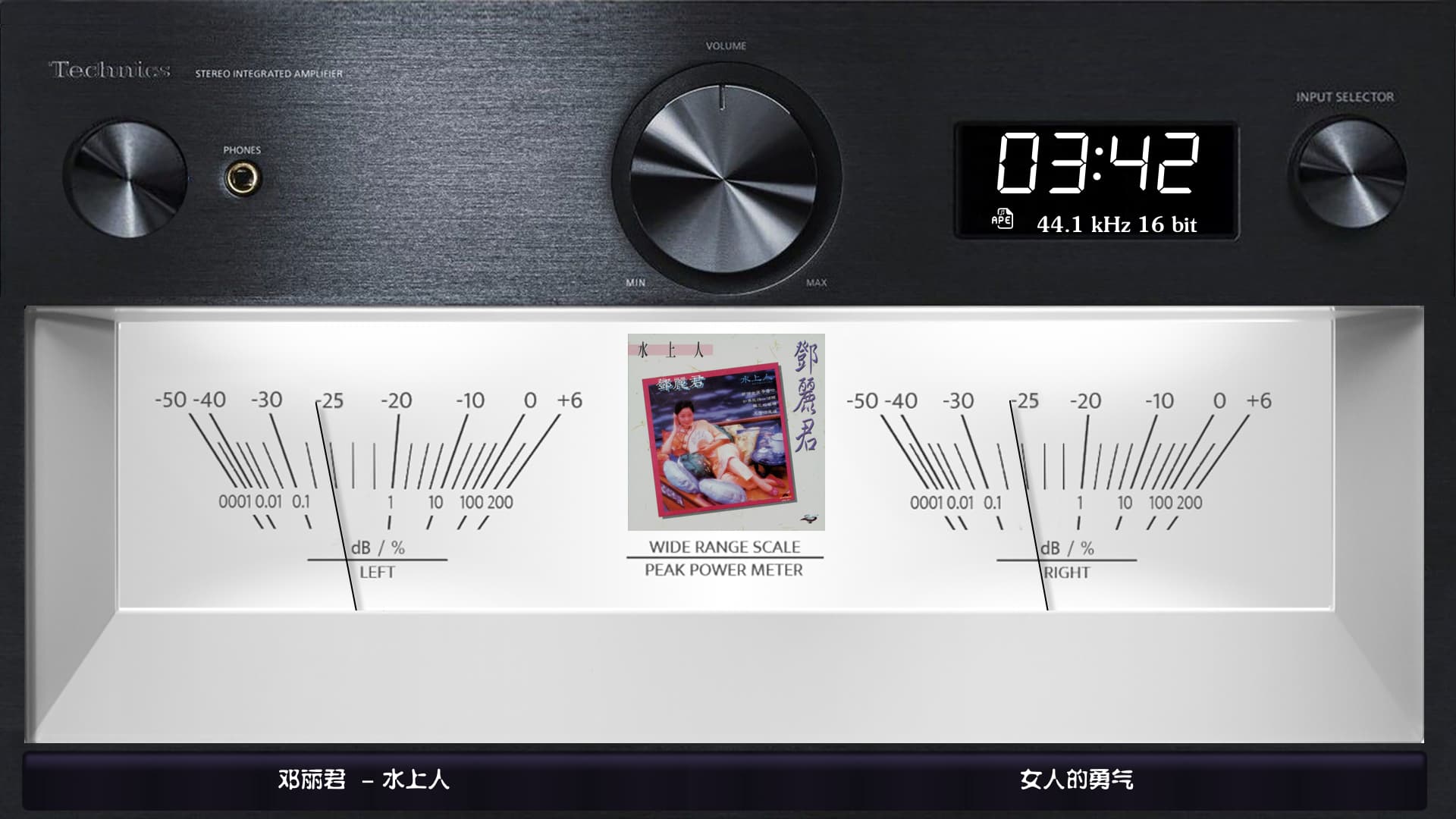

Yes, I test with “Use system fonts” turn off.

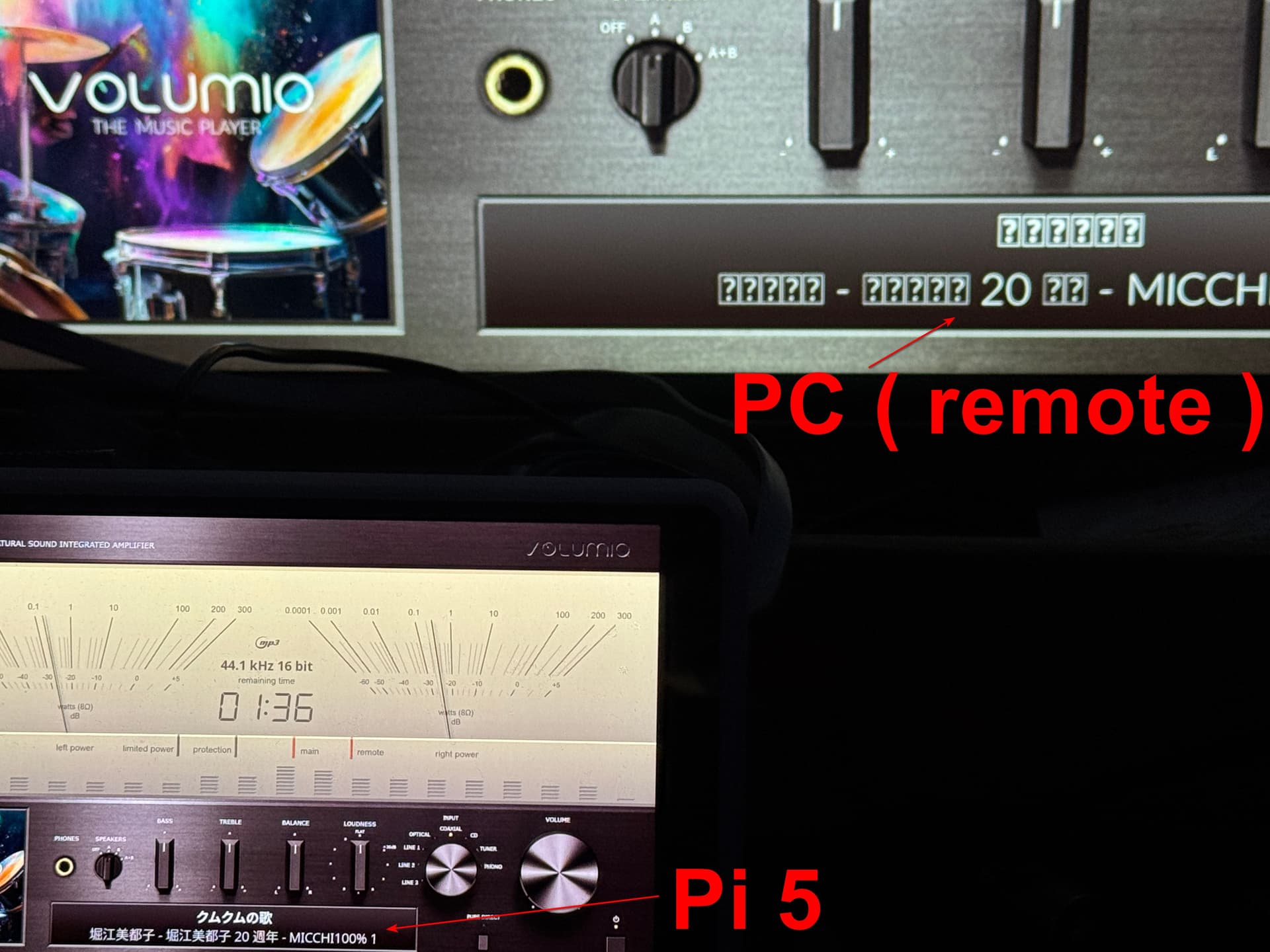

The lower part is OK with Japanese character ( Pi 5 screen )
The upper part is PC peppy_remote, Japanese character become square+?.
attach the track for test :
https://www.dropbox.com/scl/fi/cn9r6ohzwvwsd1zkeu6l6/22.mp3?rlkey=35bufz38xb1cx72oszukyezh8&dl=0
Thank you.

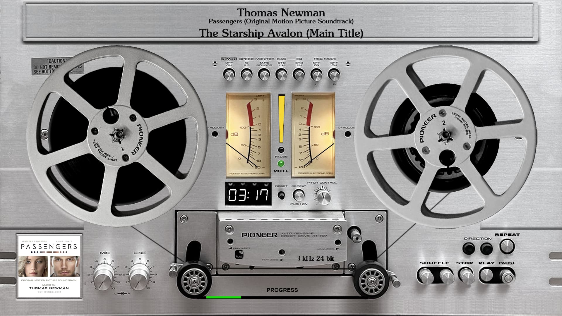

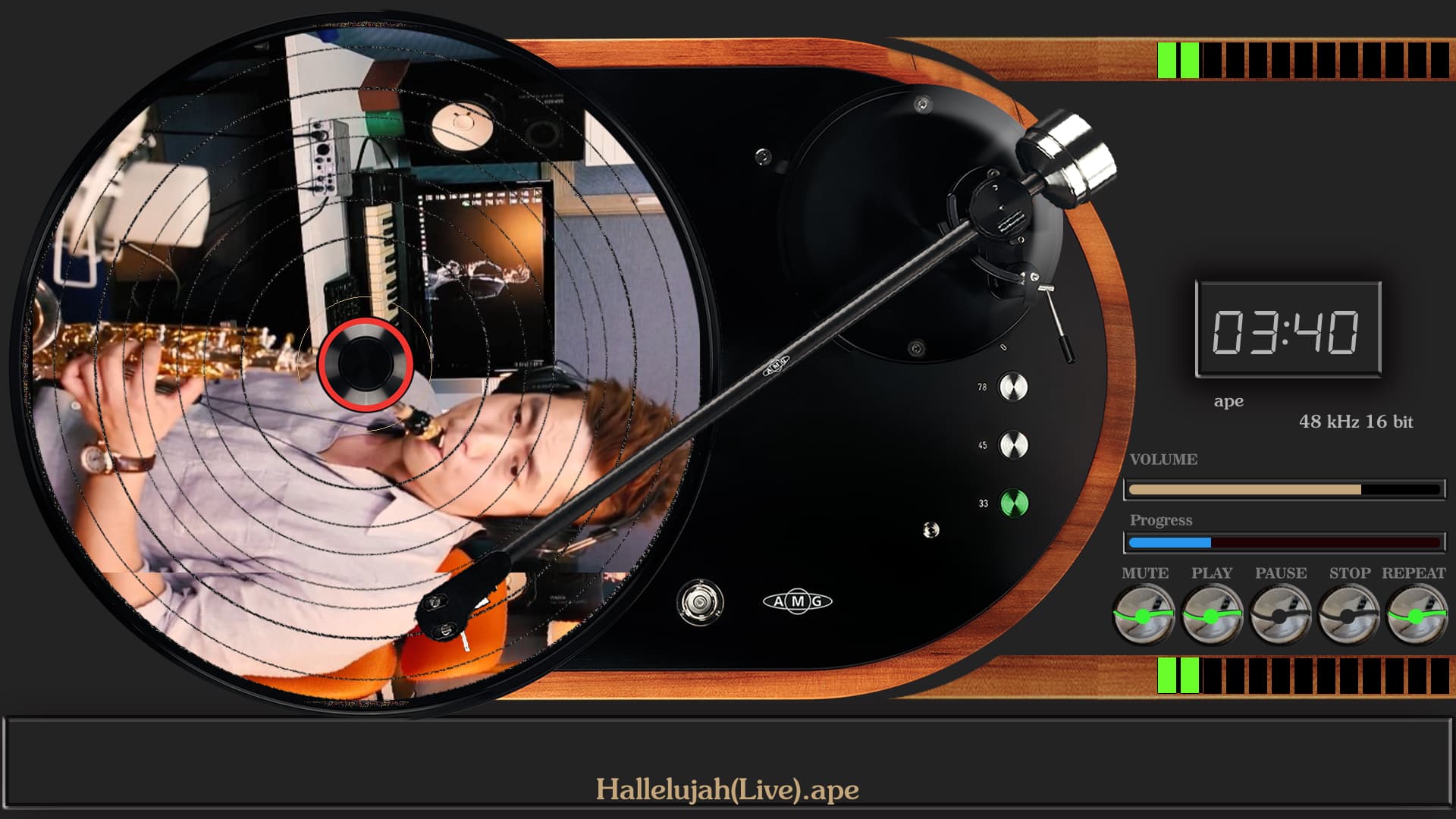

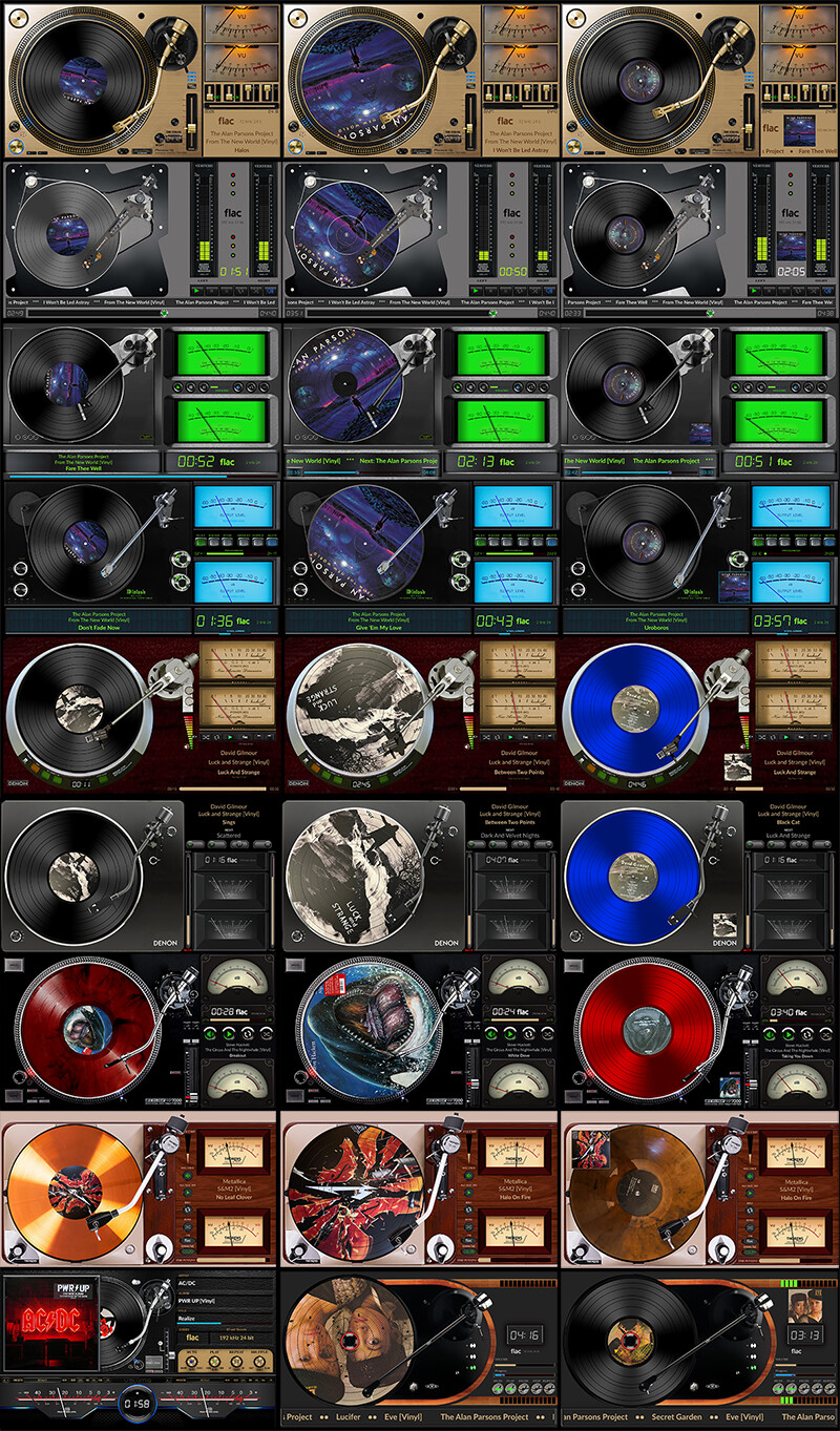

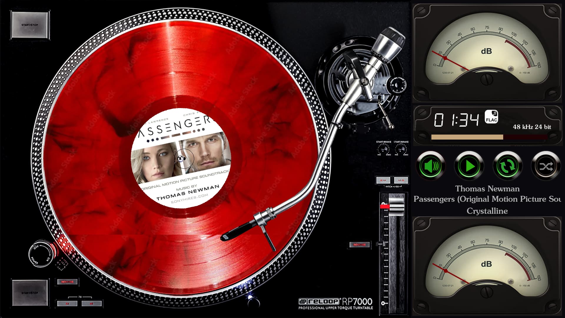

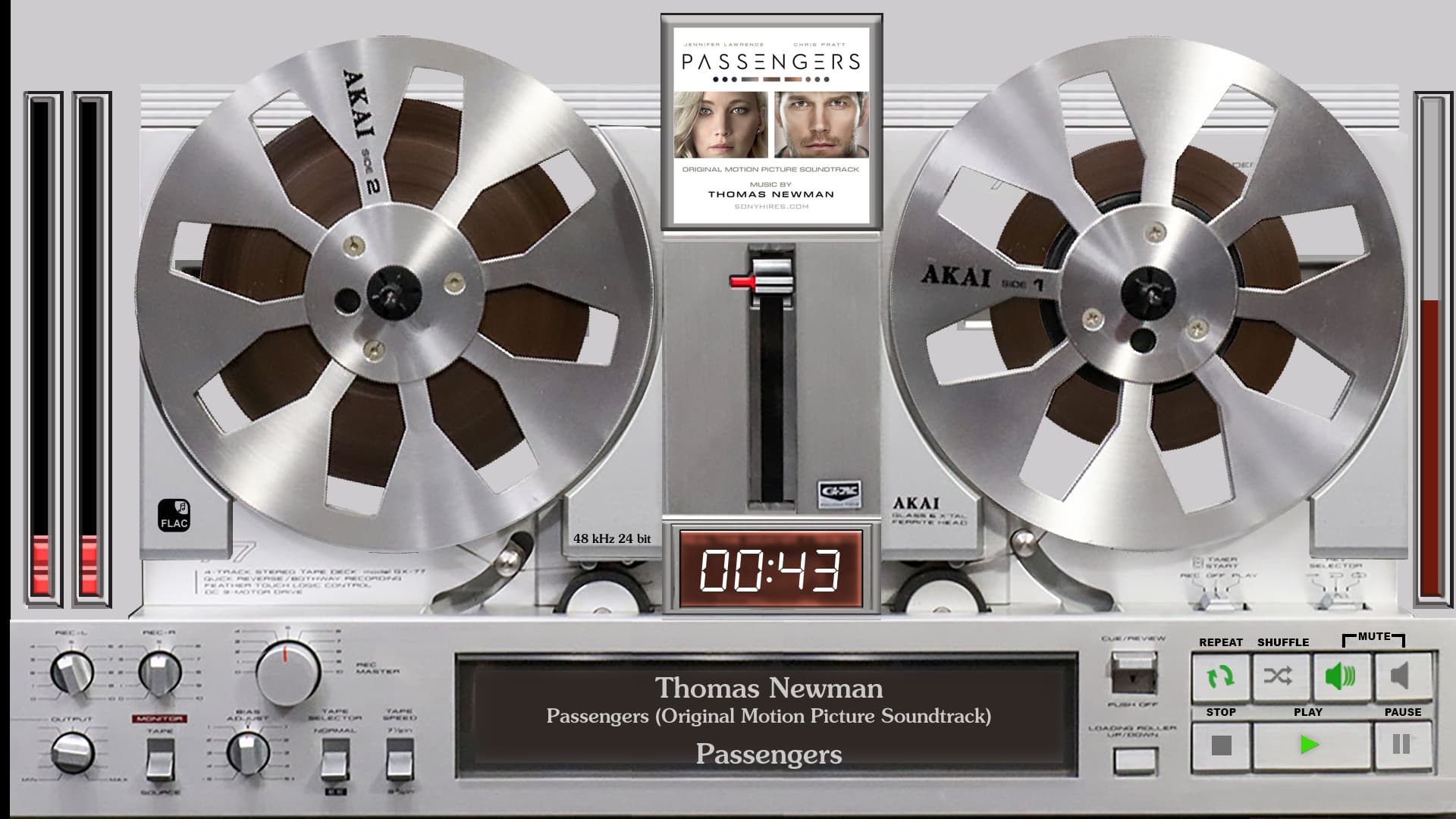

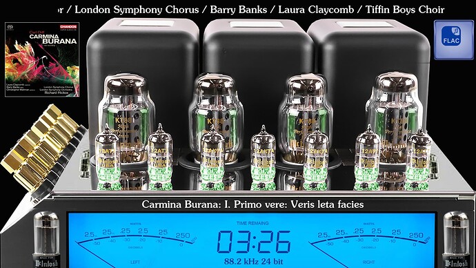

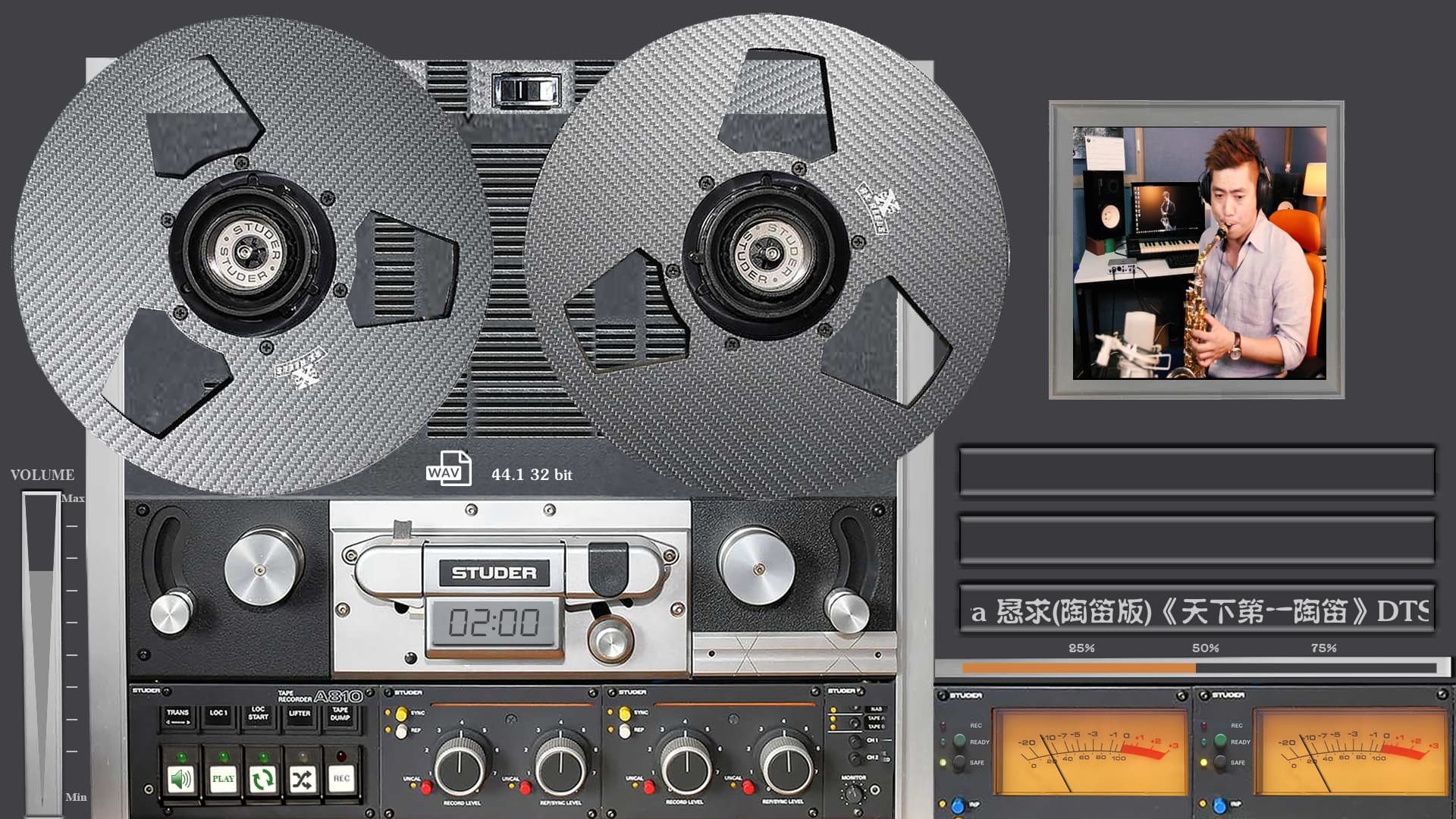

1920x1080
Skins in 3 versions:
01 - album cover as a label on a vinyl record
02 - album cover as a whole vinyl record
03 - vinyl record as the original*
*if you have the original vinyl record in the folder with the music you are playing (name it cdart.png)
https://github.com/foonerd/peppy_templates/blob/main/template_peppy/1920/1080/1920x1080_g5_710_turntables.zip

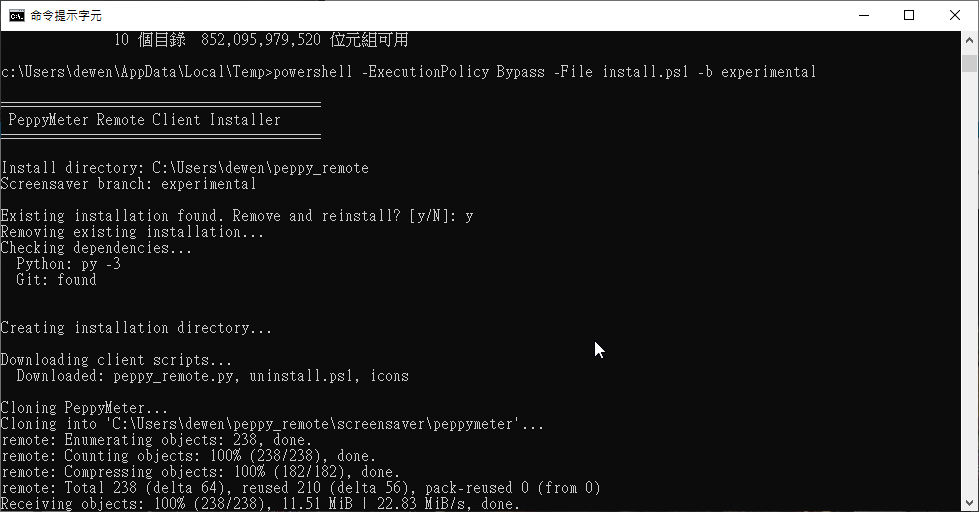

Hey @dewen,
I see what happened. Not enough caffeine, clearly…
The remote client is pulling from main PeppyMeter Screensaver branch. In order to install remote client linked to prototype code, please execute on MS Windows:
cd $env:TEMP
irm https://raw.githubusercontent.com/foonerd/peppy_remote/main/install.ps1 -OutFile install.ps1
.\install.ps1 -b experimental
Test with your CJK music library and tell me if the squares have become actual characters.
I’ve found the reason. I didn’t enable the PeppyMeter server in the plugin settings.
Thanks!

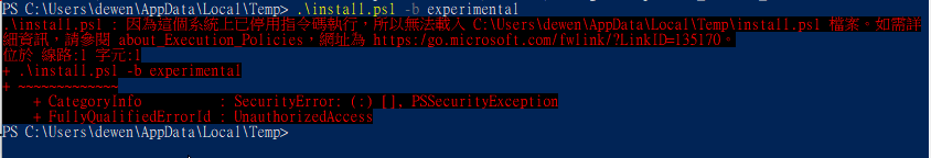

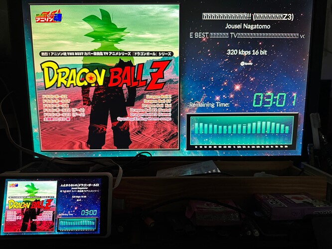

I run the command in powershell windows but failed
So I use the command ( modify from the uninstall command you gave me before )
run from win “command prompt” ( cmd.exe )
cd c:\Users\dewen\AppData\Local\Temp\
powershell -ExecutionPolicy Bypass -File install.ps1 -b experimental
and it works. now the remote client shows correct CJK characters.
Thanks a lot !

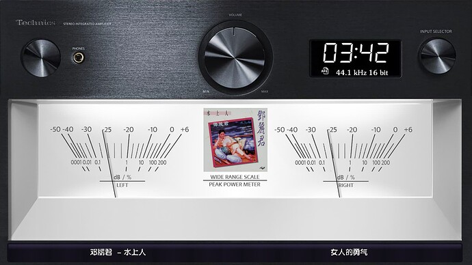

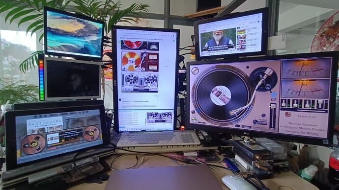

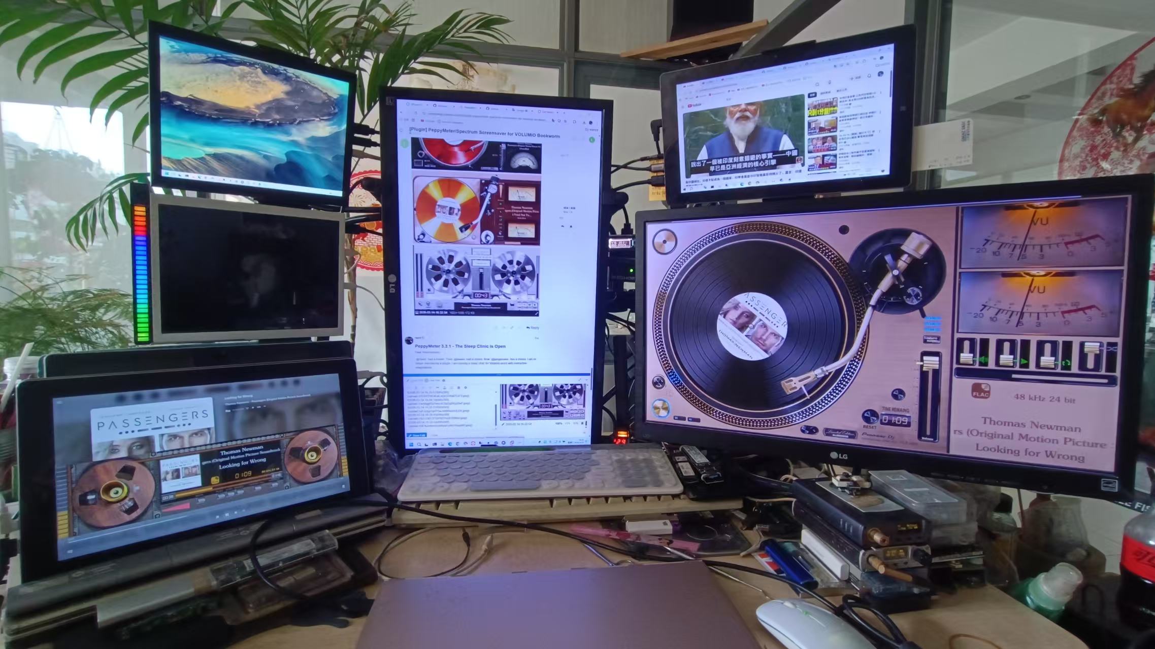

Remote client In Windows (1920x1080)

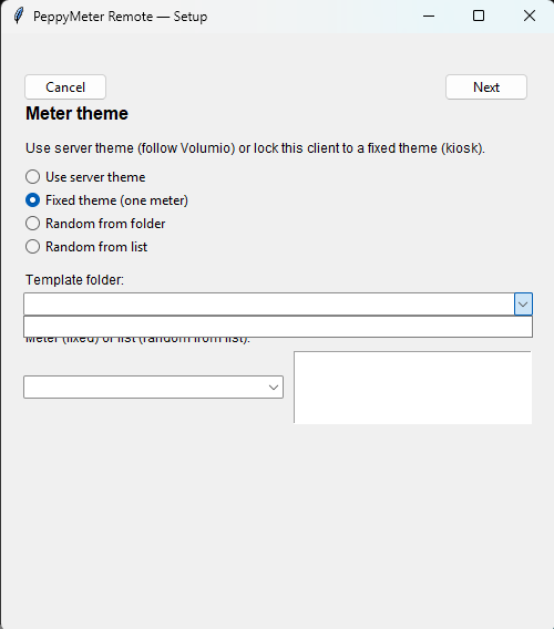

@pjorgenunes wanted to browse and select meter templates from the remote client wizard instead of being stuck with whatever the server decided. Reasonable request. Implemented. The remote setup wizard now lets you pick your template from what is available on the mounted share. One less reason to SSH into things.
