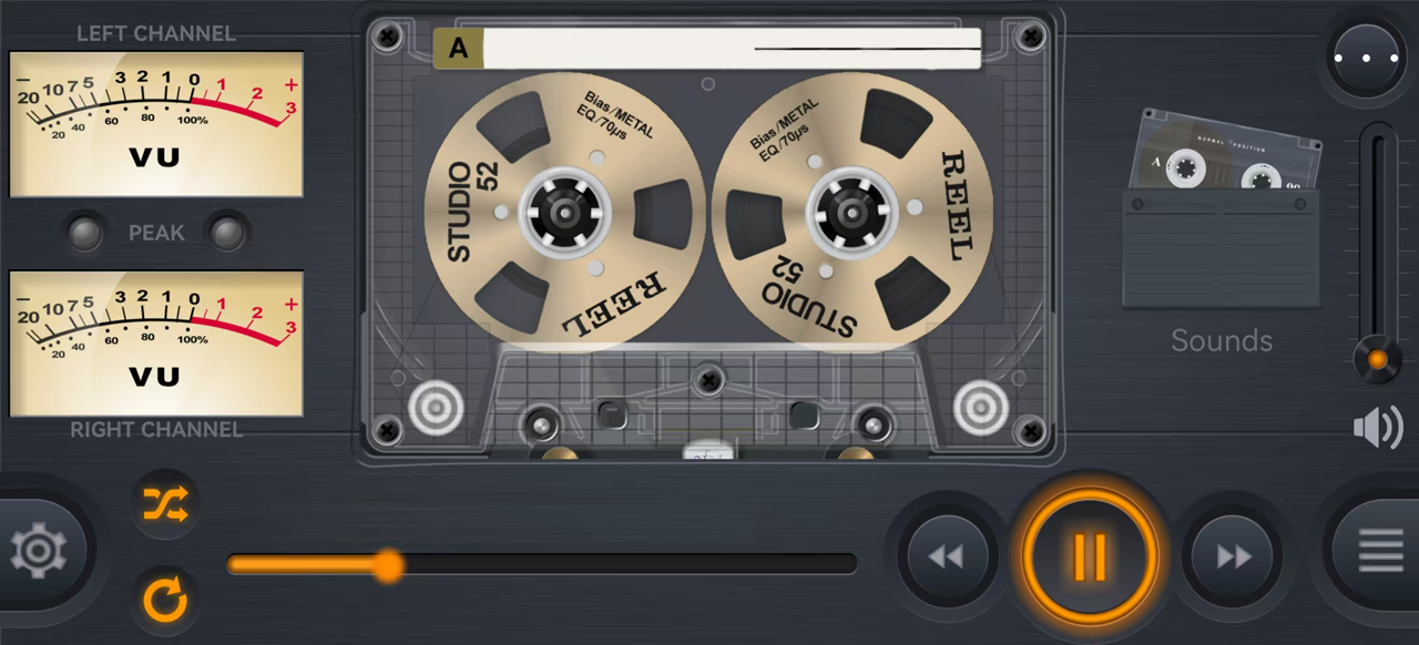

Hey @naimnatnod,
Well done on figuring out the spinning cassette animation - positioning those reel holes is fiddly work.
To get your template into the GitHub repository, first you need to prepare your files correctly, then submit them. Here is the full process:

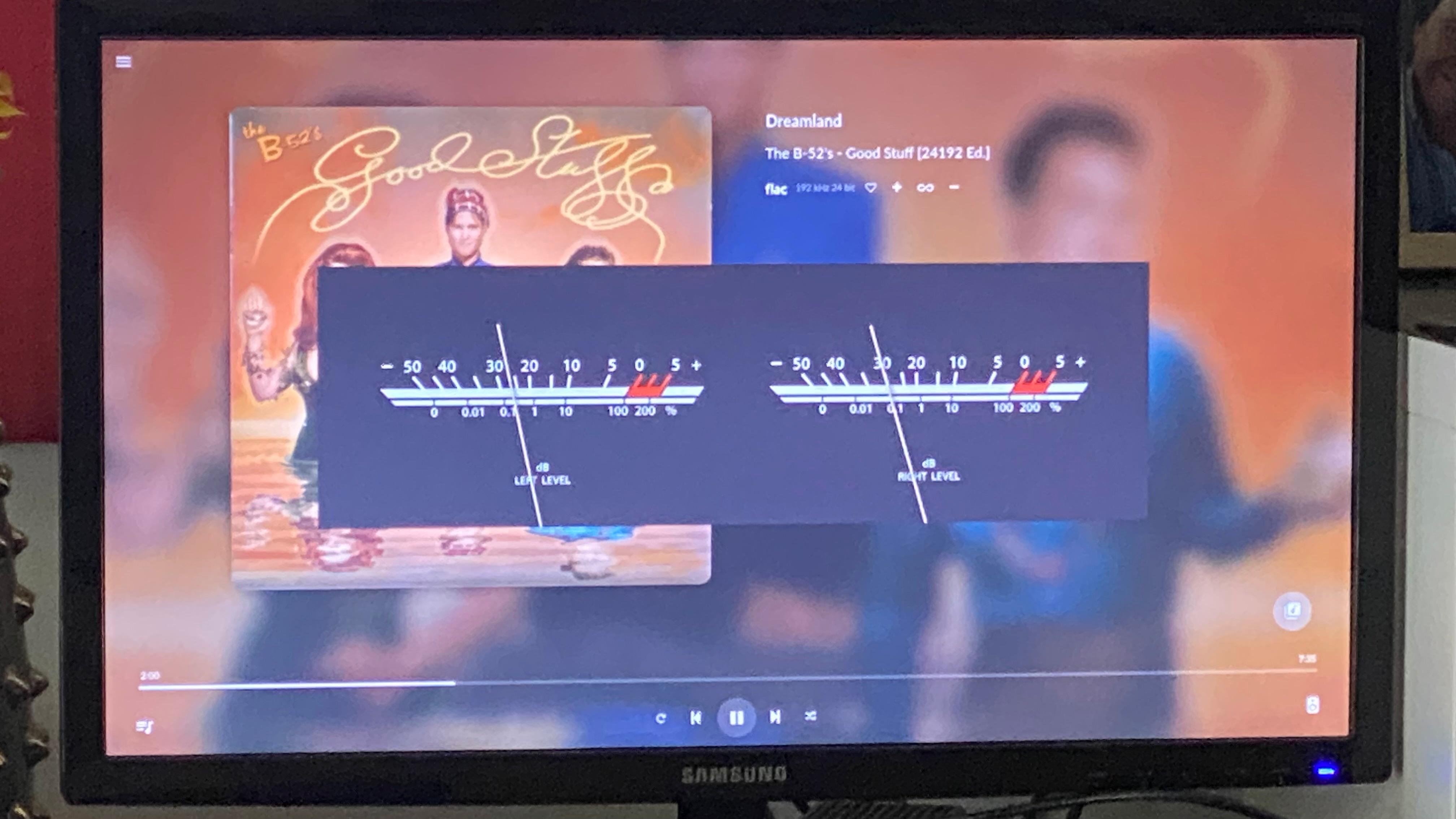

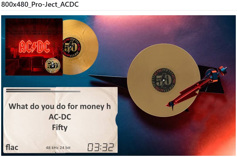

After several days of research, I finally learned how to make my own skin, thank you all
Will you gonna share it via github?
I don’t have a github account. If you have an email address, I can send it to you.The current resolution is 1280X582, I don’t know if it is suitable for your screen.
Just wait a little longer. You won’t be disappointed. There will be brand new skins.

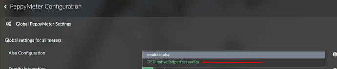

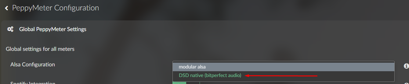

Did you set Modular Alsa In peppy, change it to DSD native.

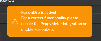

With that option it works but… whenever I enable FusionDSP integration i cannot choose anymore and get back to 48K. If I disable that option it works again (96K).

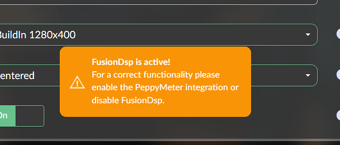

I get this warning but all seems to work anyway… (Peppymeter & FusionDSP):

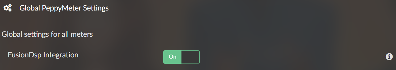

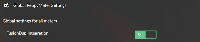

You need to enable the DSP setting in the Peppy plugin:
But it seems FusionDSP and Peppy don’t go well together.

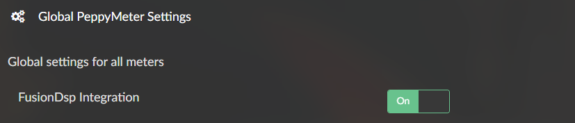

You can try this sequence:
When making changes to FusionDSP settings while using PeppyMeter, follow this sequence:
  1. Go to PeppyMeter settings
  2. Turn OFF “FusionDSP Integration”
  3. Make your changes in FusionDSP (sample rate, filters, etc.)
  4. Return to PeppyMeter settings
  5. Turn ON “FusionDSP Integration”

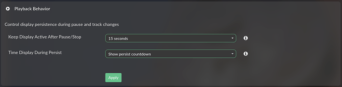

PeppyMeter: Display Persistence Feature
New option in Playback Behavior settings - “Keep display active after pause/stop”
What it does: Configurable delay (15s/30s/1m/2m/5m) before PeppyMeter shuts down when playback pauses or stops. Eliminates screen flicker during track changes caused by Volumio’s stop-play sequence on next/prev.
Time display options:
  • Freeze: Shows track time at moment of pause
  • Countdown: Shows time until display turns off (orange)
Technical:
  • JS timer delays /tmp/peppyrunning flag removal
  • Python stays alive, meters idle naturally on silence
  • Animations continue smoothly through volatile track transitions
Default: 30 seconds, enabled.
