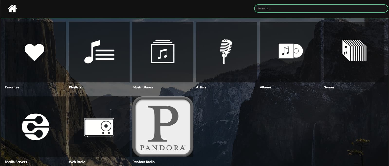

@truckershitch Thanks for the update sorting options in 2.10.
I’ve notice the Pandora icon on the Volumio home screen is oversized compared to the others. Minor cosmetic issue but I thought you might want to address in a update for consistency.
You’re welcome. :slight_smile:
Thanks for that. I meant to fix that a long time ago but I forgot about it.
Done. I reduced the icon by 55%. I think that’s a good size. Version 2.10.2 pushed.

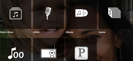

To anyone watching: I tried to use some newer Font Awesome icons but I think that Volumio uses an older version of the library, so the choices are limited. The four sort descriptions / categories are a bit wordy but I think they’re clear.
@ truckershitch - Just updated to 2.10.2 and it looks great!!
Thank you :+1:t4: :+1:t4:

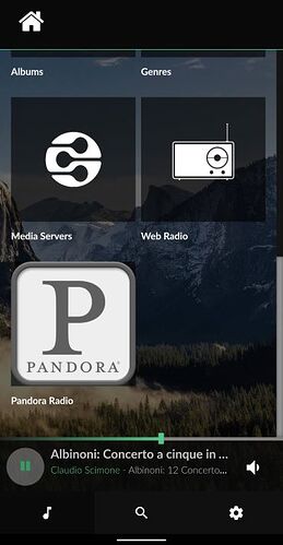

@truckershitch Thanks for the icon update. Looks good in my browsers (desktop and mobile) but it still appears oversized in the official Android app. Any idea why?
Well, right after posting this I tried force stop, clearing cache AND clearing storage in the app. Now the icon is the expected size. Posting for anyone else who runs into this.
@davestlou Thanks for the fix. Those darn caches never quite flush the way you want them to. :stuck_out_tongue:

@davestlou Yes, I saw that on the web interface and clearing cache fixed it but I was still getting the old (large) icon with the iOS Volumio app. Uninstalling and reinstalling the app, however, fixed that too.
