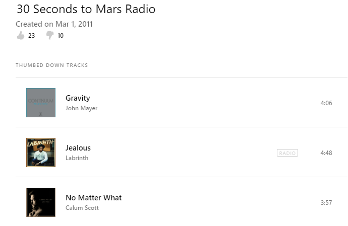

@truckershitch , that worked perfectly! Looks like the callMetod call is working:
However I am not seeing on my thumbs down list in Pandora. It should be at the top of the list on Pandora’s site.
Thanks again!! Ill look into the anesidora API.
