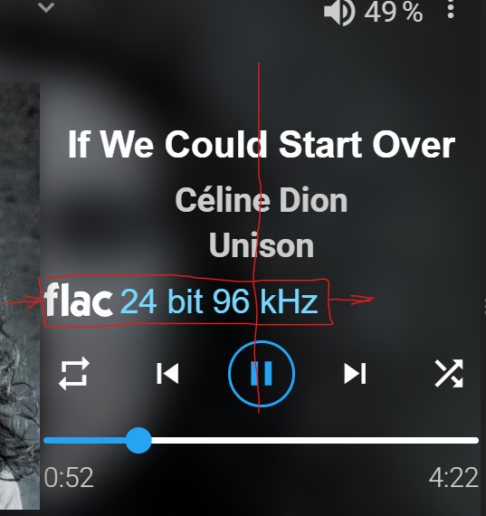

In Version 1.1.0(test), “Sample Rate, Bit Depth…” when setting Allignment (Horisontal) = Center is actually aligned left.
In Version 1.0.6(stable) there is no such problem
