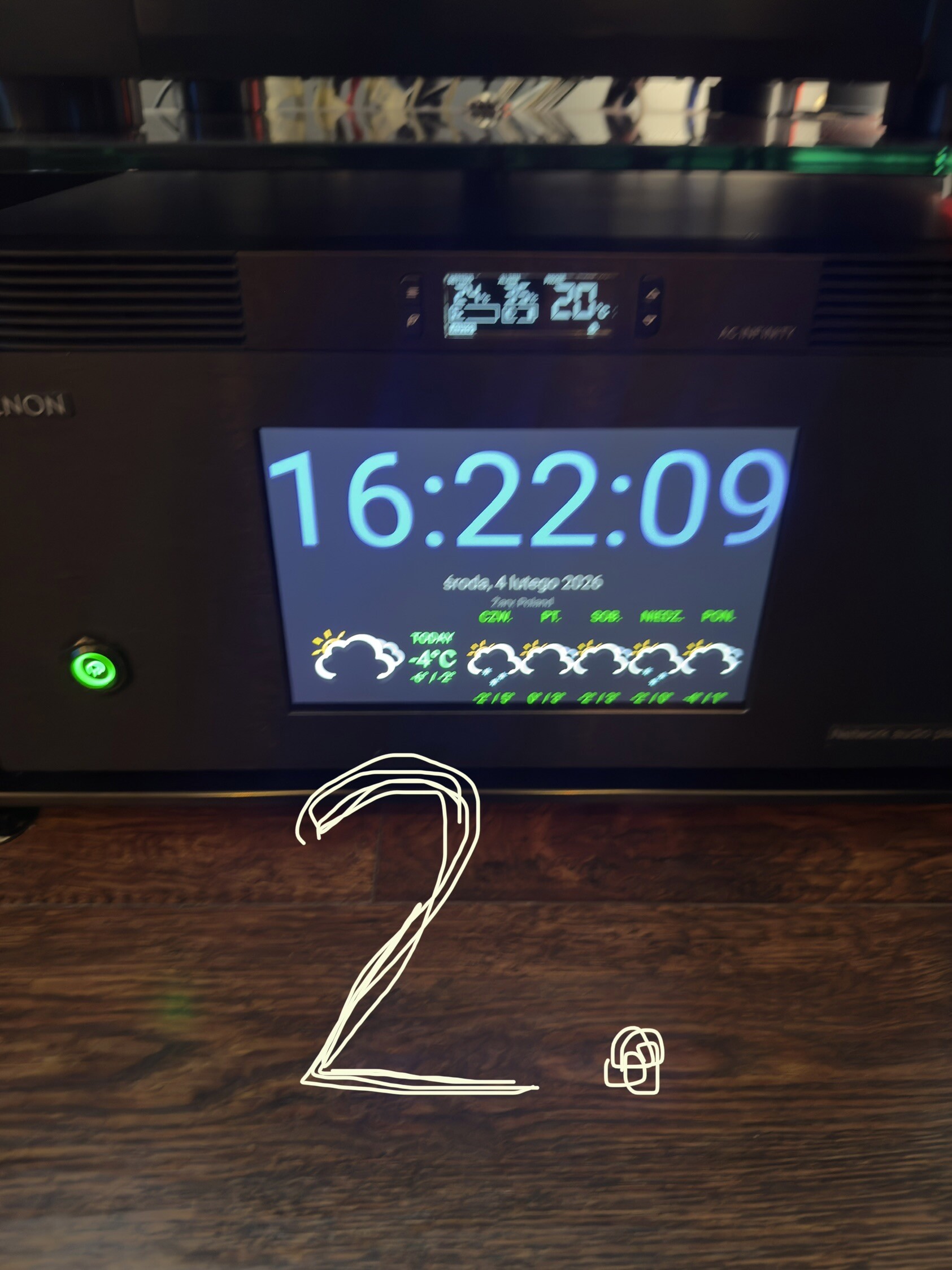

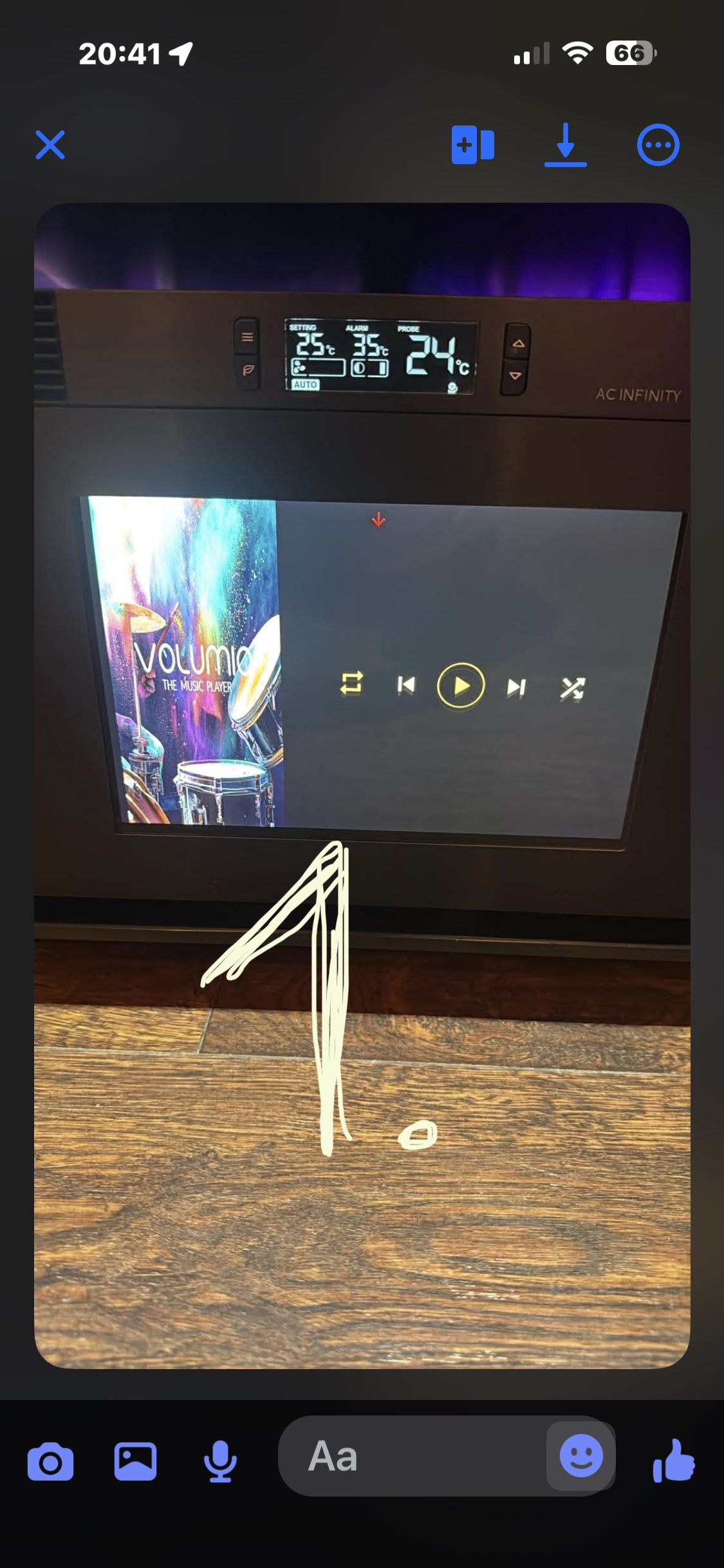

I’m a complete noob, I’ve set up a screen like this when the music isn’t playing (photo 2), but when I turn on my Raspberry Pi, this screen appears (photo 1) (1-2 in the photos), I have to turn on the music and press pause to make the screen (photo 2) appear. How can I make the screen with (photo 2) appear immediately? Thanks in advance for your help.
You shouldn’t need to start and stop the music. You need to just wait for the active screen to time out. Think it is set at 30 seconds as default, but you can reduce this down to 10 seconds.
In the app settings scroll down to “Idle Screen” and change the setting.
I have it set to 10 but it’s exactly the same, after starting it appears for a moment (photo 2) and stays there permanently (photo 1). I can wait even 5 minutes and nothing
What are you “start up” settings. I have set “Now Playing Basic View” and “On”
I also have basic view, but idle screen activated is off.
I suggest turning that on then :slight_smile:
No, works fine for me. Screen still displays time/weather idle screen on start-up and 10 seconds after last track finishes.
Edit: but I’ll try it anyhow!
Sorry, I responded without checking, I thought I was responding to the person with the problem.
