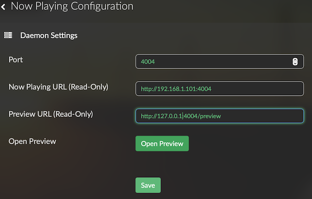

Daemon settings do not saves. I input 192.168.1.101 (my Volumio) in both fields push save - saved - push settings again and my 192. again 127… What I have to do? Thanx.
I found, after today updating all 4 my players, this issue does exist here too. Both URL’s can’t be changed.
So @VictorDUA is not alone…
When editing, hitting save acts normal, but after an F5 browser refresh it is back to the internal IP.
Catch the bug!
are you not reading, it’s saying read only so there is no editing…
it’s showing the local url with the port nothing more
127.0.0.0 is for a local display only!
You have use the IP of your volumio device when you want to display the page on your computer
Once again: with 127.0.0.0 it shows on LCD nothing. But it is doesn’t matter - Touch Screen plugin working just beautifully. Adjusting the scale easy tune the look. But that’s off-topic.
Did you enable “Now Playing” in the settings menu, as I get the impression you didn’t do this?

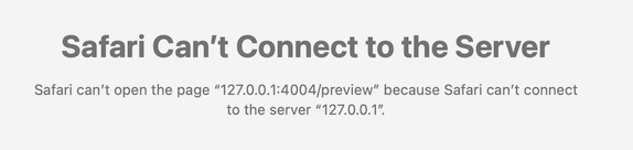

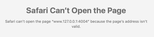

The 2 ip’s within Volumio, that can be accessed from a Safari (assuming 192.168.1.101 is your Volumio device):
http://192.168.1.101:4004
http://192.168.1.101:4004/preview
Accessing 127.0.0.1 from safari won’t work, as this ip is the localhost from the volumio device.

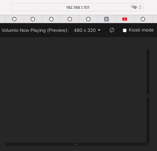

Yes. Blank screen. Dark, but blank. Touch Screen must be on or off?
With http://192.168.1.101:4004/preview I can see space for preview but not the preview itself.

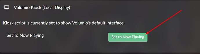

Now playing is intended for a local display, so the local display must be on, with the plugin “Touch Display” on.
Since I see only screenshots from Safari, do you have a local display installed on your Volumio Device?
