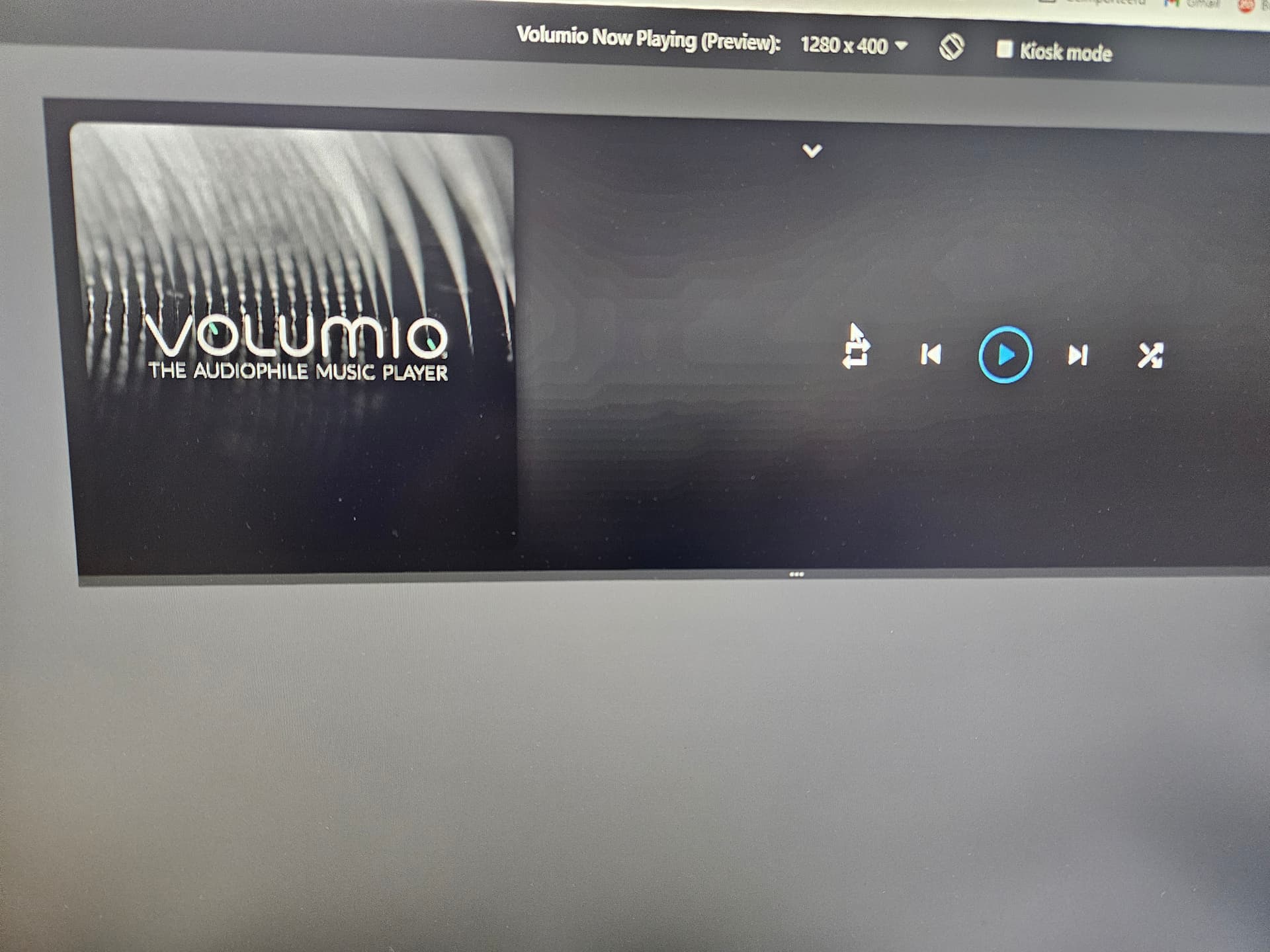

if I switch off Now Playing the albumart.png and jpg is okay, when I switch it on the old albumart is replaced by the new one. see pictures.
1 now playing switch off correct
2 now playing switch on fault
3 now playing switch on (preview) correct
Please correct your power supply, all your screenshots show under voltage (yellow lighting) .
This will make your installation unreliable and unrecoverable crashes.

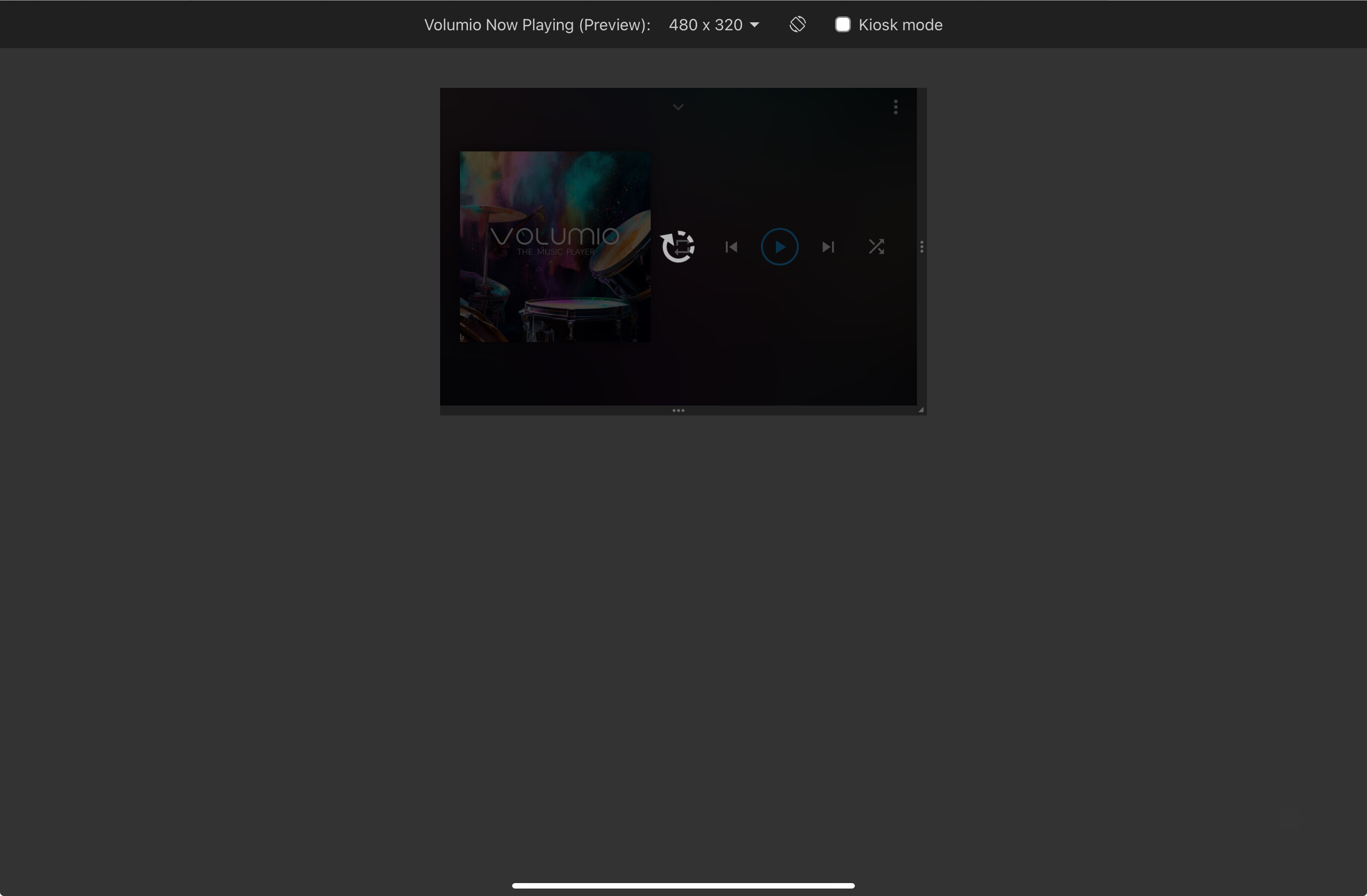

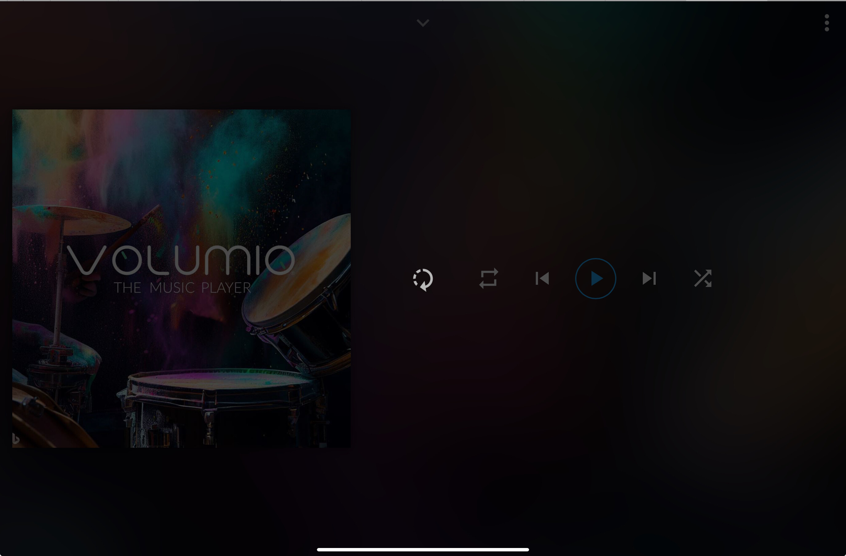

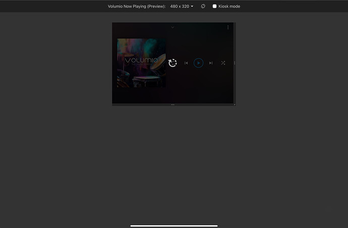

Hi gurus, hope you are fine.
I can install both stable version of the „Now Playing“ plugin (0.75 and 0.73) but none of them seems to work?
If I call the „normal“ as well as the „preview“ URL at port 4004 the screen flickers and a rotating arrow is shown.
Is this „normal“ behaviour?
I can select the resolution drop-down in the top but nothing else.
I‘m on a raspi 5, newest FW/OS, NVME, HIFIBerry DAC2 pro, newest Volumio 3.795.
Just tried a reboot with installed plugin (which gave me five bad minutes because system did NOT come back. Hard reset with switching off, switching power off and switching power on again - at least reanimated the system and my Volumio is up again).
But reboot did not change situation. Same behaviour as in shown pictures.
Any hint/idea?
Thanks a LOT!
Regards,
Ralf
Any Idea?
No clue yet, as it works without problems here.
Please post a log
and the output of:
cat /boot/config.txt
cat /boot/userconfig.txt
The Manyfest UI is working without issues?
Dear @Wheaten, thanks for stepping in!
volumio@korellmusik:~$ cat /boot/config.txt
### DO NOT EDIT THIS FILE ###
initramfs volumio.initrd
gpu_mem=128
gpu_mem_256=32
gpu_mem_512=32
gpu_mem_1024=128
max_usb_current=1
[pi5]
usb_max_current_enable=1
[all]
include volumioconfig.txt
include userconfig.txt
dtoverlay=hifiberry-dacplus-pro
volumio@korellmusik:~$ cat /boot/userconfig.txt
# Power-LED und Status LED vom Raspberry Pi abschalten
dtparam=pwr_led_trigger=default-on
dtparam=pwr_led_activelow=off
dtparam=act_led_trigger=none
dtparam=act_led_activelow=off
dtparam=eth_led0=4
dtparam=eth_led1=4
[all]
display_auto_detect=1
#display 7Zoll
# raspi 4
#dtoverlay=vc4-kms-v3d-pi4,nohdmi
#dtoverlay=vc4-kms-dsi-ili9881-7inch
#Raspi 5:
display_lcd_rotate=1
display_hdmi_rotate=1
logfile in: http://logs.volumio.org/volumio/WPdI6Rw.html
