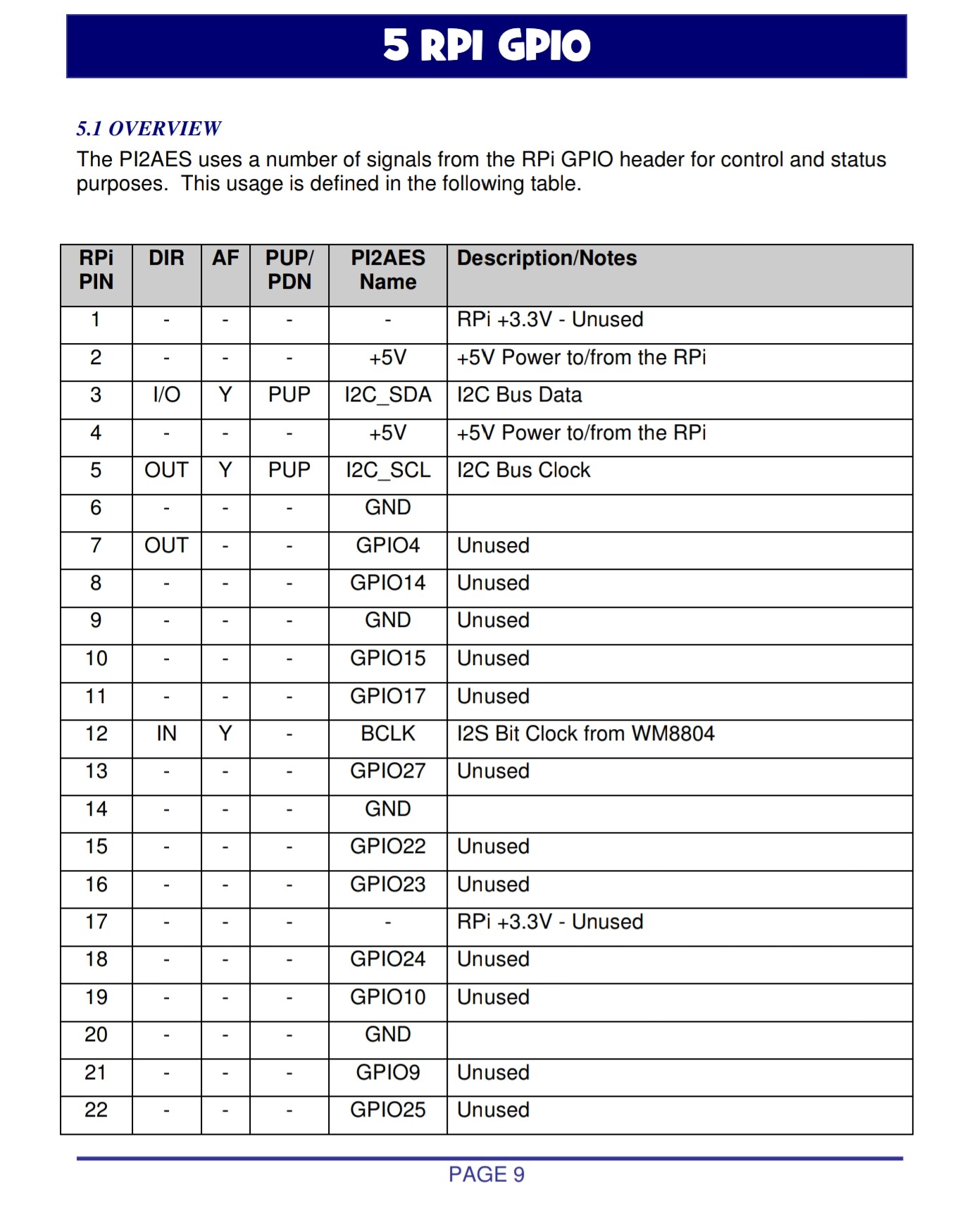

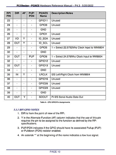

I have a Pi2aes card. Is it possible to connect an OLED mpd to its pins (4)? (soldering from below)
TY
Yes, it should be fine as the I2C bus can be used for multiple devices :slight_smile:
e.g. PIN
1, gnd, 28, 27 - right?
or
1,3,5,GND?
Yas sir

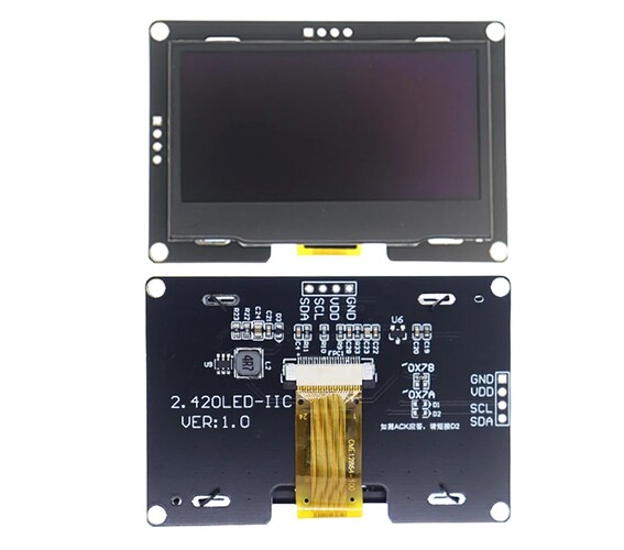

Hello everyone,
I’m trying to get an OLED LCD screen to work, SSD1309 2.4" I2C 128x64
With an arduino it works, but not with the MDP OLED plugin.
I installed the plugin via the volumio web interface. I scanned the I2C address and set it in the plugin options but nothing happened.
Can you help me?
Screenshot 2024-07-31 at 10-33-49 TZT-Écran LCD OLED technologie SSD1309 2.4 7 broches éventuelles I_IIC I2C interface série pour Ardu37UNO R3 C51 2.42 pouces 128 pouces 12864x64 - AliExpress 502
Try different screen options.
Do I have to restart each time?
Nah, no need to restart :+1:
