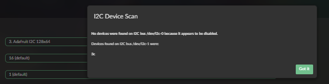

Hi can you help me how to fix this i am having a hard time to get work with this oled i2c
Using rpi 3b+ with a volumio ver 3.703
And the wiring instruct from mpd oled plugin - i2c wiring.
And i use to do some command instructions from github but it seems not working it not show a display.
Thanks for understanding.
Not sure what commands you’ve entered from git, but I can’t support it.
Please download Volumio (lastest stable Version: V3.742) and flash it to a new SD-Card. After initial installation, only install MPD_OLED from the plugin store. As this is working.

Thank you wheaten! I manage to work with oled thanks to you. The oled i used before is defective. So i bought new one t.
