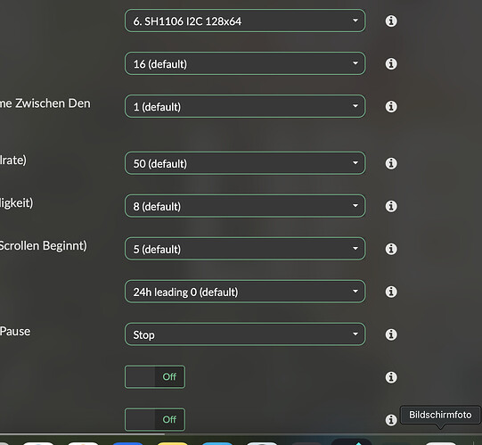

no Sir…I’m good with a soldering iron and machines…But I can’t be used for programming…I went for chalk on this topic… ![]()
If it’s there in stop mode too, it might be a program error, as I see the same in the link you provided.
Hi Thor
It looks like the screen image has also been shifted to the right
Have you configured the plugin to use the Adafruit (SSD1306) driver?
Adrian.
In that case, try using “3. Adafruit…”, as this is for SSD1306 displays, and should be compatible with your SD1309 display.
Adrian.
