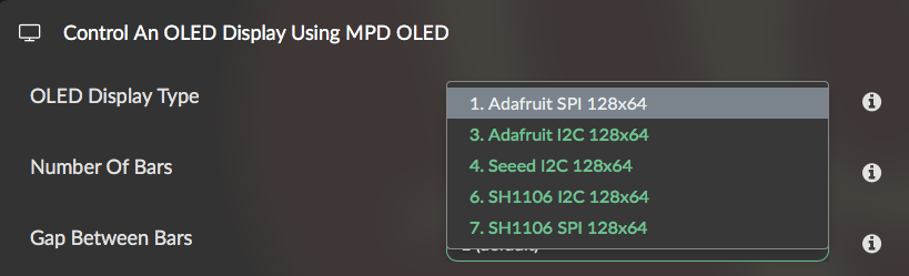

question, is there a certain thought behind this, it goes from 1 to 3.
