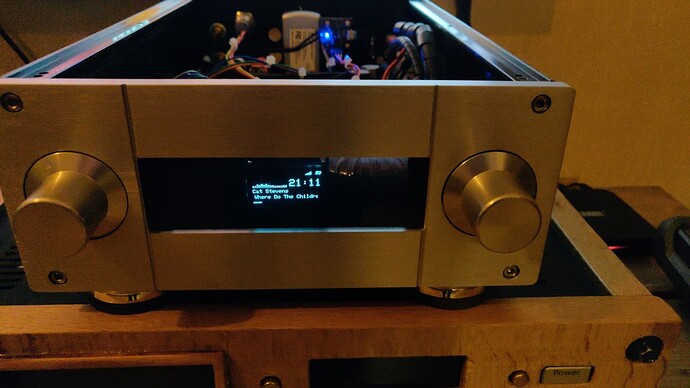

I myself have three streamer/DACs and this one belongs to my nephew and was broken, under Voltage due to a defective transistor and cables that were no longer good

only a problem now, the rotary encoder no longer works.
somehow the rotary and oled can only work together.
and I think that is stated here as well.
only way is to use the volumio rotary encoder plug-in and solder it all on the board.
euh, you break in on the code for Sabre “OLED + Rotary Encoder”, replaced it with MPD_OLED which doesn’t include the decoder?
Maybe this will do the trick:
If not fall back to the original code:
will try this afternoon.
by the way on the left side of the board are extra i2c-SCK/SDA pinout and that is where the screen is now attached (mpd works) originally they are in a different place exactly next to the rotary pins.
if you’re using the SPI pins for your rotary encoder, please remove “dtparam=spi=on” from /boot/userconfig.txt
somehow the Rotary encoder and OLED display only work together. Tried all options above but without success.
I’ll just leave it that way for now.
What plugin controls them both?
this is built in as standard.
mpd plugin works fine but after that the Rotary encoder stops working and no matter what I try I get the Rotary not working.
what might be possible is a second OLED screen for standard and mpd plugin.
Left bottom 4 black kabels Rotary en left top OLED.
in this configuration the mpd plugin works but Rotary encoder does not work.
This is the standard configuration and dus not work with mpd plugin.
