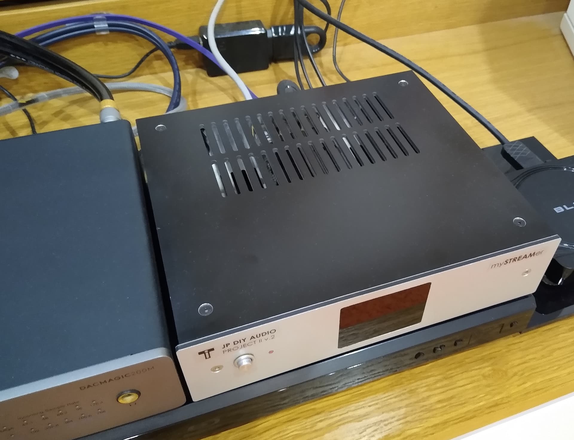

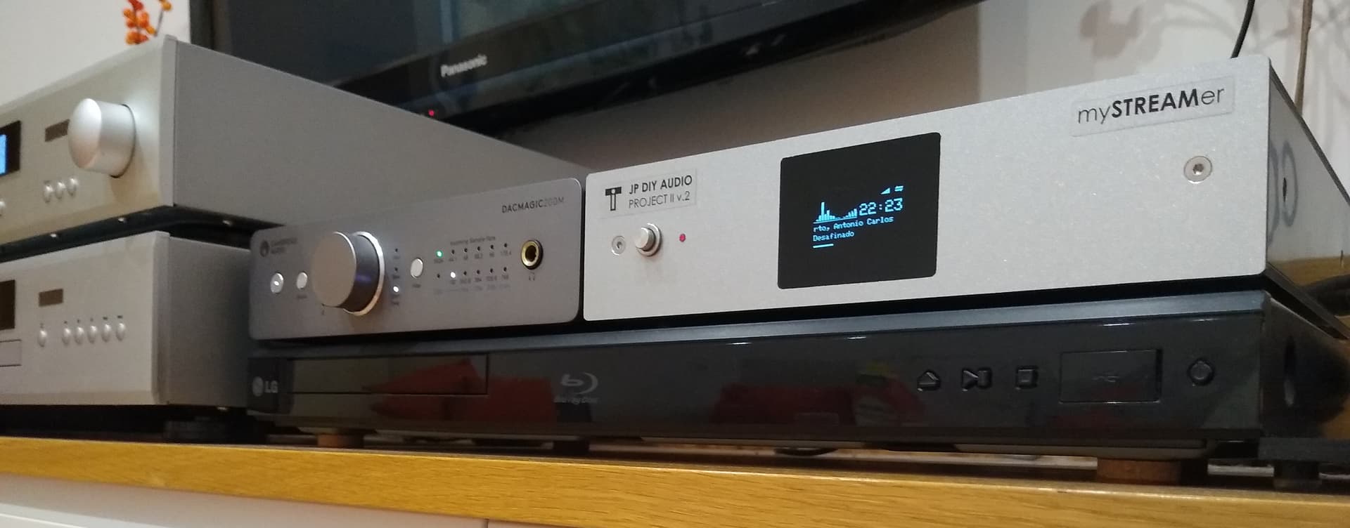

You’re welcome! That’s a very cool setup! :sunglasses::heart_eyes::clap::clap::clap:
Oooh… nice chassis! Look how clean that faceplate is! Is that laser cut?
Thank you for your interest.
The main parts of my streamer case are laser cut from dibond material. The hole for the OLED display too.
The smaller pieces are handmade by me.
Przepraszam, myliłem się😧. Dibond został wycięty frezem

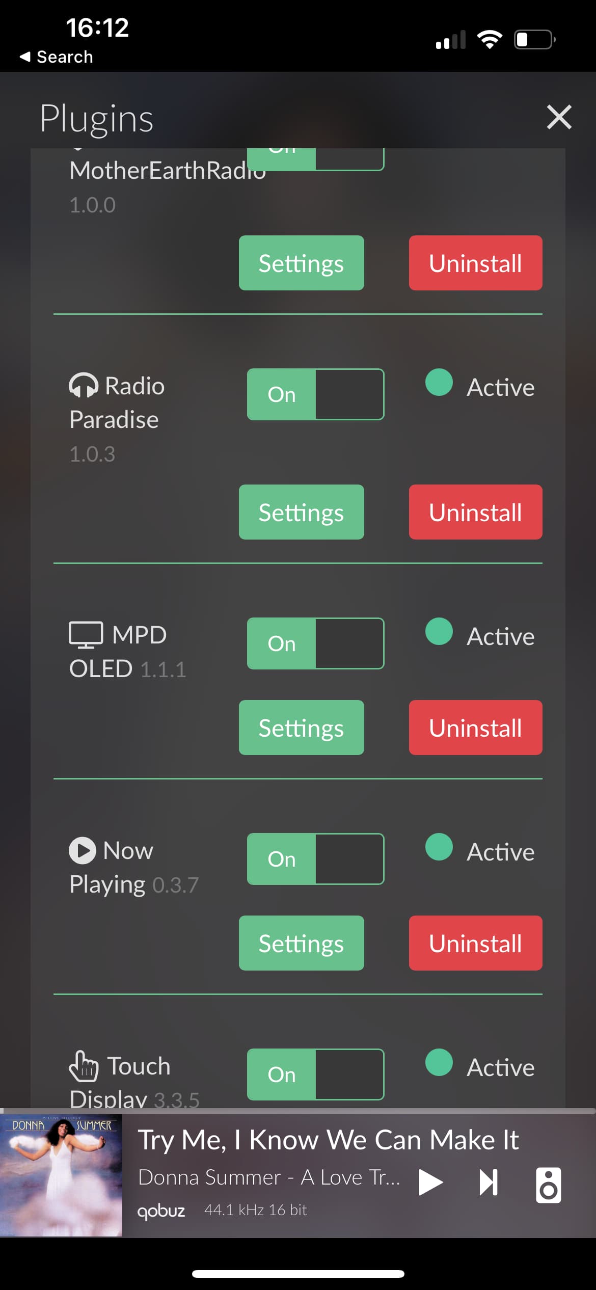

I have installed v 1.018 and I am facing next behaviour :
Everything is ok until I have stopped the music . Then watch appear then after 1h if I start the music the screen change to play but the spectrum is not started . I need to on/off the plug-in in order to fix it .
I am on latest Volumio version 3
Peppy meter plugin is not installed .
I am listening on qobuz
http://logs.volumio.org/volumio/MNRahQW.html
I would first upgrade to the latest stable release V.1.1.1, instead of reporting issues with an older release.
This issue is fixed with the latest release as you can read in this topic.
Hi ,
Sorry , I am on latest version 1.1.1. My mistake with v 1.018
Haven’t been able to reproduce this, or even seen it.
Let’s see what happens over 40 minutes, as then the box has been idle for 70 minutes.
[edit]
After waiting 70 minutes, MPD_OLED just start without issues. So I will not be able to find a root cause. Maybe posting a log when it happens might help the developers.
