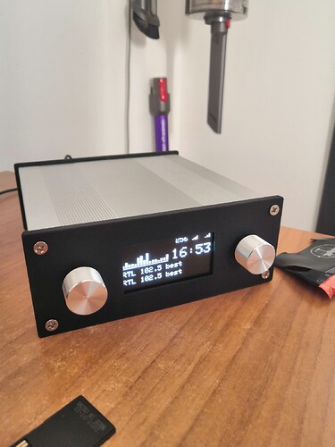

Finally…
Nice! Is that running volumio 3? Where did you get the case from?
I had some problems with volumio 3 and oled. It’s running volumio 2. Case from Amazon. Front and back panel from 3d printing.

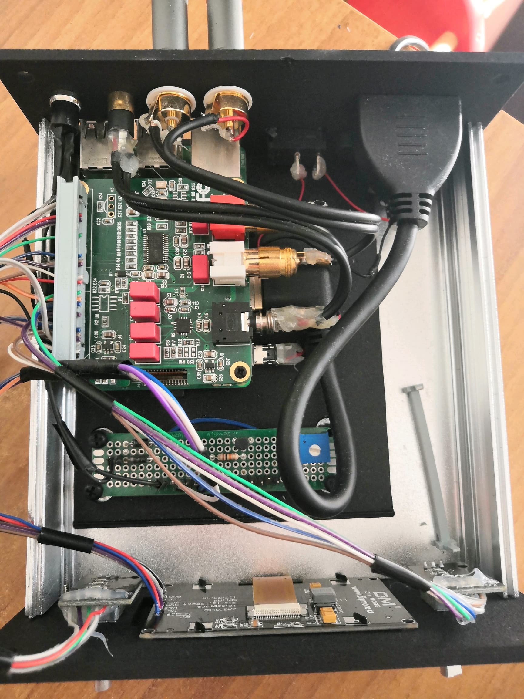

I have Oled Display with SSD1309 driver IC, SPI/I2C
Could this be appropriate for MPD Oled?
Raspberry PI 3B+
Oled_SSD1309
Balbuze did help me and other people had managed to get it working, but I couldn’t get it working whatever I did. I might try again when I get chance!
Yeah, I have one of these! I think I changed it to I2C mode for it to work. I removed R4 and bridged R5 and R3

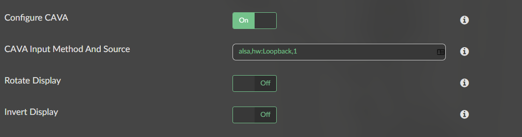

As FusionDsp is now stable enough, I took time to make some other plugin to work with…and of course without!
So I updated mpd_oled made by @supercrab to do so.
It uses now a specific alsa component developped by volumio team : “volumiofifo”. So no more CAVA settings in the plugin.
All sources should work with that (spotify, Tidal etc…)
I moved category to “user_interface” too.
Feel free to test…
:stuck_out_tongue_winking_eye:
mpd_oled.zip (388,8 Ko)
To install, copy the zip on your device and from its location
mkdir mp
miniunzip mpd_oled -d ./mp
cd mp
volumio plugin install
cd ..
rm -Rf mp
enjoy
