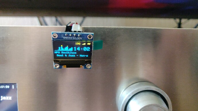

Thanks Balbuze! I’ll get on this and test it out on my system!
With BassFly-uHat from @Darmur
Rpi3 + FusionDsp
I can confirm the plugin from Balbuze works like a charm.
any chance to publish it in the plugin store?
As soon as I get it working on my rig I’ll publish it

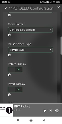

There is still some things to fix:
Mod oled must be enabled at startup (set to true instead of false in onstart function).
On my system, it needs to to be started by pressing ‘save’ innth plugin. If not, an arbitrary hournis displayed and it is not triggered by play.
Hi @balbuze
weird, it does start on my system, I don’t have to enable by pressing Save in the plugin settings
I use it on a Rpi3. I suspect the speed to be in cause, but maybe it is not that…
Same here, Only had some strange issues during install, but it does start on all three systems automatically. (rPi-4, rev 1.4) Even in combination with Peppy_meter.
I am testing it on a RPi0-2
Magic!
