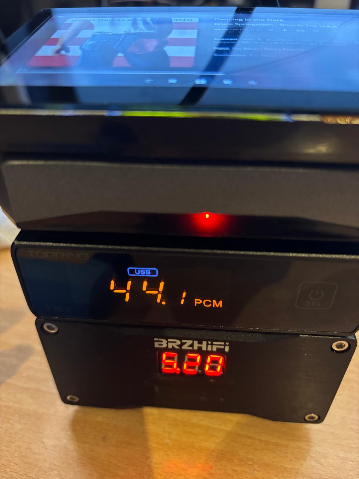

I did a fresh install of 3.799 on an USB 3 key on a Pi4b. Other than that it won’t reboot and need hard reset, the other major issue I have appears to be with PeppyMeter Basic. The pi is connected to my DAC via USB. When I activate this plugin, of course, also while using FusionDSP, everything comes out as 44.1kHz…when before this update, PeppyMeter Basic did not impede in the actual playing of music. I found this out after doing a bunch of troubleshooting and reinstalling again.
Turning off the plugin and only this plugin, returns music playback to the way it used to be. I also tried the old 0.2 beta and it’s the same. So to be clear, I don’t really think it’s an issue with the plug-in, but is it then an issue with the 3.799 update?

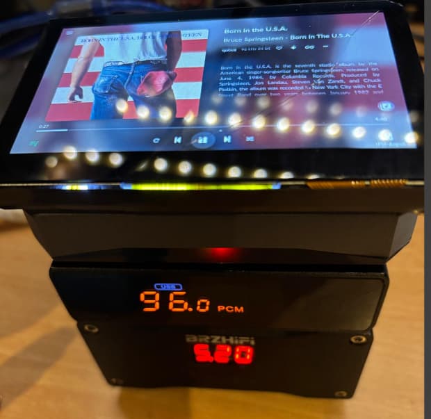

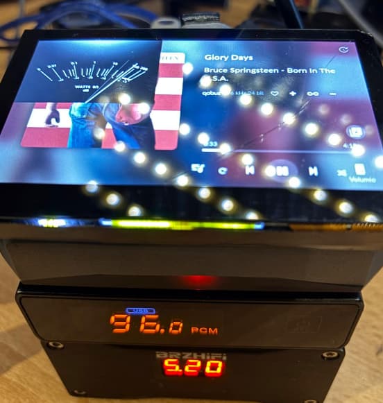

- Your 2nd point I can confirm. Playing a track 96kHz/24bits shows as 44.1kHz on the DAC.
-{,"samplerate":"96 kHz","bitdepth":"24"}
With Peppy_Meter_Basic:
Without Peppy_Meter_Basic:
Volumio V3.799, V3.795, V.3.779 Plugin V0.0.3 same issue.
Volumio V3.799, V3.779, Plugin V0.0.1 is working.

Please use V0.0.1 for the time being, which seems to work fine for me…
Last change made in the plugin v0.0.3 to fix non moving needs lead to the sample rate issue…
I’m trying to fix both issues.
As @Wheaten suggested, use v0.0.1 by waiting the fix.
