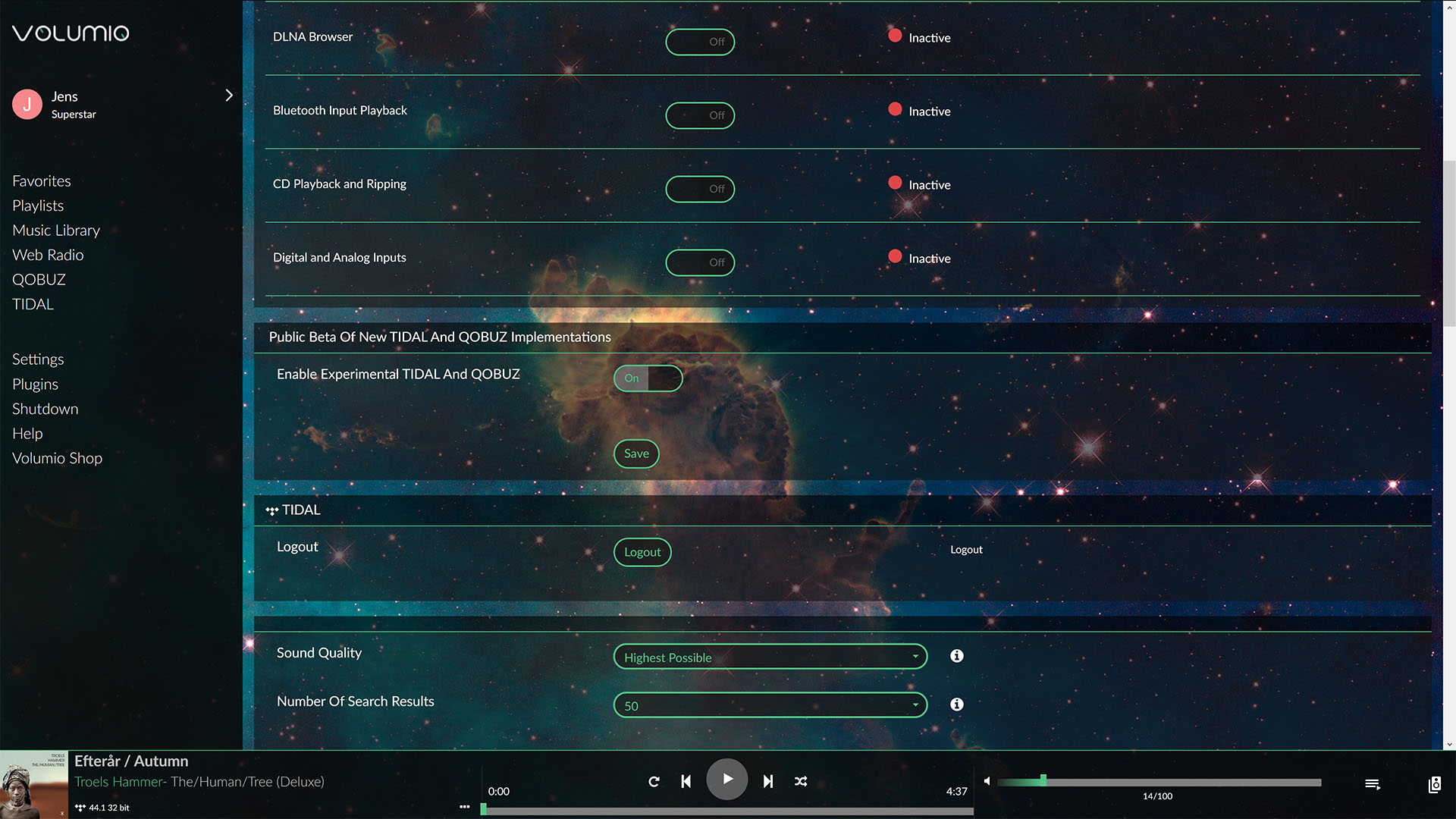

Hi Michelangelo, noob question, disable test mode means switching experimental tidal and qobuz off? And just login from standard tidal Integration GUI in sources?
I have updated to 2.853. 2.852 still has issues with my volumio playlist consisting of various songs added from tidal. It will stop at song no 16, then show it is still playing song 16 but there’s no sound and the queue shows the green arrow playing next songs. Quick resolution Is to reboot but if I leave it for hours, it will recover when I try to play other tracks. Without reboot I cannot play other tracks. Screenshots attached for easier understanding…song 16 is what’s up.
no. switching experimental tidal and qobuz on/off is in options/sources.
No I meant to disable TEST MODE for volumio updates from /dev page.
Keep the experimental tidal and qobuz on from sources
