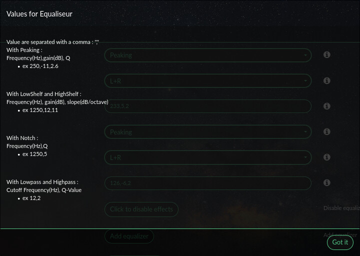

hello,
A parametric EQ is used to adjust the response of you system.
It requires a measure with a special mic for that (such as minidsp UMIK-1 or other brand). Then with a software like REW you can visualize where apply corrections.
So, there no value I can give you to suit your system. To test I could say PEAKING, 2000,-10,0.5
Other case, you use an headphone. There is a very nice database with EQ based on measure for plenty of models : GitHub - jaakkopasanen/AutoEq: Automatic headphone equalization from frequency responses You select your model and report value in the EQ.
I plan to use parametric EQ soon but I just discover how it works. If I well understand, “PEAKING, 2000,-10,0.5” means “Filter, Frequency, Gain, Q” ? Am I right ?
Yes, I realize something was wrong in the UI. I corrected it and now when you press the small i at the right of the eq line, you’ll get
Nice
