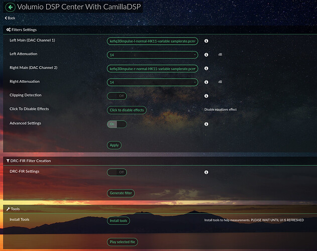

Well, next step… A Drc Digital room correction plugin based on CamillaDsp.
It allows to use FIR filters, with automatic type detection, clipping detection.
Supported types :
text- 32/64 bits floats line (.txt) in rephase
S16_LE- 16 bits LPCM mono (.wav) in rePhase
S24_LE- 24 bits LPCM mono (.wav) in rePhase
S24_LE- 32 bits LPCM mono (.wav) in rePhase
FLOAT_LE- 32 bits floating point (.pcm)
FLOAT64_LE- 64 bits mono (.wav) from Acourate
FLOAT64_LE- 64 bits IEEE-754 (.dbl) in rephase
It also allows to switch automatically filter according to sample rate. A set of filter is provided to test. Just select the 44100Hz and it will switch up to 96000Hz
The plugin also provide a simple interface for DRC-FIR filter creation. Provide an impulse, and the filter is generated in a minute.
The tools section provides tools to help measurements such as sweep or pink noise.
It is still in DEV. Please careful when detecting clipping as it will play a 0dB plink noise…(so at full volume).
Of course feedback welcome
