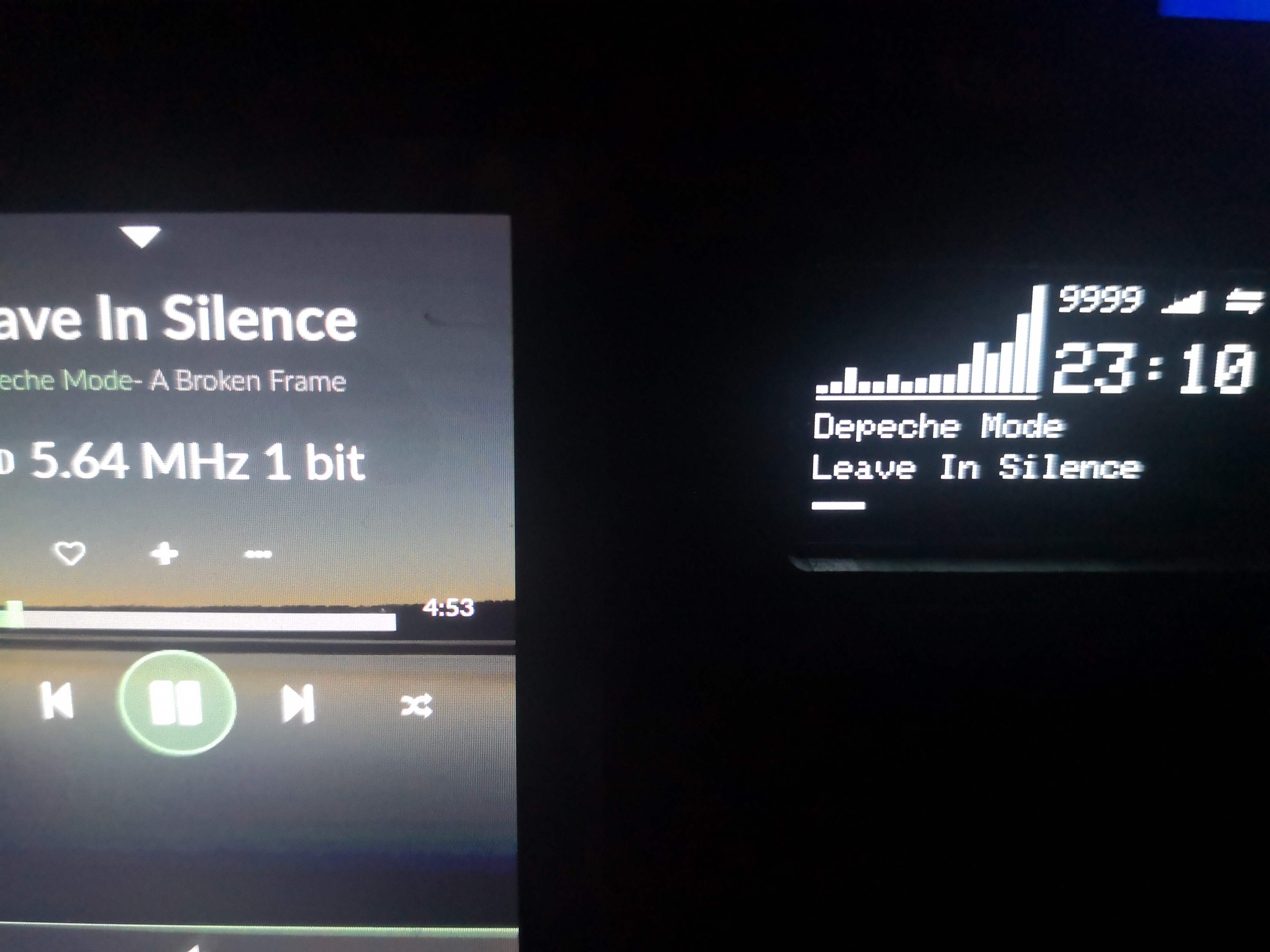

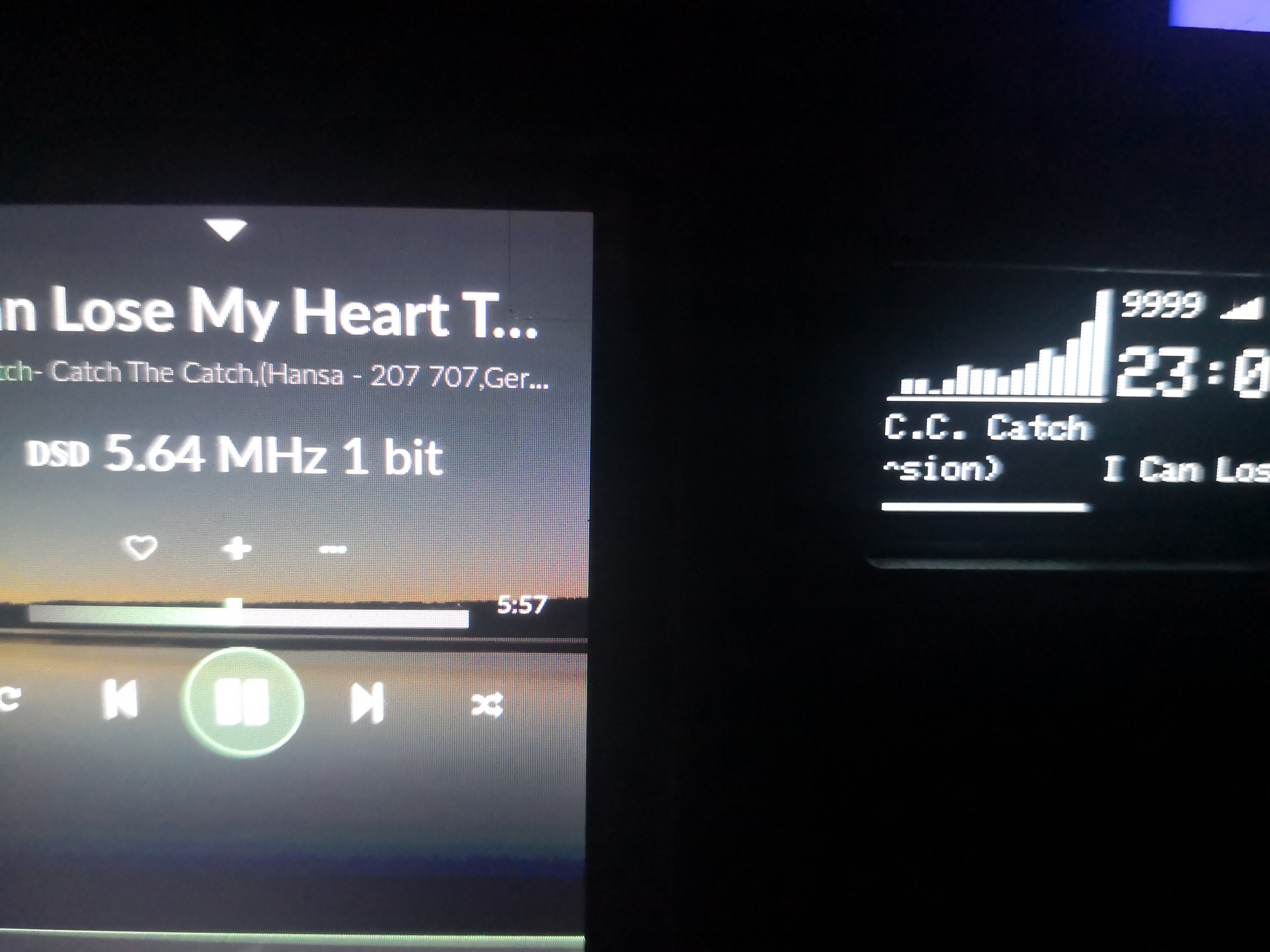

What do you think about this :slight_smile:
On all dsd files I see the wright part of the spectrum, the same bars x somehow the spectrum starts from a default state wich is not 0, lower in left and higher in wright side.
Edit: now is not working :slight_smile: something is weird :smiley:
I have activated and disable the plugin and of course it gave me same error that it când not restart spotify connect service
Wt… Now the bars starting to raise a little bitb:) like they are growing… I guess if I continue to listen only to dsd files the display will full with bars…
