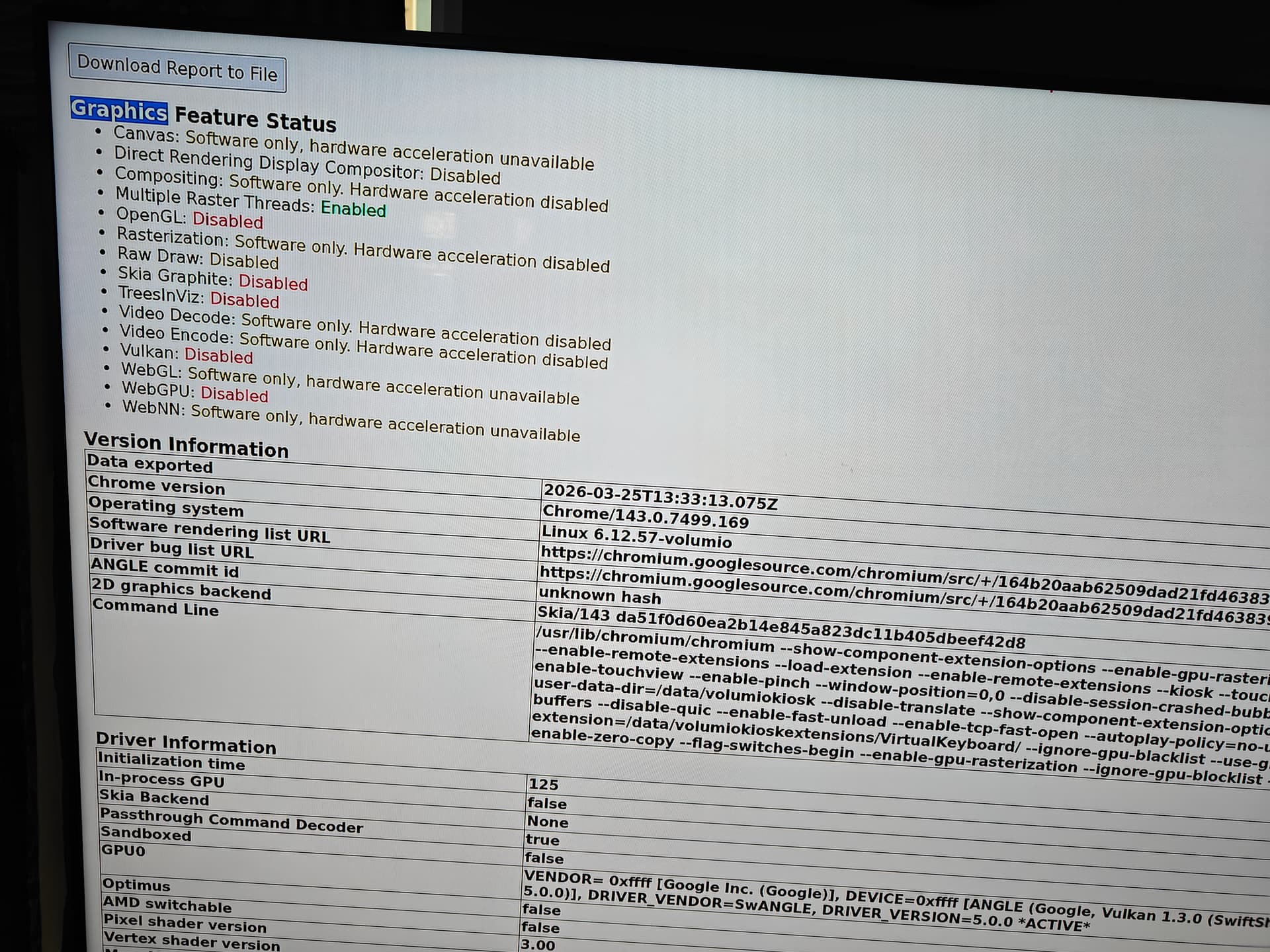

Appreciate the response. I couldn’t find the downloaded report file on the command line. Do you know where the location would be? (attached a screenshot instead)

![IMG20260325083346|666x500](upload://7STZlFudGB5tXPm8CUCsXEPmtSz.jpeg)
Hey @KCAudio,
The chrome://gpu report and the process list tell the full story. There are two separate problems, both clearly visible.
Problem 1 - Chromium is running on SwiftShader (software GPU)
The GPU process command line in your process list shows:
--use-gl=angle --use-angle=swiftshader-webgl
Despite the kiosk script launching Chromium with --use-gl=desktop, Chromium failed to initialise the real Intel GPU and fell back to Google SwiftShader - a pure CPU-based software renderer. The Driver Information section in your chrome://gpu report confirms this:
GPU: VENDOR=0xffff (Google), DEVICE=0xffff
ANGLE (Google, Vulkan 1.3.0 (SwiftShader 5.0.0))
That is SwiftShader, not your Intel UHD 620. Chromium cannot see your real GPU at all. This is why everything in the Graphics Feature Status section says “Software only, hardware acceleration unavailable” - there is no hardware to accelerate with as far as Chromium is concerned.
Problem 2 - --disable-gpu-compositing is explicitly set
Your kiosk launch script includes --disable-gpu-compositing. This flag explicitly prevents GPU compositing even if hardware were available. It is set in the Volumio kiosk startup script and it needs to be removed. However, removing it alone will not fix the problem if Chromium still cannot see the real GPU.
Additionally, --ignore-gpu-blacklist is a deprecated flag. It was renamed to --ignore-gpu-blocklist in Chromium 91. You are running Chromium 143. The old flag is silently ignored.
What needs to happen:

Thank you for the suggestions. The changes are applied, and I restarted the volumio-kios, but chrome://gpu shows exact the same (disabled)
# Start Openbox
openbox-session &
  /usr/bin/chromium \
    --kiosk \
    --touch-events \
    --disable-touch-drag-drop \
    --disable-overlay-scrollbar \
    --enable-touchview \
    --enable-pinch \
    --window-position=0,0 \
    --disable-session-crashed-bubble \
    --disable-infobars \
    --disable-sync \
    --no-first-run \
    --no-sandbox \
    --user-data-dir='/data/volumiokiosk' \
    --disable-translate \
    --show-component-extension-options \
    --disable-background-networking \
    --enable-remote-extensions \
    --enable-native-gpu-memory-buffers \
    --disable-quic \
    --enable-fast-unload \
    --enable-tcp-fast-open \
    --autoplay-policy=no-user-gesture-required \
    --load-extension='/data/volumiokioskextensions/VirtualKeyboard/' \
    --ignore-gpu-blacklist \
    --use-gl=egl \
    --force-gpu-rasterization \
    --enable-zero-copy \
    --ignore-gpu-blocklist \
    http://localhost:3000
Here are the changes. There was no --ignore-gpu-blacklist so I added --ignore-gpu-blocklist
I also want to clarify that the CPU is older gen i3-7130U (Kaby Lake) not sure if it makes a difference.

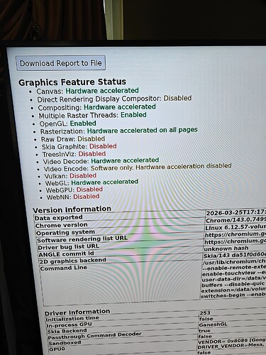

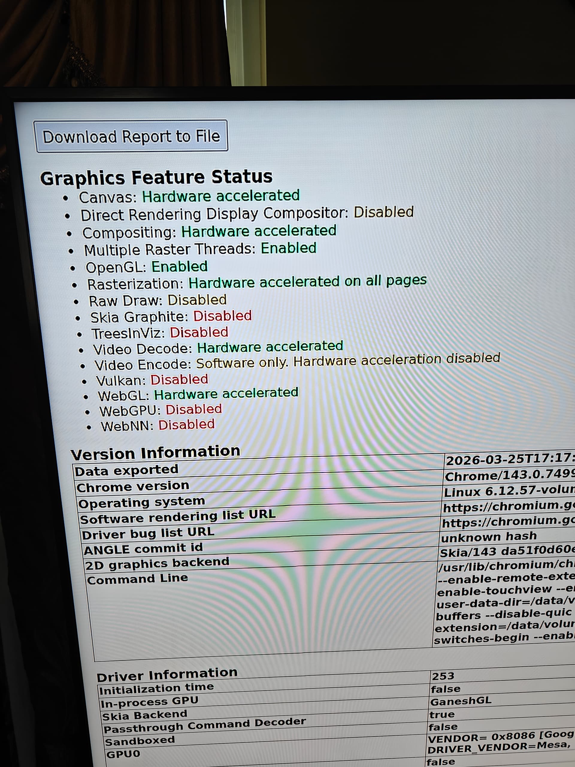

Yes!!! Success!! You are the best :slight_smile: :ok_hand:
The Visualization is noticeably faster. Is there anyway to allocate more memory to make it more faster? I have 5GB unused. Thanks for your help so far.
Hey @KCAudio,
Good to see it working. Canvas, Compositing, Rasterization, Video Decode, and WebGL all on hardware now.
Regarding memory - the Intel UHD 620 is integrated graphics sharing system RAM. GPU memory allocation is controlled by the BIOS, not the OS. Check your Chromebox BIOS settings for a “DVMT Pre-Allocated” or “GPU Memory” option - increasing it from the default (usually 64MB or 128MB) to 256MB or higher would give the GPU more dedicated allocation. The GPU can also dynamically use system RAM beyond the pre-allocated amount, which is what it is already doing.
On the Chromium side, you already have --enable-native-gpu-memory-buffers and --enable-zero-copy in your flags, which are the relevant memory optimisation flags.
If the visualiser is still not as smooth as you want, share what frame rates you are seeing and at what resolution - there may be other optimisations to look at.
