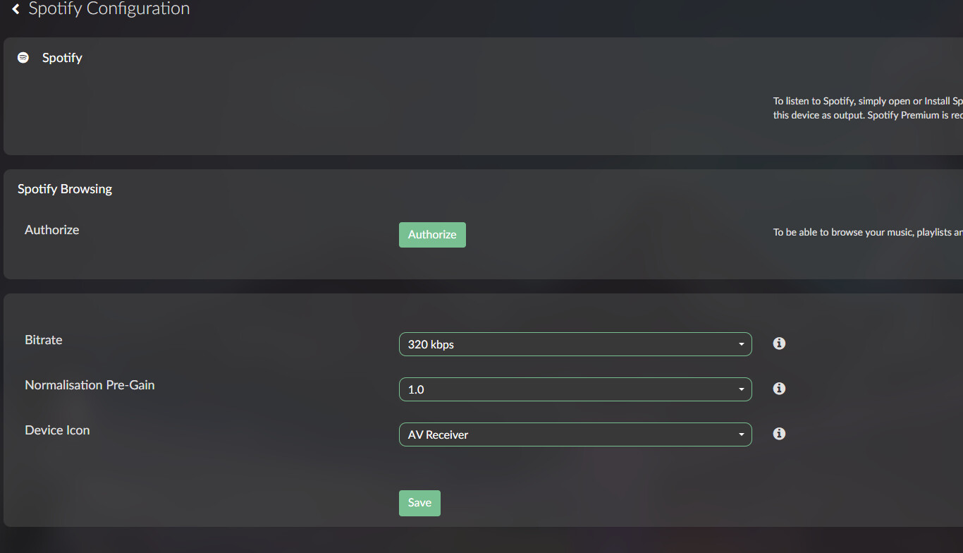

I don’t even have multiuser device as an option:
