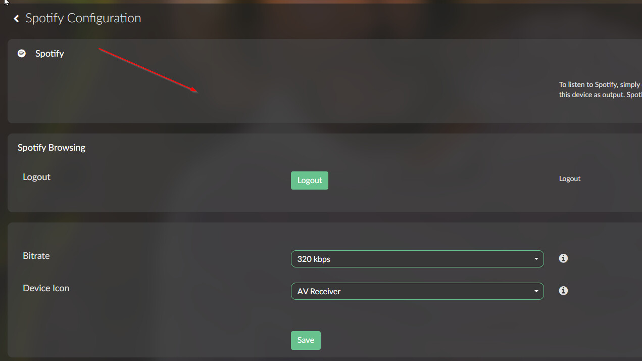

Hi, in the old spotify plugin version I was able to see the spotify user in the plugin, now I am not able to see this.
Could you please bring this feature back?

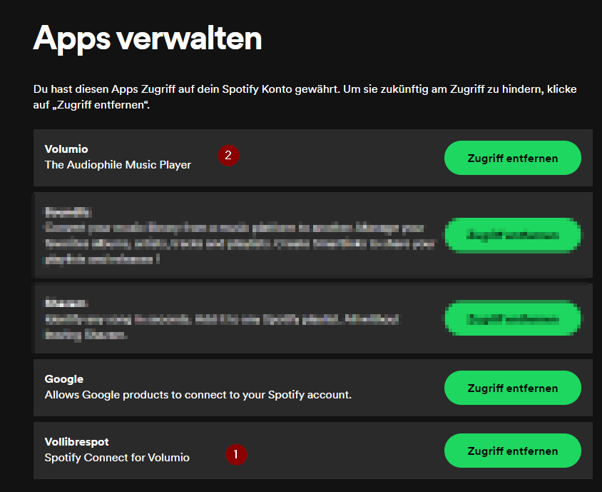

In Spotify User Setup (Not Volumio Setup) I ask if I can kill now the old connection 1 “Vollibrespot” as the 2 “Volumio” connection has apeared new since reconnection to the new plugin.
Yes you can remove the connection to vollibrespot.
Will bring the username back in the future ![]()
