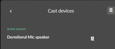

I have an Chromecast audio which is seen by volumio but music is not heard in speakers when I select it .
http://logs.volumio.org/volumio/zUf0Pnx.html.
When I select and deselect the Chromecast I hear a beep sound in the speaker
PS1 : Now it is playing but Is playing when appear as disabled ,
PS2: At some point the cast is disconnected and I need to enable it again…

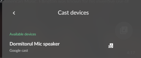

after enabling and disabling cast -music ok

Music is not heard in the speakers . In Google home app if I click on Chromecast Audio configured speakers I see "Volumio on default media receiver
