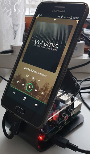

But I also have a totally useless Windows tablet and have tried both SD and USB boot with minimal support from the hardware , then I decided to use a Rpi as as a backend and use a Windows browser in the Tablet as a frontend, and then the magic appeared ! I can make some use of the Tablet !, first as a Volumio controller and secondary a news reader, very handy at the kitchen table !

You can use any device that’s network connected and with a browser to control the Volumio player
I mainly use Windows computers but in builds I somtimes use leftover Android mobiles as controllers
