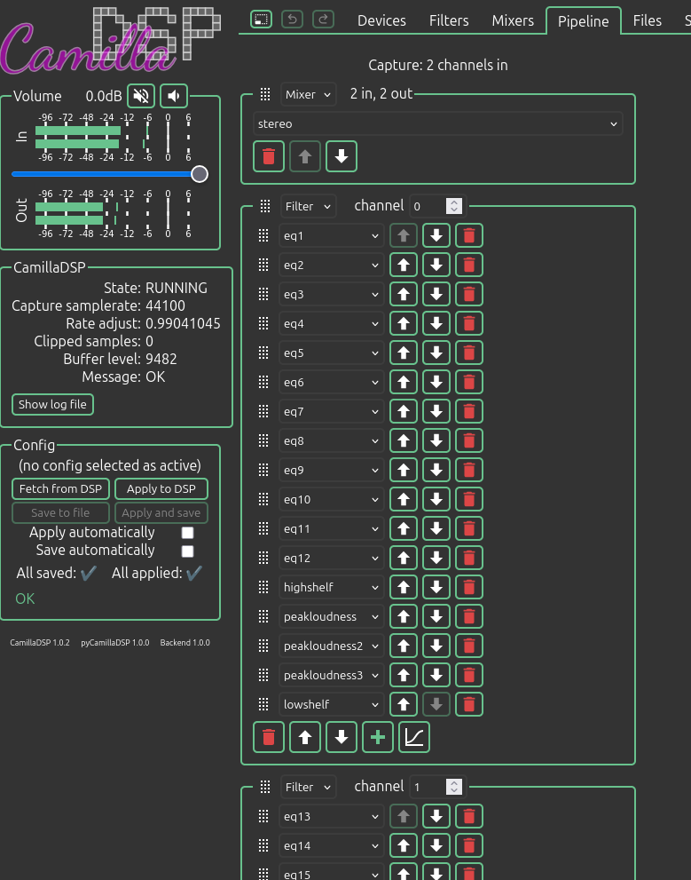

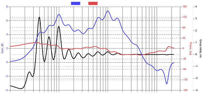

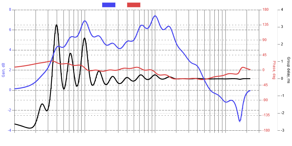

You can see it in FusionDsp by opening a new tab in your web browser with this URL
YOUR_DEVICE_IP:5011
Then while playing press ‘fetch from Dsp’
and in pipeline tab press the small curve at bottom
You’ll get something like

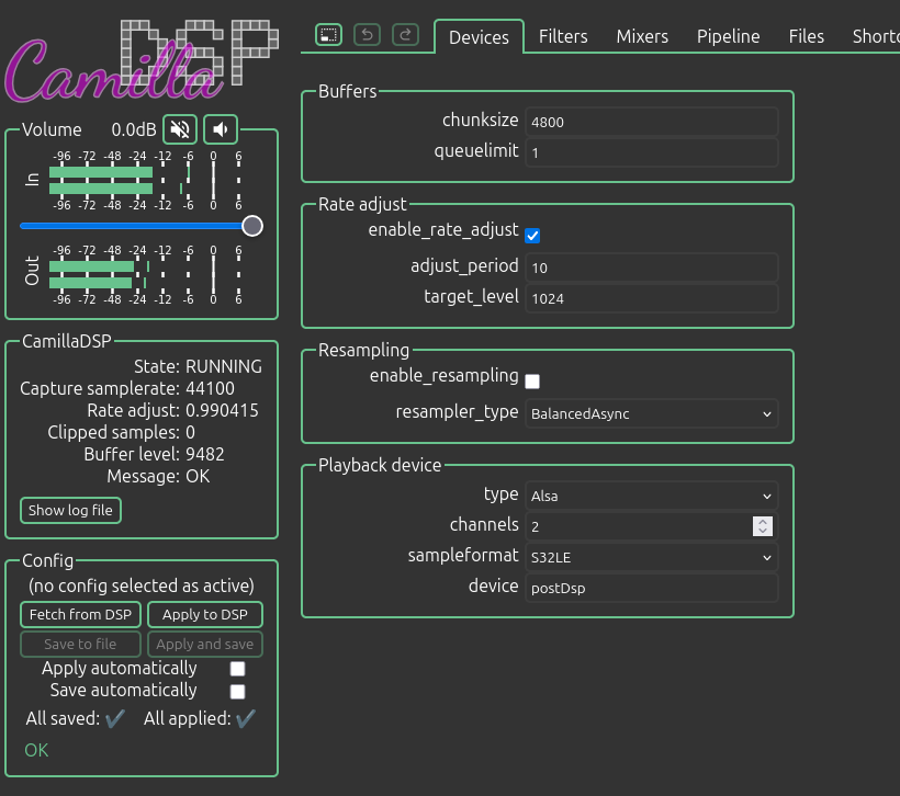

I have a work around for myself to get the soundfield I like. I use first the 15 band Eq. Add crossfeed from Jan Beier. Then fetch everything to camilla and fine tuning it there. I have now settings I like for headphone as wel for the speakers (same setting). And I saved everything in Camilla and put this as default eq.
