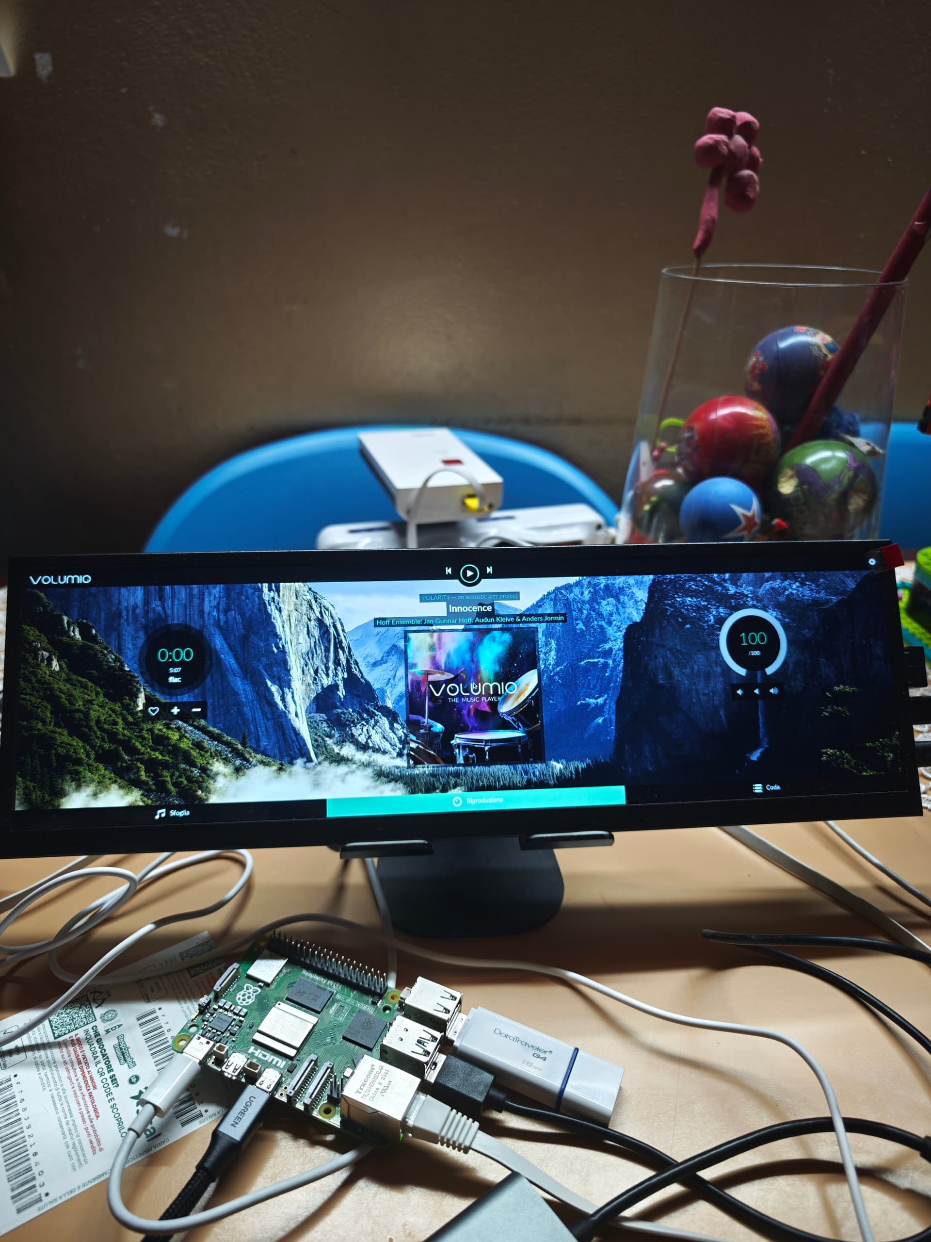

hi,I’m new here and I have the same Vsdisplay of you with some issue.
I hope you can help me,
1-rspi 5
2-correct image aspect (2560 x 720)
3-no touch
4-no peppy meter (tried with peppymeter and putty and peppy meter basic plugin)
note:touch screen is ok with win10 and only one usb C cable
thank in advance

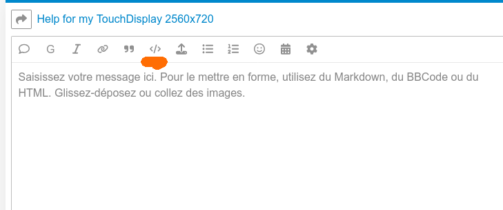

please,how to do “use code tag”?
After pasting the output of cat /var/log/Xorg.0.log into the box where you create posts the text should still be selected / highlighted. At this point format the text with code tags using the “</>” symbol shown at the top of the box.
use this icon
