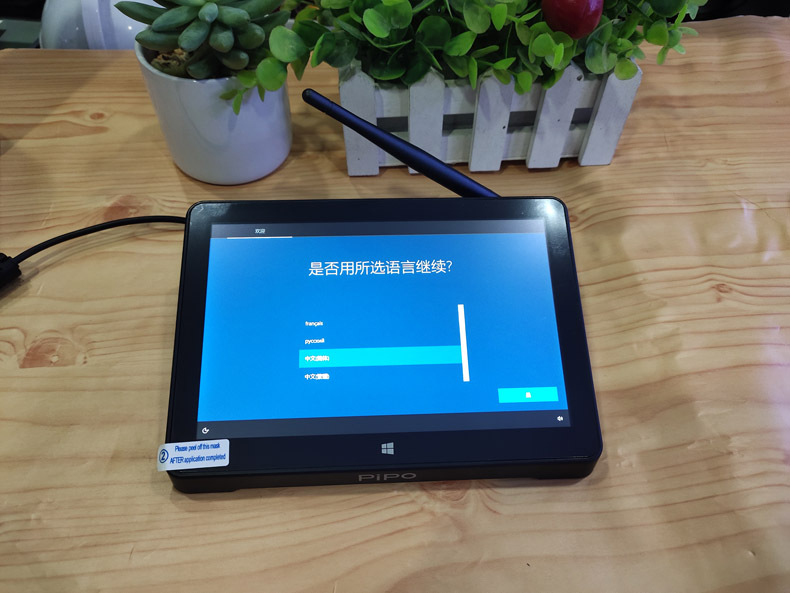

I have a 7" inch touchscreen mini pc, It looks attched
I fixed the problem as the the step in the upper.
but a strange things happens. the cursor on the screen is right. though the system looks good. it
accept the revers click. I discript as the following:
| touch screen |
| cursor here |
click happen
It’s sad that all blank are ignored. i mean that when i click the top-left of the screen. the system accept the click on the bottom-right of the screen. the most important is the cursor is on the right place(top-left).
