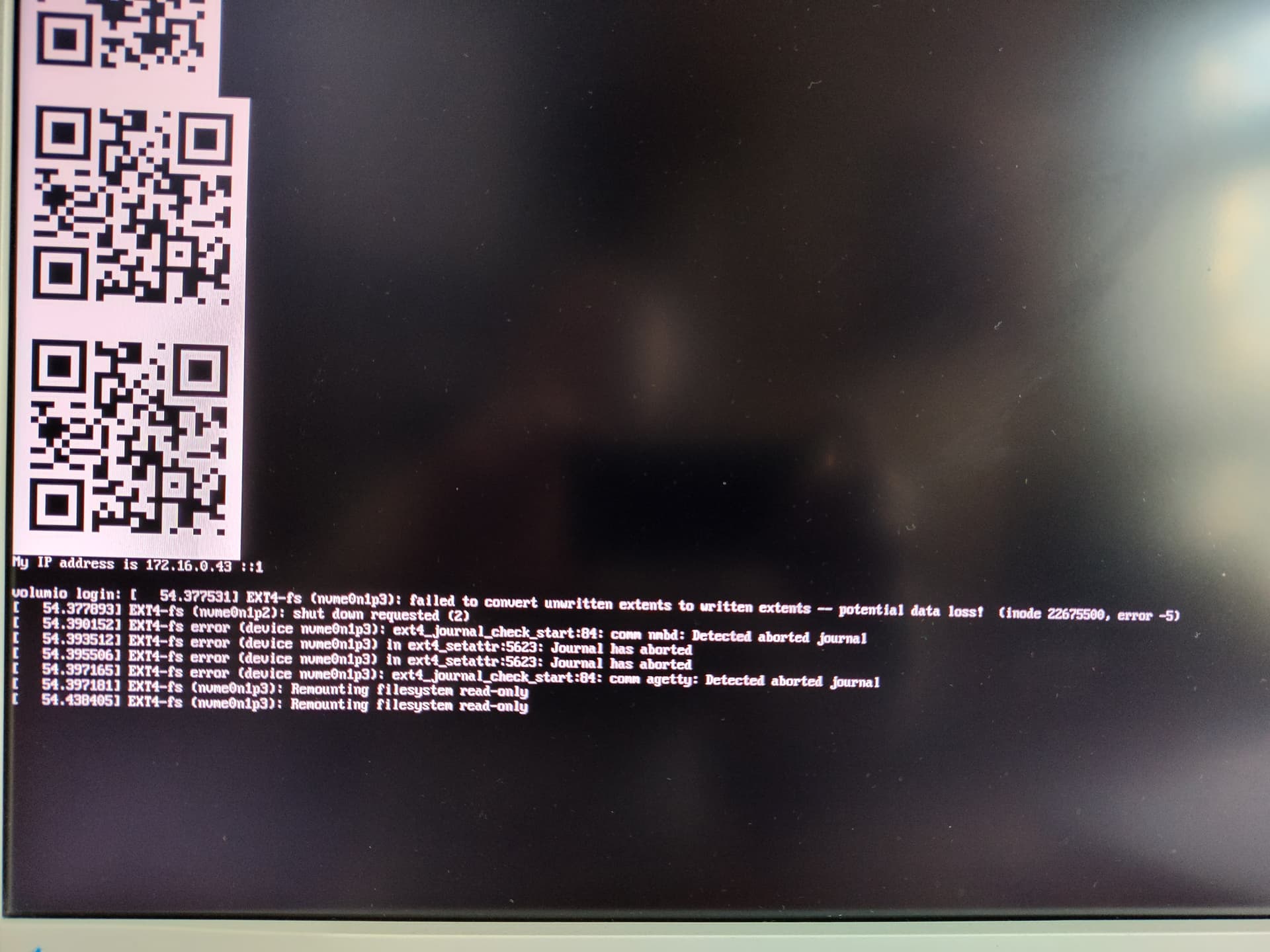

I executed your instructions unfortunately without success. Once booted, the system detects errors on the 512 GB partition and stops.

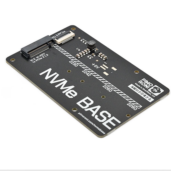

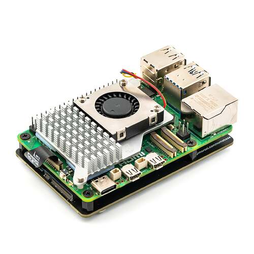

NVMe Base for Raspberry Pi 5 by [Pimoroni]

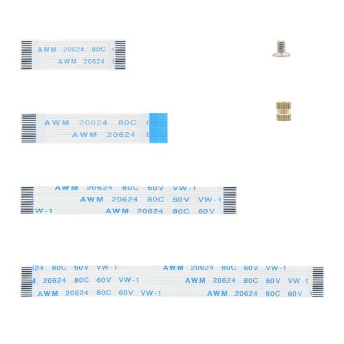

Ribbon cable (50 mm):

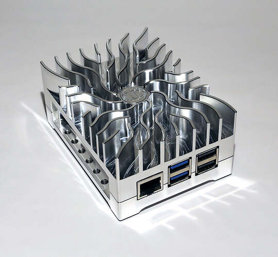

The longer cable is required because the PI 5 is mounted in the Galactic Case for the Raspberry Pi 5:
This shields the Pi from the audio parts in the chain.

Hey @davinci,
The shrink to 512GiB reproducing the same EXT4 cascade rules out partition size as the cause. So I went and did the arithmetic on the power budget end to end, and the picture this drive class on this carrier is showing us makes sense.
The numbers, from manufacturer specifications:
  • Crucial P3 4TB label: 3.3V at 2.5A, so up to 8.25W peak draw from the M.2 3.3V rail.
  • Pi 5 PCIe FFC connector specification (Raspberry Pi Ltd, PCIe Connector Standard document): pin 1 and pin 2 supply 5V, rated 500mA each, total 1A at 5V which is 5W maximum sourced into the carrier through the ribbon.
  • Pimoroni NVMe Base: passive carrier. It has a 3.3V buck converter on board that feeds the M.2 slot, and that converter is fed by the 5W FFC input only. There is no auxiliary power input on the Base.
So the upper bound on what the Base can deliver to the M.2 slot is roughly 4.5W after conversion losses. The drive’s declared peak is 8.25W. The carrier cannot meet the drive’s peak draw. Not marginally - by roughly a factor of two on bursts.
This is consistent with what we are seeing. At idle the drive draws perhaps half a watt and everything is fine. As soon as the kernel and Volumio init hit the disk with real I/O - especially on a QLC drive doing first-boot SLC-cache promotion and journal replay - the drive’s controller demands its peak budget, the FFC cannot supply it, the rail collapses momentarily, the controller resets, the kernel sees the resulting I/O errors, EXT4 aborts the journal and remounts read-only. Shrinking the partition does not change any of this - the drive’s electrical profile is the same regardless of how much of it is partitioned.

However, when I started to copy the music files from my NAS (backup) to the NVMe drive attached to the RPI 5 with the Pimoroni NVMe base, I had disconnections after a few minutes. And low voltage errors on the RPI 5, which proves your statement about the NVMe burst power consumption. Even when I soldered 5V leads to the power supply from the Pimoroni solder pads.
I ordered a Geekworm X1001 with a longer FFC cable (80 mm).
That combinations is now happily copying for several hours now without any hiccup.
