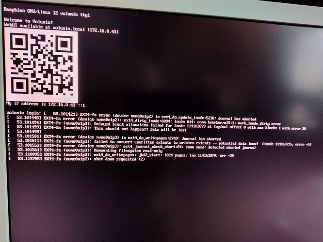

Once I rebooted from the NVMe drive, the process terminated with the QR code and I could connect to the web interface. But after a few minutes the system did a shutdown with several error codes on the RPI 5, see picture in attachment.

Thanks for the log link and the photograph. A few corrections and a request before we go further.
What the install log shows:
  • Install to disk completed cleanly. The installer wrote a GPT layout. p3 was sized at 3.6T to fill the drive.
  • A brief undervoltage event was logged during the install operation.
What the photograph shows:
  • The Plymouth/getty handover painted the welcome banner and QR code on tty1.
  • At about 53 seconds of uptime, EXT4 began aborting journals on both p2 and p3.
  • The data partition was remounted read-only and the system requested shutdown.
  • Errors -5 (EIO) and -30 (EROFS) on the screen are the filesystem reacting to I/O failures coming from below it, not corruption baked in at install time.
You wrote that you could connect to the WebUI for “a few minutes” before the shutdown. The kernel view shows the abort cascade beginning 53 seconds in, so the actual WebUI-reachable window was at most that, and likely shorter. The boot painted a banner that says “WebUI available at…” but painting that banner is not the same as the system having reached and stayed in a stable serving state. Worth being precise about, because it influences what we look at next.

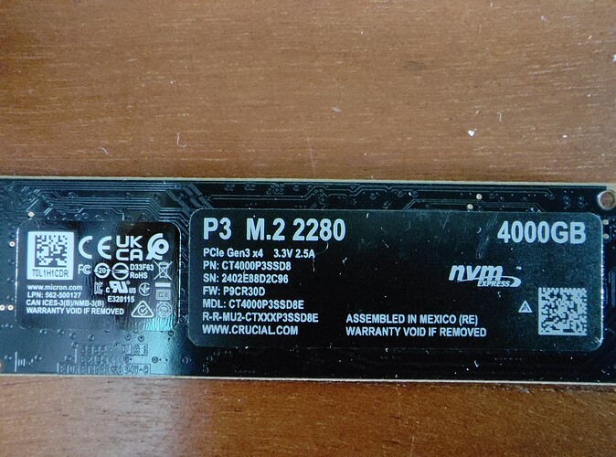

  1. The exact NVMe model. “Crucial P3 4TB” is ambiguous - there is the P3 (CT4000P3SSD8, Gen3, DRAM-less), the P3 Plus (CT4000P3PSSD8, Gen4, DRAM-less), the T500 (CT4000T500SSD8, Gen4, with DRAM) and others. Behaviour on Pi 5 differs significantly between these. Take a photograph of the drive’s label sticker showing the full part number and the firmware revision, and post it here.

The model of the Crucial P3 is CT4000P3SSD8E, firmware version is P9CR30D. According to Google no updates yet.
